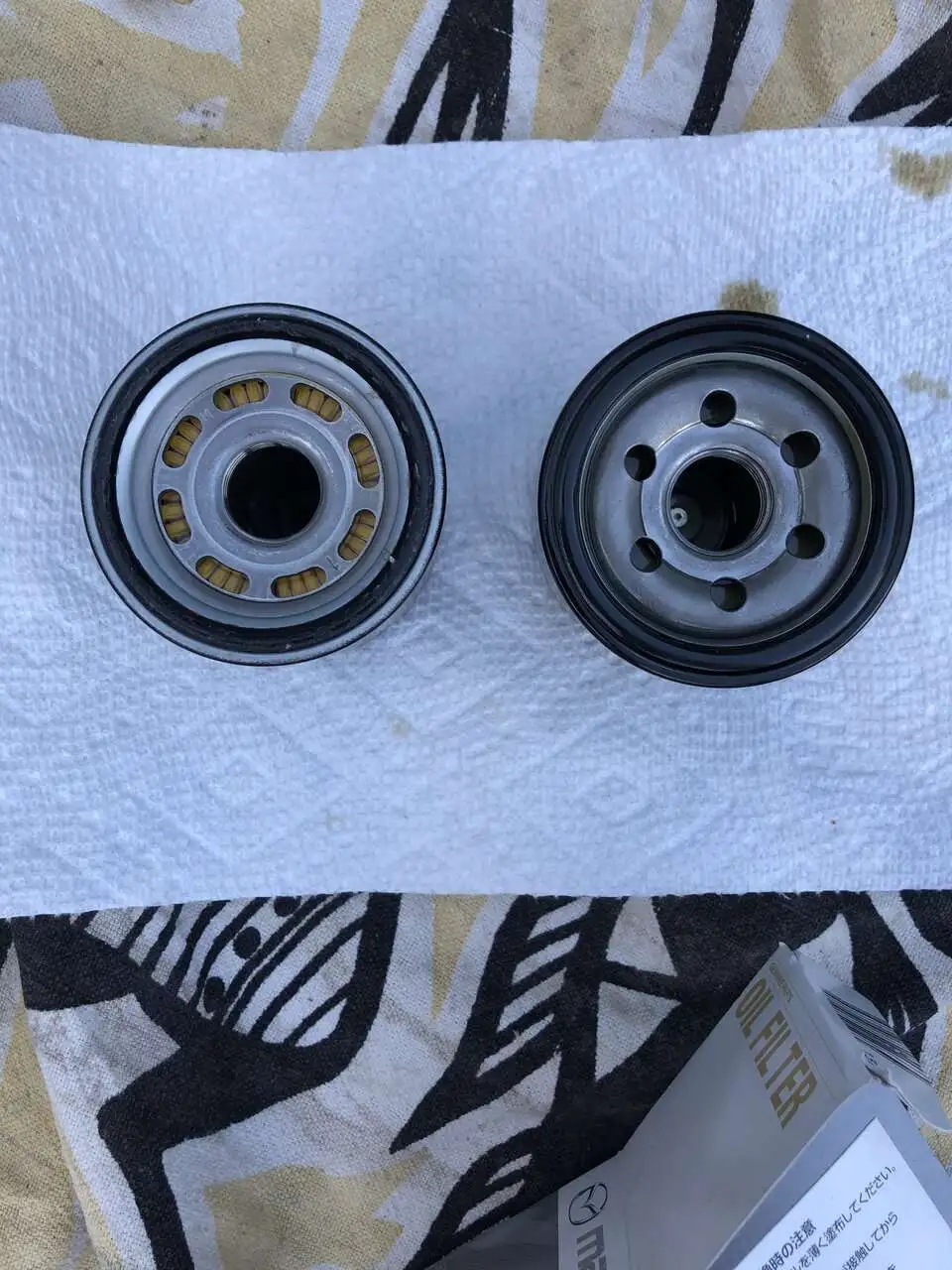

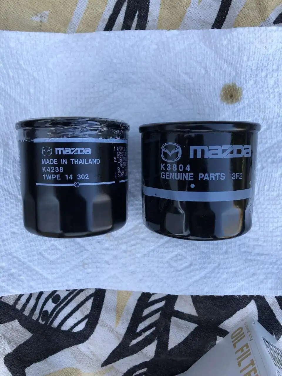

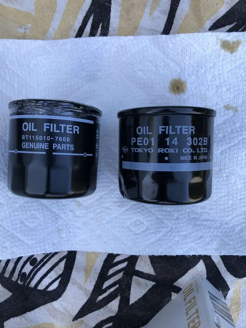

! Thats that - I am going to ask for suggestions on 5qt jugs of 5W30 for the next oil change - Im sure WalMart has sonething for under $35 - ? I took some pics of the factory Roki oil filter next to the OE dealer filter made in thailand - ( not value line ) the factory is slighly larger in circumfremce and the flow pathways are a different configuration- so be it -

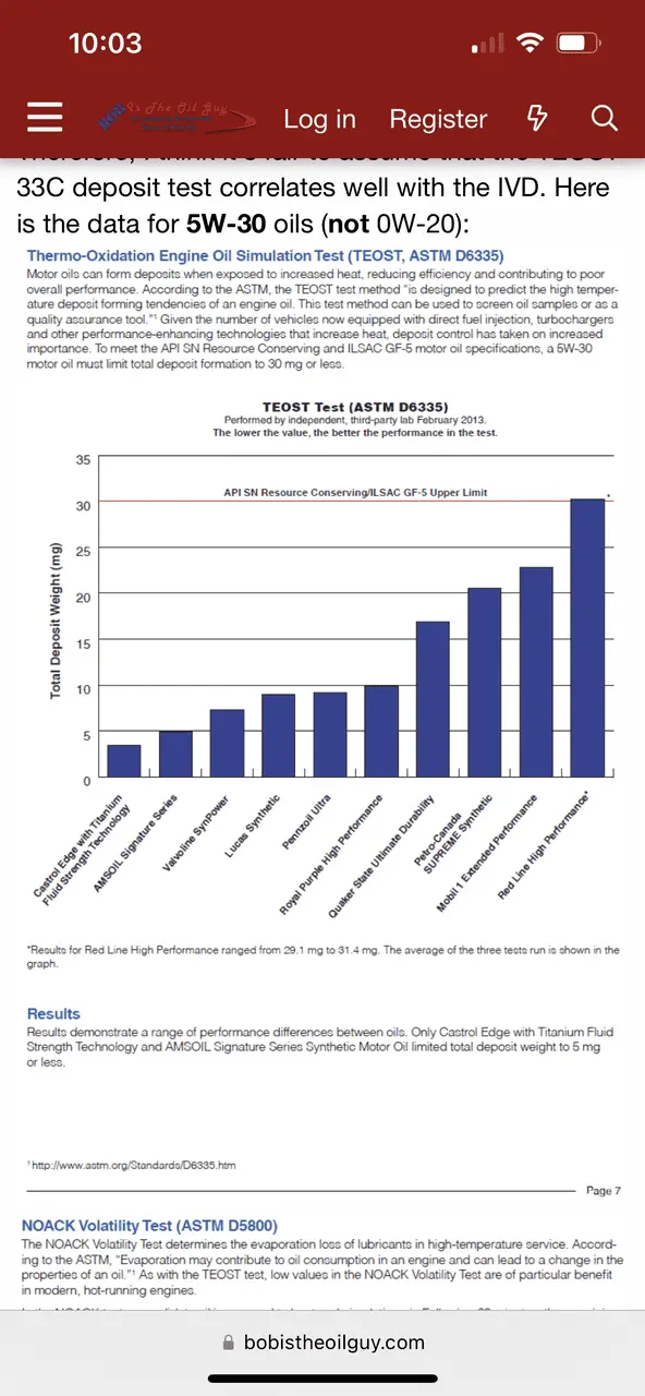

I’m going to use Castrol Edge (edit, accidentally called it GTX) 5w-30 for the first few oil changes on my ‘23 Turbo. They were offering a rebate for two 5 quart containers and it came through within 2 weeks. This oil had very impressive TEOST results (found on BITOG) and it meets the Mazda owners manual requirements.

Yes the factory oil filter on the 2.5L NA uses Tokyo Roki Japanese made PE01-14-302B oil filter but we can only get Denso Thai made 1WPE-14-302 in the US. You still can get Japanese Tokyo Roki oil filters from partsouq.com in UAE (also on eBay), and you can get it within a week like you order the parts from US online sellers.

I’m going to use Castrol GTX 5w-30 for the first few oil changes on my ‘23 Turbo. They were offering a rebate for two 5 quart containers and it came through within 2 weeks. This oil had very impressive TEOST results (found on BITOG) and it meets the Mazda owners manual requirements.View attachment 323288

You don’t have to use Mazda oil and oil filter to keep the warranty intact, although OEM oil filter (not the OEM “Value” MV oil filter) is highly recommended for high-flow rate. One-size-fit-all after-market oil filter simply can’t meet all specs like the OEM oil filter.

I did score a PE01-14-302B roki oil filter before finding the package deal.....is that the high flow oe you are referencing? If so I will use that one. Only found singles for $14 or 10 packs for more than $100. the one that came with oil is oe but not same part number and i think said made in thailand instead of japan.
