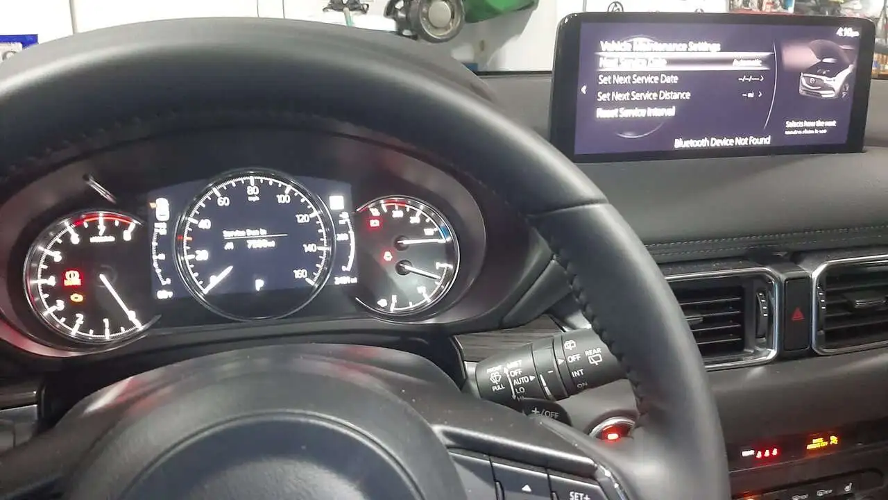

yeah mine was on but not started. the key was having service interval showing in gauge pod. that allowed me to access the vehicle status menu in information on infotainment screen. we have very different gauge pods. nothing in our "A" config pod is visble when car is off. all digital and no static markings with lots of config options for view.

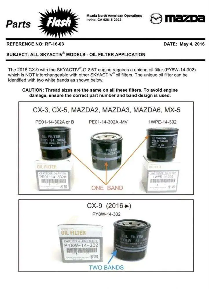

So where did you get Tokyo Roki PE01-14-302B oil filter installed at factory for the 2.5L NA? You can only get OEM Thai made Denso 1WPE-14-302 and Mexican made “Value Product” PE01-14-302A-MV at Mazda dealers in the US. And yes, Mazda dealers will use MV filter for your oil change unless you specifically ask for a Thai filter.
Also my experience. Ask at the parts counter for a filter and you'll get the value model. Ask specifically for this one for the turbo: 1WPY 14 302
The car will come with the Tokyo Roki filter from the factory but they don't sell it here. No big deal.

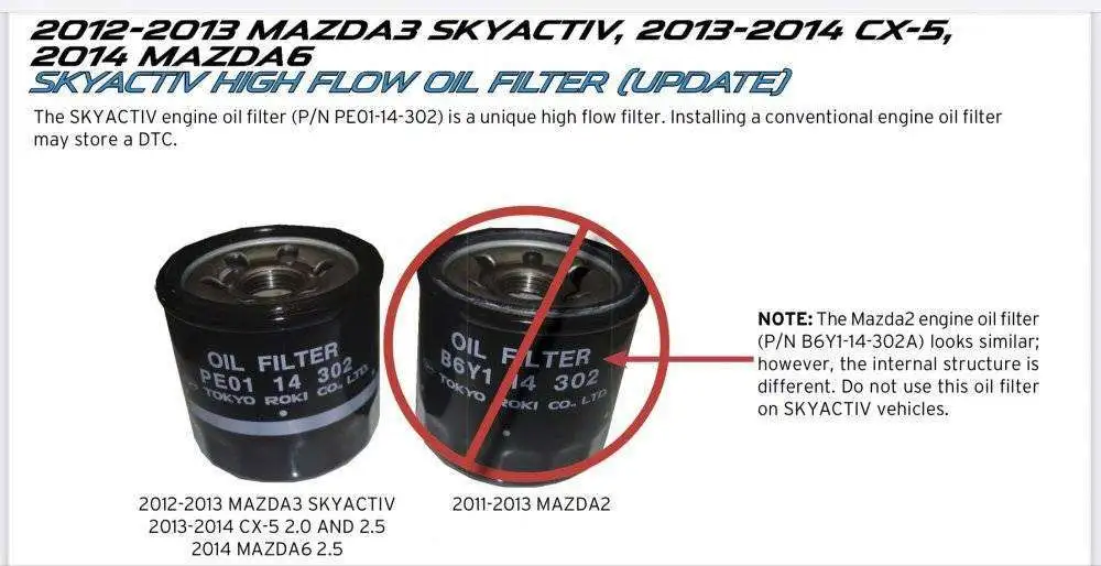

I read that the turbo filter IS different than the non-turbo filter, specifically in its bypass operation, but I don't know too much about specifics. If someone could tell me how much oil pressure we're supposed to be seeing on these engines I could possibly use a scanner to verify that I'm in range.

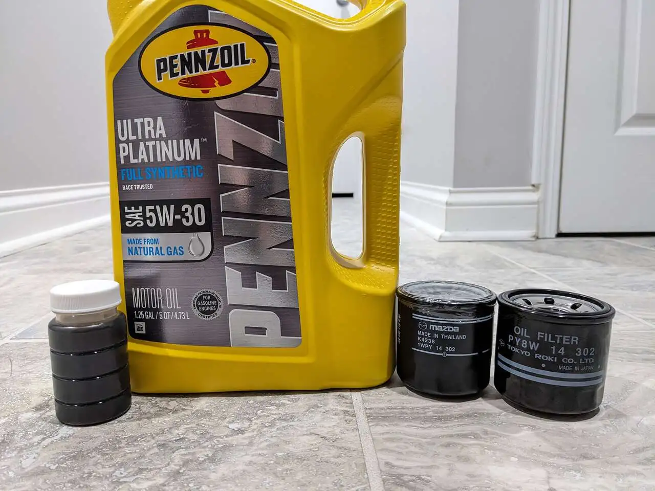

I wanted to come back and update this thread on what I found out about these filters.
Teardowns
As you can see, the only difference is when the bypass valve opens. But Mazda did that for a reason, so who am I to argue.

Alrighty then....figured it out......had to put gauge display on next service and then went into information on infotainment and the maintenance settings selection was lit where i could put next service date on automatic and reset service interval and now shows next service in 7500 miles.
None of this worked for me. The last one on the list remains inactive. Can anybody explain this?
Plus: Engine on? Ignition on? Acc on?
