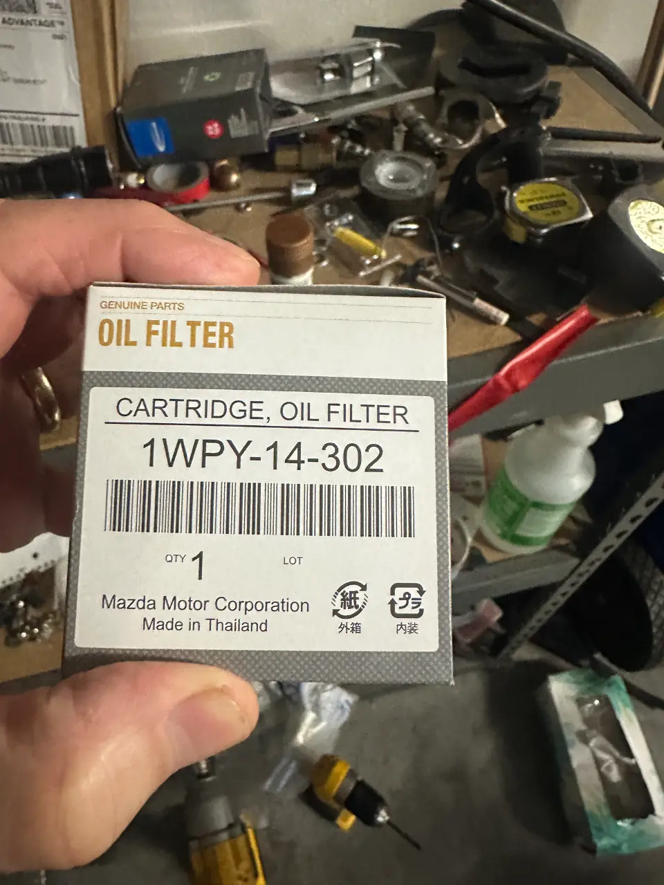

either the dealer or mazda swag. crazy thing is I got a $30 coupon from my local mazda dealer that claimed same as cash on it. I asked if I could use it on filters and the parts guy looked at it and said yes and brought out three 1wpy-14-302 filters. So my point is check your dealership or call to see what they charge. Prior to this time they wanted $19.95 for the same filter so I ordered 4 via mazda swag and emailed them and they sent a discounted shipping code. This is the filter your car came with from Japan.
You emailed Swag and inquired about ordering the WPY filters rather than what they have on their website? And they even gave you a discount on shipping?
