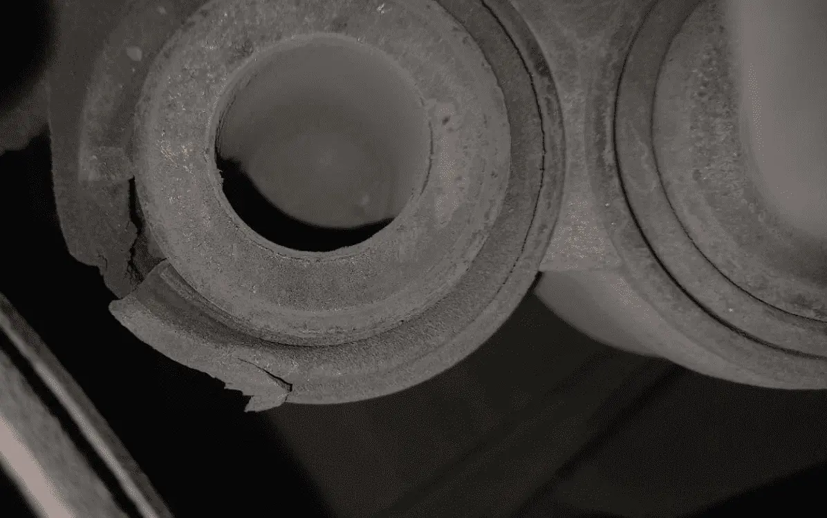

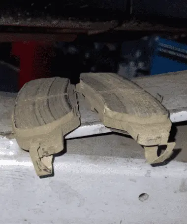

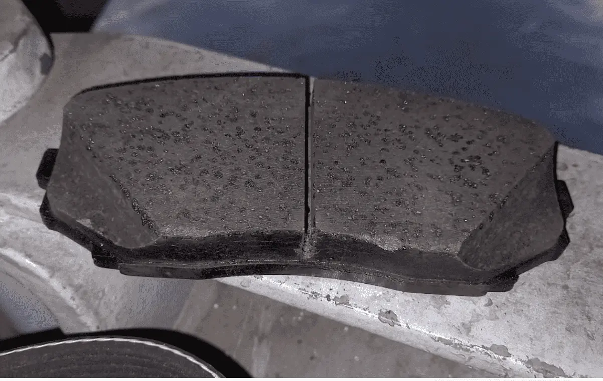

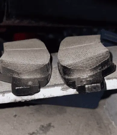

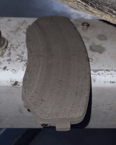

These are images the shop sent to me via WhatsApp while the car was being serviced. I don't know what the third one is. And I don't know if the images are adequate to show condition. On my next trip to the US I could buy pads at a Mazda dealer or maybe aftermarket to see if they're better but there's a catch 22. It is illegal to bring in auto parts (some protectionist thing). That said inspection has been quite lax on may last couple of trips so there's a good chance I could get them in. To recap, my daily decent is about eight and a half miles from about 6,900 ft down to 3,300 ft. Three full sets of pads have been replaced plus the rears an additional time. At 18,400 miles the front disks were scored and replaced. About 3.7 miles daily are over rough dirt road.
The oil leak I'm still not clear on. My mechanical Spanish leaves much to be desired but I'm going to nail it down on Monday and I'll post a follow up. There is no oil leaking on my parking area. The brake pad replacements have occurred at the regular service intervals, not the result of any problem I noted. The last four vehicles I've owned here, Suzuki 4x4 Vitara, Mazda 4x4 pickup, Nissan 4x4 Frontier (pads changed at 25,000 miles) and Renault 4x4 Duster (pads changed at 37,000 miles) all had only front disc brakes.

From a thickness standpoint, those pads look like they have plenty of life left especially as seen in the second picture, less so in the first. Did they give you the thickness measurement on the pads? If not, why not? Did you report a problem with the brakes--vibration, pulsating, squealing, whatnot, especially when you descend your mountain? If not, I'm having a hard time seeing why you need a brake job.

Those pads are absolutely FINE with PLENTY of meat on the bone, almost brand new thickness. They are not glazed and the surface can be lightly sanded with 2000 grit paper and placed back in the caliper for service. The light straiations are a characteristic of the material of all brake pads and unless there are deep groves that cant be sanded out, they will function perfectly and properly. Pads do conform to rotors and if your rotors dont have any deep grooves in them but rather light circles on the surface and are not glazed over and have never been cut before, then they are also perfectly fine and serviceable with a little fine grit sandpaper to smooth out any fine lines. You only need to do that if you are replacing the pads with brand new ones so that the pads don't conform to the grooves or high and low spots already on the rotor and ruin them.
In this instance with the pictures you have posted you are absolutely scammed on any brake pad job that they told you you needed.

I agree he's getting scammed. really doubt those are pics of OPs pads.
But if they are, the only pads that look normal wear to me are the 4th pic and the right pad on the 1st pic.
Of course I either turn or replace my rotors every brake job so my pads look like the 4th pic.
The 1st pic is fuzzy but the left pad of 1st pic has some scoring / gouging. The 2nd pic has multiple grooves and the 5th pic looks to me like someone dumped acid on in it or a substandard pad that is falling apart. I think they're scamming him with pics from other cars.

Third pic looks like a broken caliper body around the piston.
Pads have what looks like 80% or better thickness remaining.
That last pad picture looks like metal embedded in the pad. Also, the "arc" of the rotor wear looks opposite of the arc of the pad (as if it were somehow installed upside down). I dunno how that would be possible.
You could ask the shop why they want to replace the pads? It can't be for thickness. If that 3rd pic is indeed a caliper on your car, I would think it would need replaced.

I've been trying to figure out these pictures. The 'caliper' picture looks like a dual piston caliper which to my knowledge the CX-5 doesn't have, only single piston caliper. The brake pad with the opposite 'arc' you refer to looks like a basically new pad with the 'arcs' being from the grinding the surface smooth in manufacturing. The imbedded metal particles look normal as I've seen this many times in the past in brake pads (brass looking usually).

#1-- worn pads with plenty of material remaining
#2 --new pads
#3-- caliper that doesn't belong on a CX-5 and has a torn piston dust boot
#4 -- worn pad with plenty of material remaining
#5 -- new pad

... The 'caliper' picture looks like a dual piston caliper which to my knowledge the CX-5 doesn't have, only single piston caliper. ...
The 2.5 turbo and 2.2 diesel have dual piston calipers up front.
