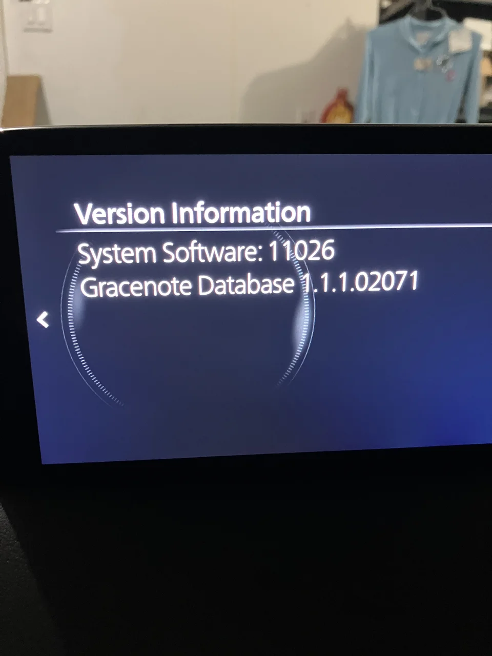

My system firmware doesn’t have all these digits. It’s a North American 2021 CX-5 Here is a pic of the display. Please advise.
Thank you so much! Is there any thumb drive restrictions? Size, brand, etc…? Other than FAT 32 format?
The instructions from other firmware versions mention it's recommended to get the USB drive from a reputable brand, between 16-32GB.
The firmware file should be the only file on the drive.
Also, for some reason, only 1 of my car's 2 USB port picked up the firmware from the USB drive. I suggest you try both ports if it didn't work the first time.
I have a 21 CX-5 too. Same firmware version as yours before update.

You will need a USB Drive, formated FAT 32. Save the firmware on to the USB drive and follow the instructions. It will take around 20 mins. Good luck.

Thank you @Candurin and @newnewnew. I did the update to my CX-5 today and it worked flawlessly. Really appreciate this, my local Mazda dealer are ridiculous with their labor rates to do things like this. They tried to charge me $499 to sell and program a new fob. I found one on eBay for $70 and found a scan tool to do the programming for much less.
