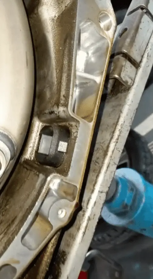

Here is a still from a video they just sent me. They said the seepage is from a point about in the middle of the image.
Do I think they would go as far as to drop some oil on it and fake a video...probably not but ya never know.
Do I think it might be leaking from elsewhere? Yes, possibly.
Get a second opinion from another shop and have them show you the leak while the car is on a lift. That picture doesn't show much in my estimation. Be there in person and see for yourself. Maybe have them show you the brakes as well.

Wish I could tell for sure how bad this leak is based on photos. If it were my car and not covered by warranty, it’s something I’d clean up and monitor to be sure of the source and how bad the leak is.
