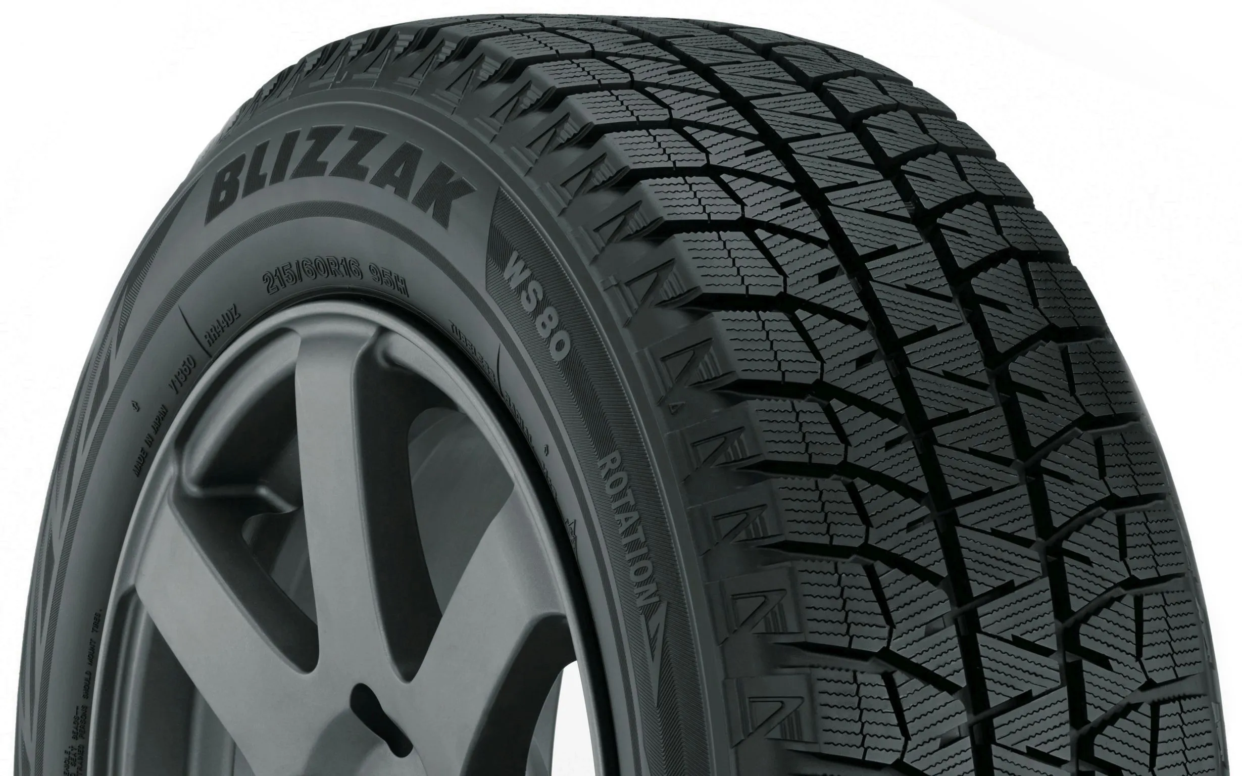

I have run Michelins X-ice in the past and decided to go with the Bridgestone Blizzak WS-80's on my CXS-5. A great choice!!!

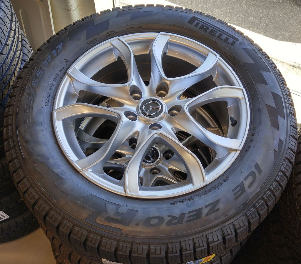

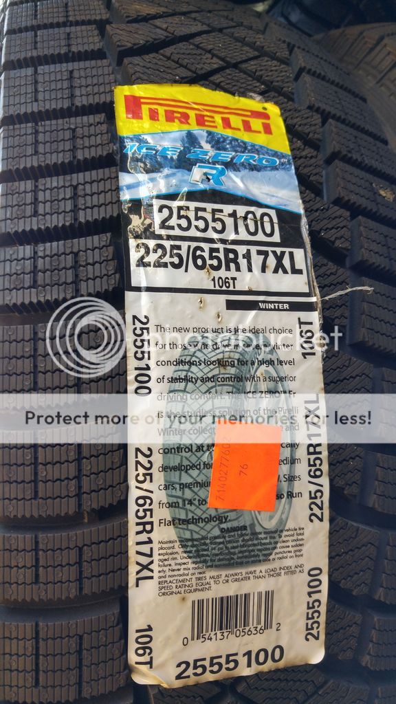

Anyone have any experience or advice with Pirelli Ice Zero FR rubber in the winter?
While out pricing Mazda steelies for later winter tire shopping for our new 2016.5 CX-5 FWD, a Mazda dealer offered me a pretty decent price on a package of 17" Mazda M003 wheels and these Pirellis.
Pirelli has always had good winter tires. If you are getting a good deal, go with it.
Funny, if you go to Tire Rack they say this tire isn't available in that size, but there's a picture right here plain as day in that size! Looks good, lots of siping.
Those rims are nice!

Now I can sit back and wait for the fall rebate promotions to come around on the winter tires and do some more research on the many choices. The Pirellis are maybe still on the contender list along with the WS80 Bridgestone Blizzaks and Nokian Hakka R2 SUVs.

...Now I can sit back and wait for the fall rebate promotions to come around on the winter tires and do some more research on the many choices. The Pirellis are maybe still on the contender list along with the WS80 Bridgestone Blizzaks and Nokian Hakka R2 SUVs...
Now being led towards instead pulling the trigger on a set of Bridgestone Blizzak DM-V2. May do this very soon during the current Bridgestone $70 rebate.
