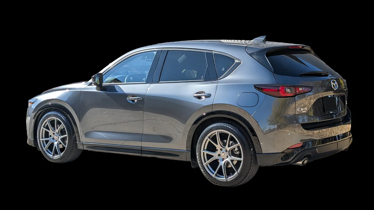

They would have been a little lighter but these are already 6.5 lbs lighter than stock so the change in steering lightness was huge. But yeah, it would have given me more tire. But I could only afford one set and nothing beats how killer this thing looks and handles compared to every other CX-5 on the road. It brings me happiness looking at it.
are those 20's
I would have went for a size or two smaller, but looks good. I like that you didn't go for dark wheels.
I'm seeing more than 10lb decrease in weight per wheel, going from OEM 17x7.5 to the fast fc04 wheels i showed you in another thread (17x8).
if you really want to save a bit of extra unsprung mass and improve ride quality, big flashy wheels obviously won't do that lol.
