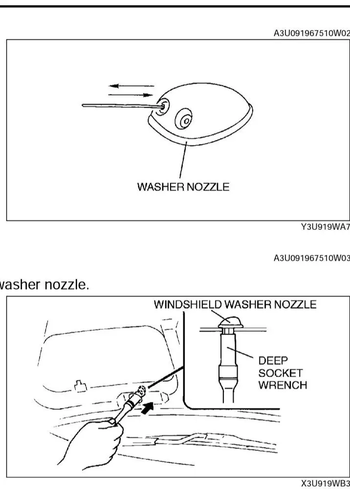

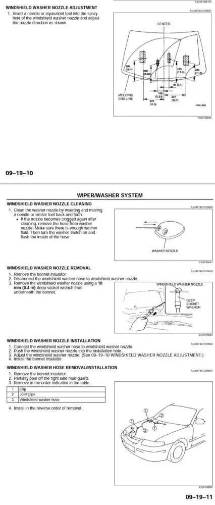

You can adjust the aim of your spray by sticking a needle in the nozzles and moving them.

I tried that on my spectra that I traded for this one, I ended up worse off than before. 😂
Yeah, it was a PITA.
It's really touchy.
It would either spray over the windshield or straight into the wiper blade with the wipers parked.
It took my about ½ an hour to finally get it spraying half decently.

I will try and aim them, gonna raid the ladys storage bin and find that needle I used last time. Thanks for that diagram pcb! I prob wouldn't have thought about using a deep end socket to get the tabs pushed down.

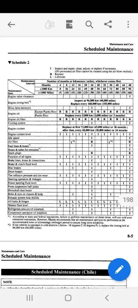

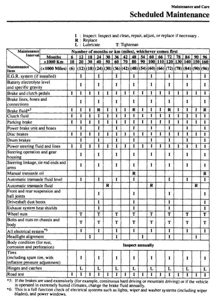

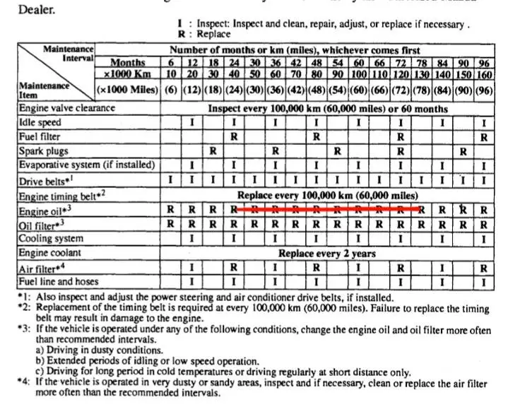

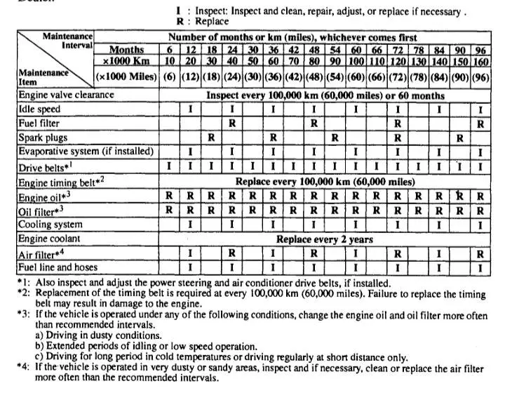

Getting awefuly close to 300,000km on the daily Sport20, pulling together a few items for a big service. At the moment it's getting new fluids and filters all round, a cambelt and water pump, new sway bar links and I need to check that rear engine mount. What else should I check/ replace?
Here's a list of things to consider inspecting or replacing.
Don't forget your fuel filter,..

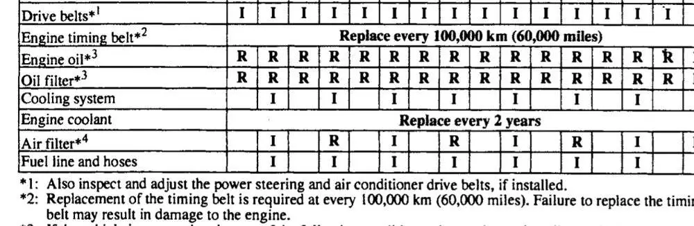

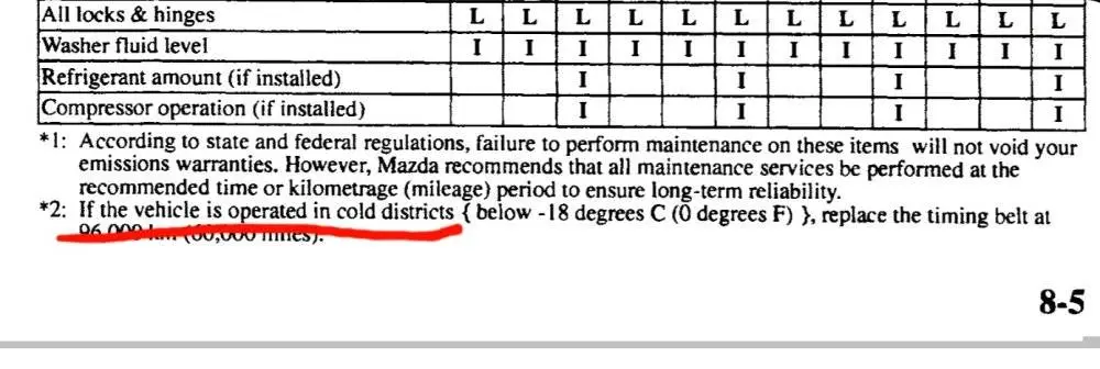

Is 60k miles the recommended timing belt replacement interval for the FS-DE?
If it's not cold where you are but you like to rev the living snot out of your car then changing your T-belt every 100k km is a good idea.
However, people have gone over 200-250 thousand Miles on the original timing belt, and clutch too.
