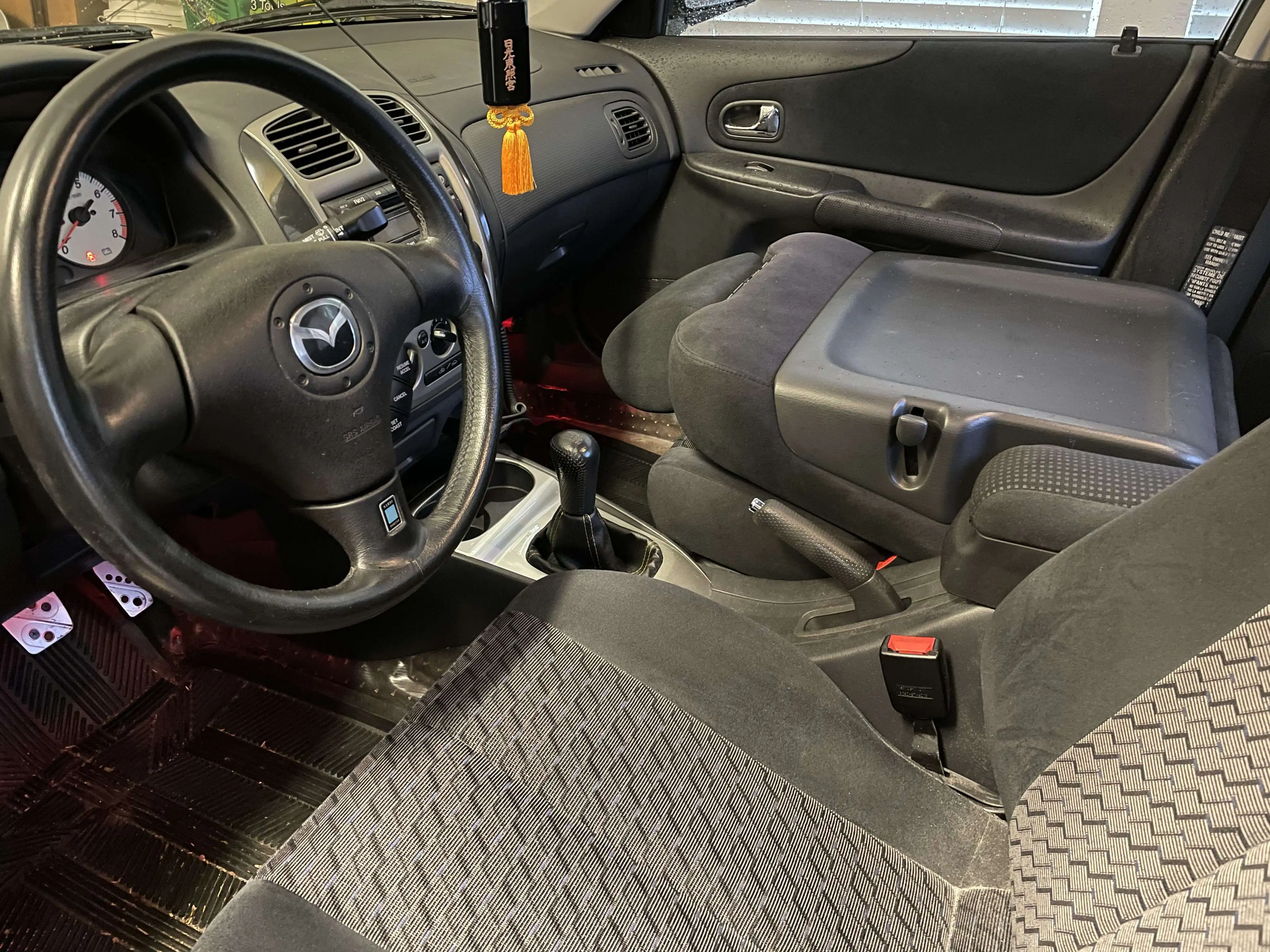

Finally gotten around to installing the EDM fold flat passenger seat I got from Germany weeks ago.
It started raining as I was putting it in, then the hail came after I pulled the car back in the garage. The struggle is real!

That is cool. I like how the seat is cut out to go around the raised arm rest console. Mine has different fabric on the lid. Where is yours from?

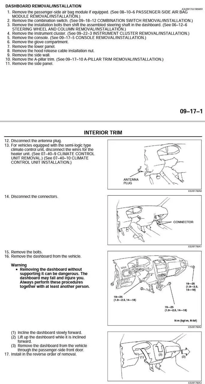

Took a pic of the rice box lol. planning on the dash removal to fix the firewall leak that seems to come and go. We got an absolute DOWNPOUR the day before this pic and there was not a drop of water in the RH floor. other times it's over a cup of water 🤔

that's what I am thinking about but dash removal isn't unfamiliar to me. Did it on my expedition for a heater core then was back in it again on a F-150 for his heater core. Prob gonna take a week off work and use that as a chance to clean the whole interior 😂 carpet up to the headliner full detail, gobs of seam sealer where I can put it, then re assemble.

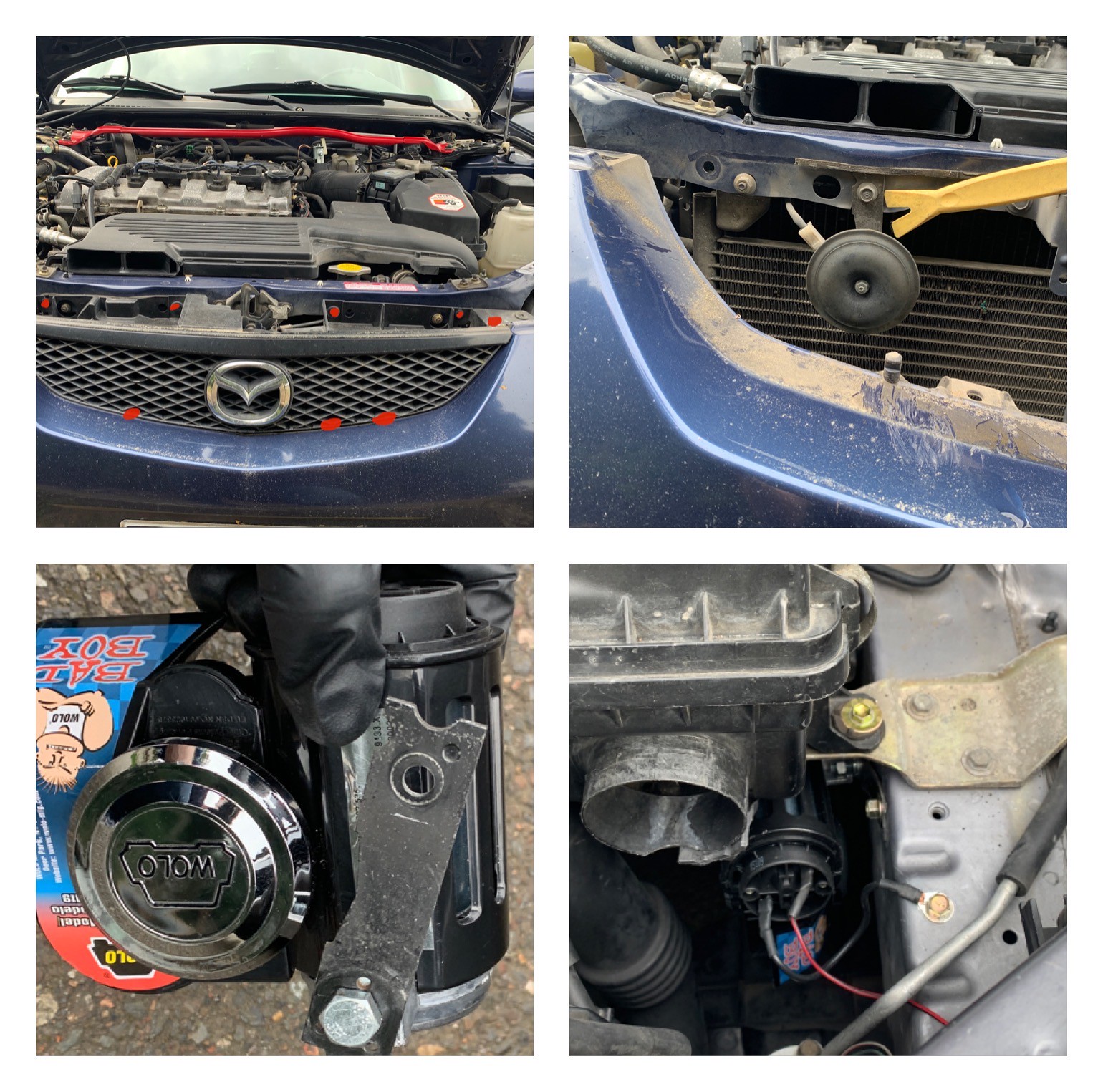

I'm more than a little excited for this air horn installation. I absolutely HATE the stock Protege horns and with a pair of Proteges, it made sense to get two horns. I'm embarassed to admit that I've purchased probably 5 sets of the classic Hella air trumpet horns in the last 30yrs of playing with VWs and Mazdas and in EVERY situation, they wear out and stop working. But I finally found a simple solution - the Wolo compact air horn. Most YT videos show this being installed on motorcycles.
https://www.amazon.com (commissions earned)
Here's a YT of how it sounds - Wolo bad Boy air horn
It turns out the space in front of the core support is pretty damn tight, so I put this in the engine bay under the airbox and figured out how to re-use the stock horn mount and an existing threaded hole.
Wolo compact air horn by Diamond _Dave, on Flickr
The only thing I needed to do was create a 12" ground wire and lengthen the horn trigger wire by about 36". The upper Left corner picture shows red dots where you need to use a lever to pry the grill for removal. Technically the install was on my MSP, but the P5 gets it next. I didn't use the relay this time.
HIGHLY recommend this horn. Really love the sound.
