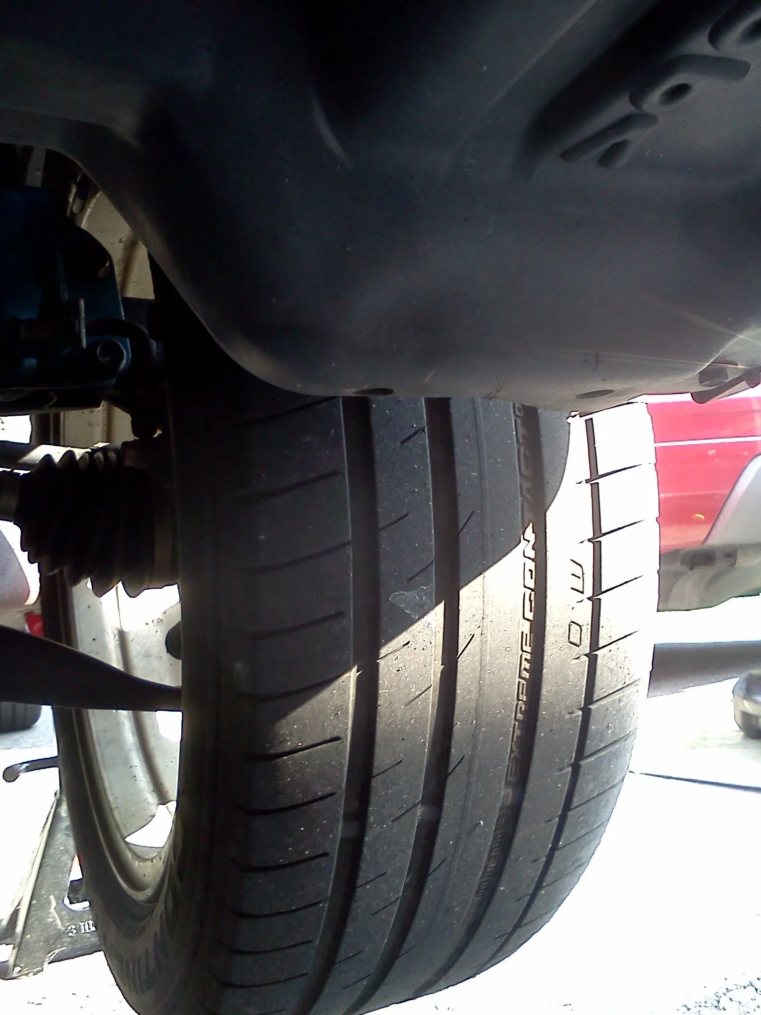

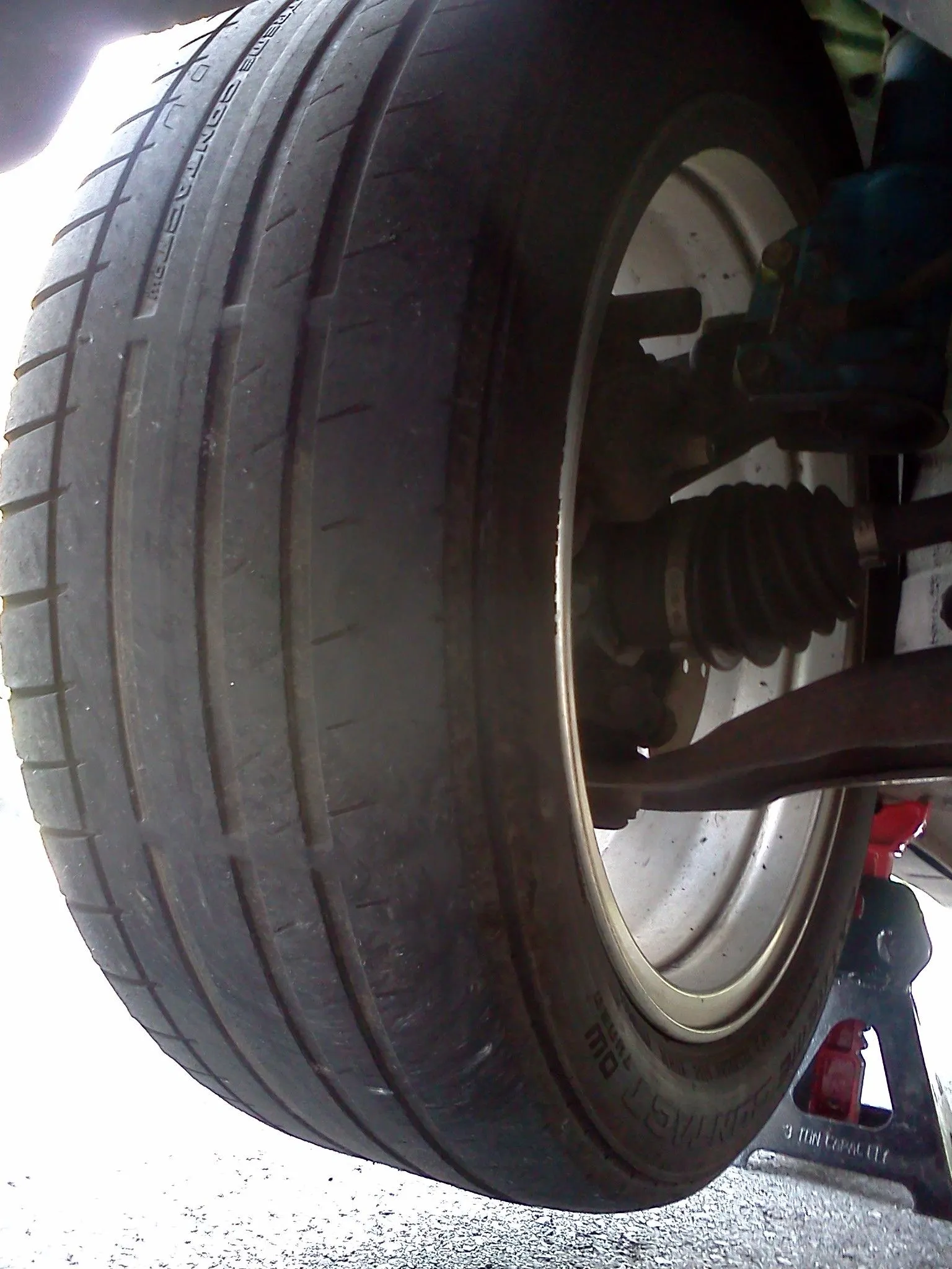

Over the weekend I changed the oil and while under the car noticed that the PS front tire is wearing on the inside, so much so that it's at the treadwear indicators while the DS looks good all the way across. So looks like my camber is out of whack and need to get it in for an alignment. Thinking the alignment issue is from a worn component which has been the cause of my clunk... Still haven't figured out what it is and it's driving me nuts.

And because I know that everyone likes pics....
attachment.php
attachment.php
Alignment. You needz it, Jeff. Shame too, aren't those tires new-ish?
She goes in Saturday for the alignment which was last done within factory specs back in April when I put the summer shoes on. The unusual noises started approx. two months ago and my mechanic wasn't able to find anything wrong, suspension wise??? Tires are just over two years old, installed them back in the fall of 2010 just after lowering the car. IIRC I put around 4K miles on them between lowering the car and swapping them out for the winter shoes. Plus a full season in 2011 and now 2012....off the top of my head, I'd guess I have around 18K miles on them. Will have to check my records when I get home.
Have you been able to go through everything with an impact wrench? Tightening all your suspension bolts and double checking everything is tight?
Only reason I ask is because after getting the Milly aligned there was a very slight clunk and it turns out the shop didn't tighten my camber bolts in the front. Something may have just gradually come loose over the years.
No, I haven't done that nor did I think to... Don't have an impact wrench though but worth getting her back in the air to do a once over.
