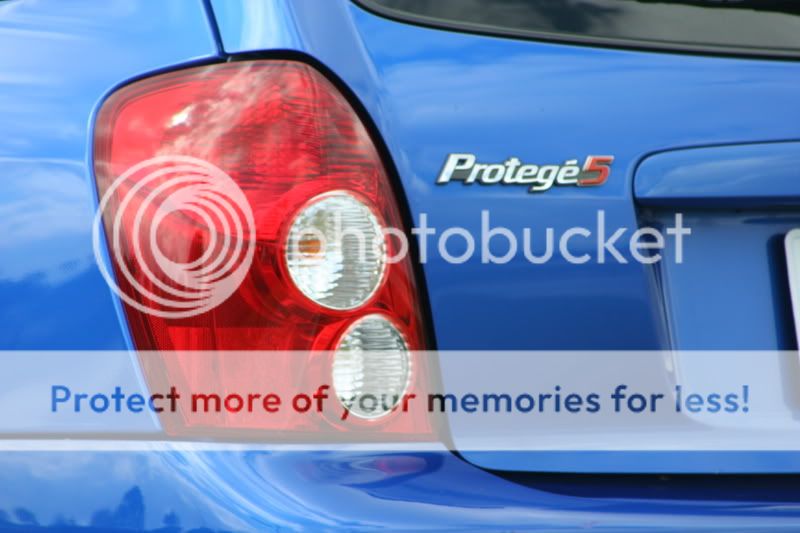

Also had the idea of an LED mod to the tail lights
The Retrofit Source offers halo LED rings. . .
Thinking on installing 3 sets
1 red in the turn signal
1 red in the reverse light
1 white in the reverse light
So, i'd have the normal parking lamps halogen, but when the brakes are applied, you'd get the halogen as well as 2 LED rings in red
Then in the reverse, the white LED ring would come on with the halgoen
So all 3 have halogen bulbs, then turn and reverse have an added LED halo. applying brakes causes the brake bulb to light both filaments, and the halos in the turn and reverse would come on. That was be awesome. I would consider using the halo in the turn signal to flash when turning before having a backup halo. It would be great if you could have the halos sequential when turning
All 3 would still be halogens
Brakes: halogen as well as red LED rings in both the turn signal and reverse (all lighting up under braking)
Turn signal: Halogen (with mentioned red LED only lighting up with brakes)
Reverse: Halogen (with mentioned red LED only lighting up with brakes-possibly adding a white LED ring to assist the halogen on reverse as well)
