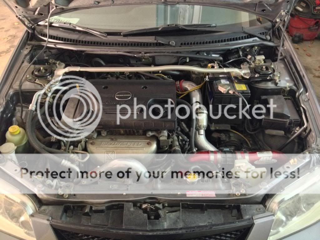

Everything is staged and ready to go for the R&I of the engine that I plan to do Sunday. I'll get the engine out tomorrow night, then disassemble and reassemble Sunday and reinstall. I can't wait to have it back on the road!!!

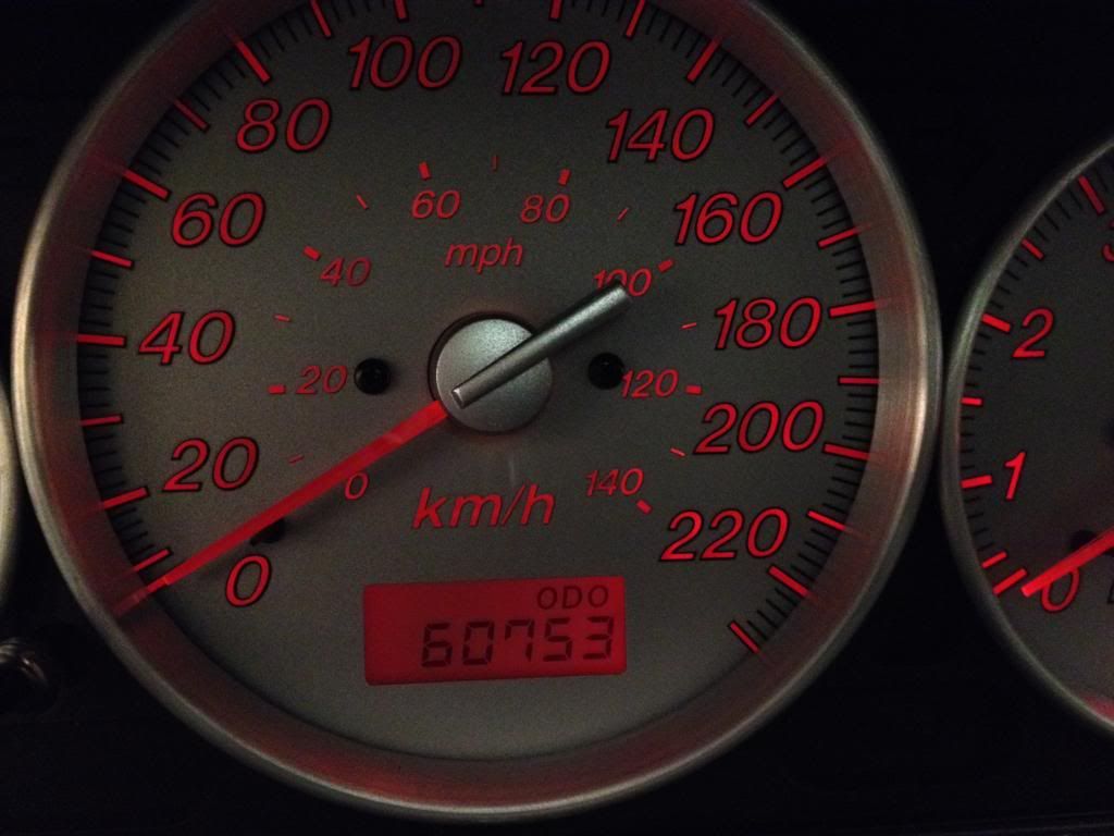

Just picked up a second MSP with 60K kilometers!! Has a few mods and needs a new front air dam, but otherwise in mint condition! Might have some parts for sale soon :)
