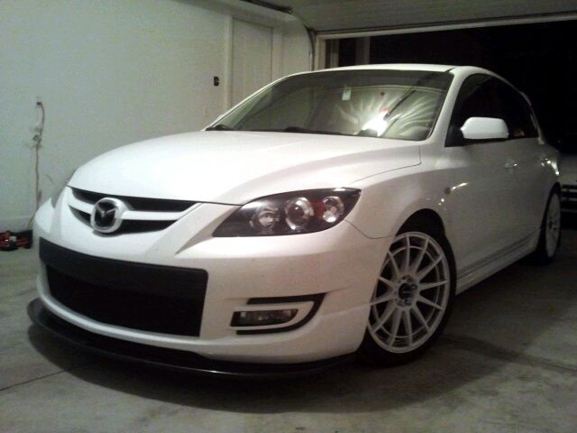

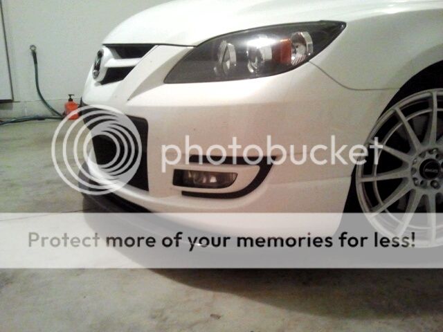

Oh herro DG splitter! Sorry for the bad pics and filthy car.

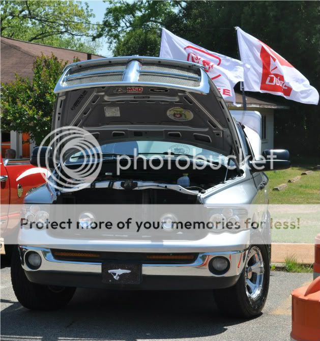

Let it sit in the driveway while I drove the big guy to a car show in Plains, GA. Great time again this year.
