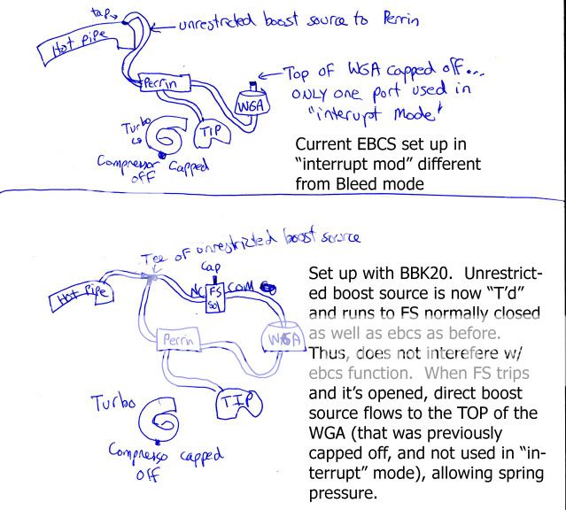

I finally got around to swapping out my broken Perrin ebcs for the new one that is plug n' play today, as my CPE hpfp is FINALLY en route. I'm glad I went through the trouble of mounting the Perrin in the factory location, because I'm going to mount the meth failsafe bcs on one of the bolts on the firewall, where most people mount their ebcs (mount it in stock location... it fits, and looks better imo). With the factory location, you don't have to worrying about insulating against the constant "tick tick ticking" of the solenoid opening and closing. I don't have to worry about it w/ the fail safe bcs, because it will only tick once if it opens, lol. It's pretty cool... if there is any meth flow problem, instead of just tripping a led, it also opens a direct boost source to the top of the wg, so it limits boost to spring pressure immediately. Unlike an LED that you could miss, you def won't miss that, haha. I'm also having a toggle switch installed. I'm gonna just cart my AP around with me so if the FS trips, and I hit spring pressure, I can pull over, turn off the FS bcs (via toggle, thus allowing normal boost), and flash my non-meth map. Here's a schematic of what interrupt mode looks like, and below shows the FS bcs added into the mix. This is for the FS-10. The FS-30 works in reverse, and it was causing a lot of confusion between me and a buddy w/ the FS-30, so I drew the Picasso below:
^BTW you don't need an aftermarket ebcs in 'interrupt' mode to run a FS bcs with meth... you can run one w/ the factory bleed set up if you like.

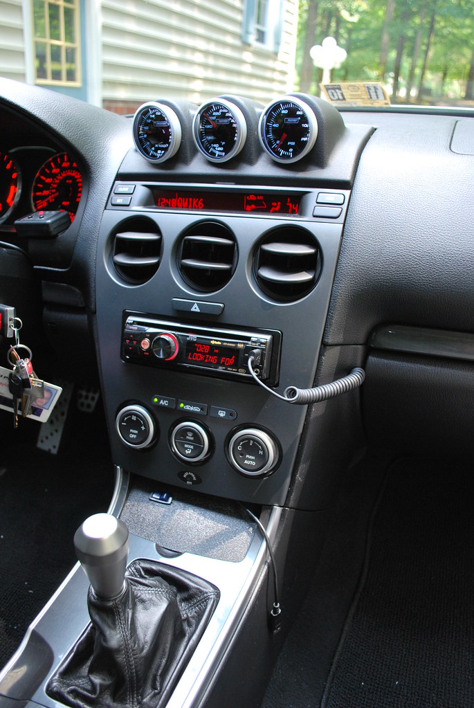

Finished up my stereo install today. :D
Nice. That's weird that they make you put your inspection sticker in the middle of your windshield... never seen that before. Why did you change the factory head unit?
not bad qwik!! Does the metra kit have a double-din also? Just wish it came in the brushed aluminum look like our other trim pieces... vinyl time! :)
did you manage to figure out the non-working interior lights issue?
Because it sucked. I had jl audio door speakers. 600 watt amp. and then a 2000watt amp and 15" sub. It just didnt sound too good with the factory head unit. The volume couldnt get but so high. Changed it out to this and its a night and day difference. I say that volume 20 on this is as high as 30 was on the stocker. Not to mention this one goes up to 50. I cant crank it up that high as I start to go def around 30. It also sounds a lout cleaner. I no longer hear any power drawing accessories through the speakers.
There is no double din kit out there. But there are some people that have done custom setups. It wouldnt be that hard to do if you had some time on your hands. I do wish that the finish match the stock. But I am going to wrap all the center pieces in 3m's carbon fiber vinyl.
I have not gotten my interior lights to work yet. I did find out that my dimmer switch no longer works. I am not sure whats going on there. I blew 2 fuses yesterday. None are blown today.
