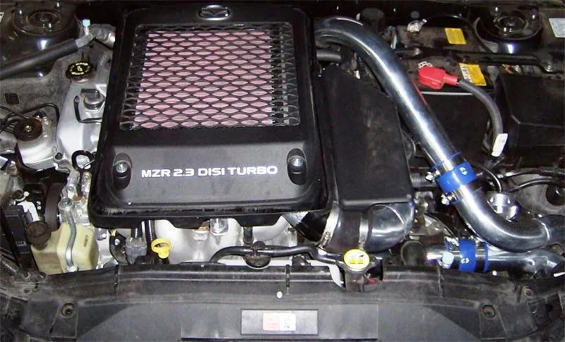

Install a new CorkSport front mounting intercooler kit, Autotech high pressure fuel pump upgrade and Cobb AccessPORT ECU Programmer stage 2
