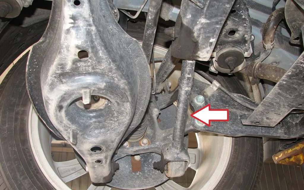

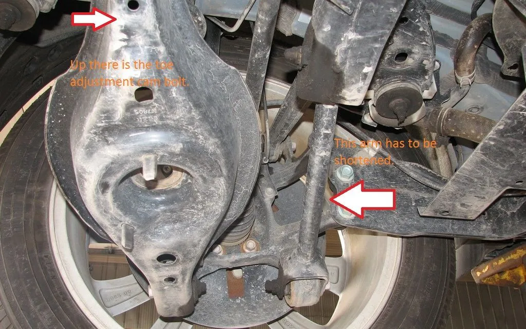

Assuming that's a direct replacement for the lateral link or "rear upper arm" as it's called on the diagram; are you converting the single arm something like this?
A picture helps much more then words.
By shortening this arm and adjusting the rear toe cam bolt, the bottom of the wheel, will go inward.

Here is another picture, with some explanation.
Basically, the bottom of the wheels, has to be pulled in.
With the camber arm, the wheel has to be pushed out.

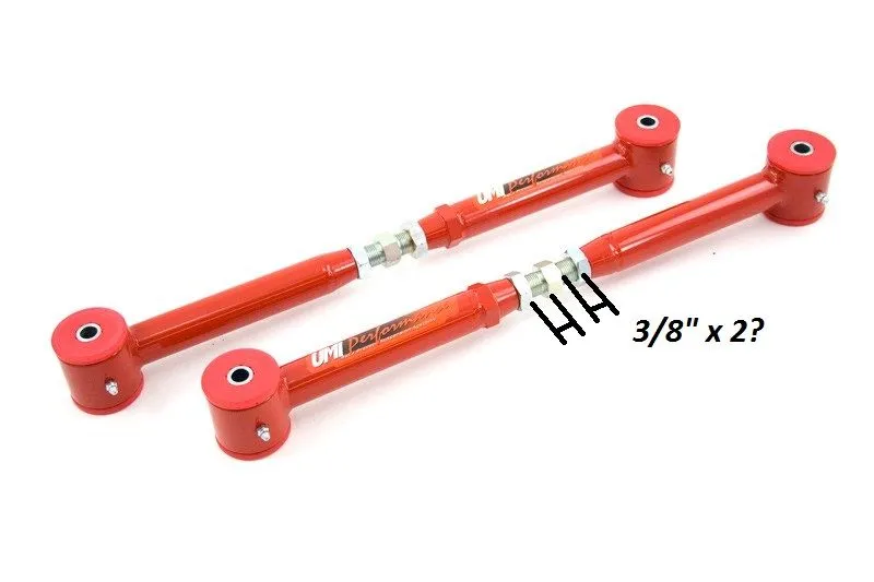

I'm wondering, how much space should I leave, for adjustment for these lateral arms? The adjusting "bolt" is only 4" long and the hex and two nuts should take up 1.5", per the manufacturer specs(I have not received them yet). 3/8", should be enough at each end(right thread and left thread), or should I leave 1/2"? I will have to shorten these arms, not extend, since these are at the bottom.

This is, what I have asked, if it wasn't clear enough:
