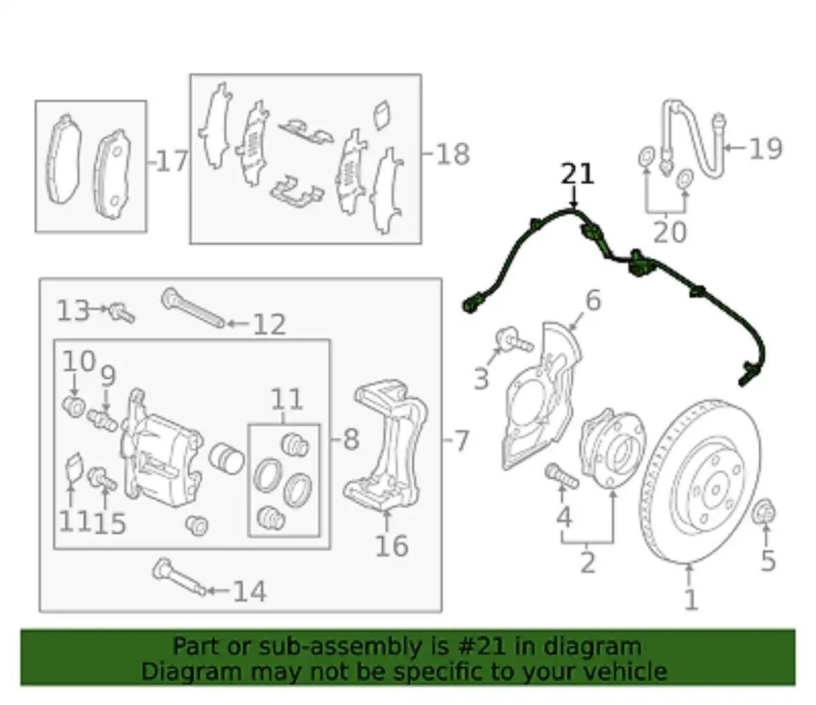

So just an update… F the stealership… they wanted 200 for a diagnostic scan. Went to my local mechanic, threw the car on the scanner and ordered a $65 front driver side speed sensor. 10 codes for One sensor. Live and learn.

Also just want to verify, the “front driver side speed sensor” seems to be the ABS speed sensor located at the driver side front wheel, but P0500 CEL, Vehicle Speed Sensor Malfunction, you’re getting indicates the different speed sensor used by the speedometer is malfunctioning. Has the shop replaced the ABS speed sensor and the warning lights are all gone?

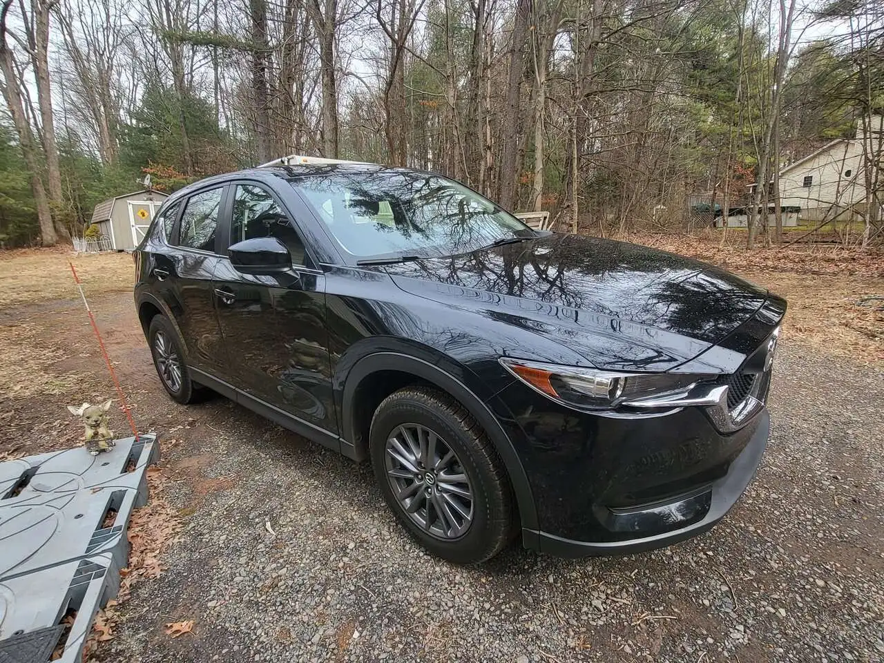

Took my black on black 2018 CX-5 Sport "Speedracer" to the Mazda dealer today for check-up since I just purchased it last Wednesday with only 31K miles on it. First time Mazda owner so I figured best to make sure all is well with it. Had a few OBD codes showing via my bluetooth OBDII scanner which they checked and were benign. Owned a '17 Jeep Cherokee Trailhawk prior but it was totaled in a rear-end collision. Body shop wanted $17K to fix and Allstate decided "NO WAY" and I don't blame them. They paid it off and gave me the balance which I used most of as a down payment on the Speedracer. So far am very pleased with the pep this little rocket has. Let's see how long this lasts me before someone decides to ruin my ride again.

This is the first time that I've heard of the CX being described as a rocket...
Glad to hear that you and Speedracer are getting along so well together.

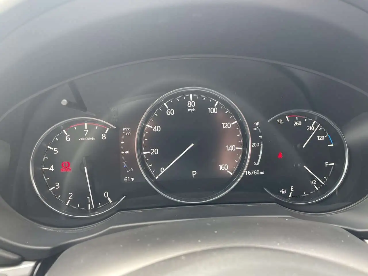

All clear boys! Back in business. I reset the MPG before this photo, don’t mind that 😂

Just a sensor! Swapped it, cleared the codes (P0500) and were running great.
By 'a sensor', are you saying the wheel speed sensor eliminated the code? If so, are you sure that code wasn't a C0500 instead of a P0500?
Yes, I ran the code myself… it was the front driver side speed sensor…
“A P0500 code is a diagnostic trouble code (DTC) titled “Vehicle Speed Sensor (VSS) Malfunction.” This code is triggered when the vehicle's Powertrain Control Module (PCM) or Engine Control Module (ECM) detects inaccurate speed readings or lack of a signal from the Vehicle Speed Sensor (VSS).”
Ok, then this will remain a mystery to me, but in any case, glad to read the problem with your vehicle is resolved.

I call it "Speedracer" because the design (at least to me it does) reminds me of the cartoon of the same name that I used to watch many moons ago....
“A code is a diagnostic trouble code (DTC) titled “Vehicle Speed Sensor (VSS) Malfunction.” This code is triggered when the vehicle's Powertrain Control Module (PCM) or Engine Control Module (ECM) detects inaccurate speed readings or lack of a signal from the Vehicle Speed Sensor (VSS).”
I agree with edmaz that the vehicle speed sensor (VSS) mentioned by P0500 is located at the output shaft of the transmission. The VSS is NOT the “front driver side speed sensor” which is used by ABS and TCS, and there’re 4 of them located at each wheel. How the P0500 code can pinpoint to the LF speed sensor but not any other 3 is a mystery to me too!
From what I’ve read. The ke had the sensor directly on the trans the kf moved it to the hub… experts correct me if I’m wrong
Oh I'm familiar with Speedracer. I can hear that theme song in my head right at this moment. I hope that it doesn't stay there too long though. I tend to do that, get a tune stuck in my head.
The design of the CX reminds you of the Speedracer car?
If you say so. ;)
If you say so. ;)
Yeah I know it's not true to the image since the nose is 3-pointed on the original Speedracer but the sleekness of the CX-5 nose is what brings back the memories....to go back to the early 60's....sigh.....
