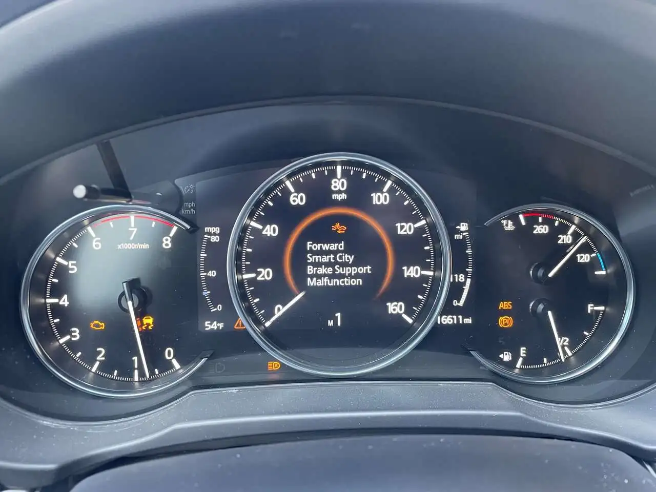

Got in my car today and had a total of 8 errors, including a check engine light. Ran a scan tool and had no error codes and was able to erase the SES light but still have the following lights flashing… 2019 gt-reserve…. Only 16k miles… any ideas?

Was getting 8 system malfunctions last week including Smart city brake support and smart brake system malfunction. Spoke to the dealership and they leaned toward needing a new battery. Tested the battery and it was constant at 11.5v when vehicle was off and 13.5 when running.
Swapped it out for a new battery and it’s holding 13.5v off. Only issue is all the lights are on still and now include a check engine light for P0500 Vehicle Speed Sensor Malfunction.
Running out of ideas and patience at this point. Dealer wants $199 to do a basic diagnosis and can’t guarantee to figure out the issue in the basic diagnosis.
Any ideas? Help needed. Thanks!

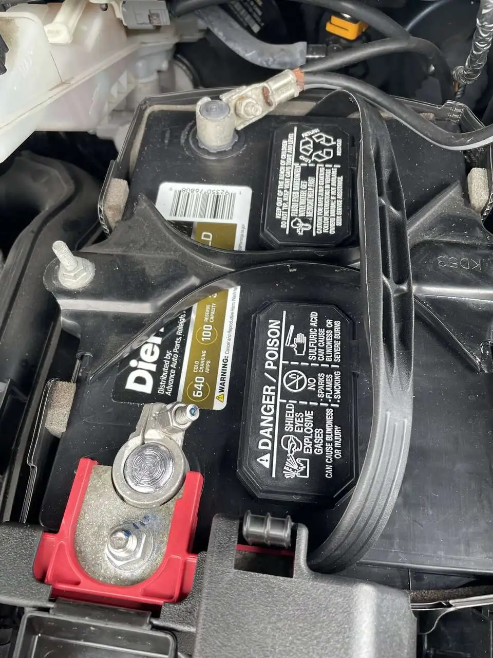

Check to make sure all battery connections are tight and secure and free of corrosion. Kind of a long shot, but maybe some rodents are munching on a wiring harness?
Either way, as a last resort, I would try taking it to an independent mechanic for diagnosis. They will likely do the exact same thing that the dealer tech would do, but at a much lower rate.
Brand new battery, and the terminals still looked brand new. I’ll double check them. Curious about the engine light now since the other malfunctions have been Around for over a week but the engine code is new.
