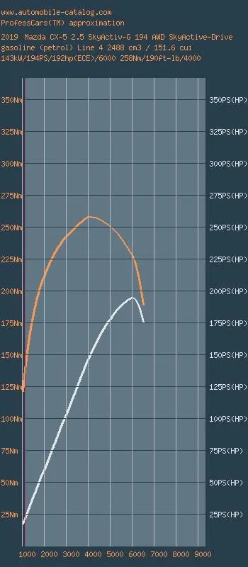

I found this for the 2.5 NA, but not sure how accurate this website is ( i hate it). The values were calculated, not measured. It assumes a gradual increase in torque to max torque, which i don’t think is the case in reality. Note the difference in units for torque value, conversion is required to compare.
You are right. I think what chris_top_her was refering too is the horsepower curb on the 2.5T graph. Meaning the torque curve of the 2.5NA has the same shape as the power curve of the 2.5T. A bit confusing i agree.
Thanks for finding a power / torque curve for 2.5L. The graph should be accurate other than using metric units. And the shape of the curves, power and torque, are very typical for a naturally aspirated engine.

thats right, but what i mean is that the torque curve is a lot more constant and flat on the k&n dyno than the first calculated one i provided. This could be due to the unit conversion, but it is more likely because the first one only use the peaks to generate a generic curve.
thats right, but what i mean is that the torque curve is a lot more constant and flat on the k&n dyno than the first calculated one i provided. This could be due to the unit conversion, but itbis more likely because the first one ob’y usethe peaks to generate a generic curve.
Yes, very likely. At least the peak values are matched to the RPM perfectly to the factory specs. And it’s for Euro model 2.5L which has a little different specs too.
The Euro RPM scale on torque curve starts from 1,000 to 9,000 rpm, whereas K&N torque curve starts from 1,500 to 6,500 rpm with much wider scale, which definitely makes K&N torque curve looks flatter.
Based on the graphs above that show max torque of 187 hp @ 4000 rpm, i take it that redline is 6500 rpm for the 2.5 L NA engine ?
