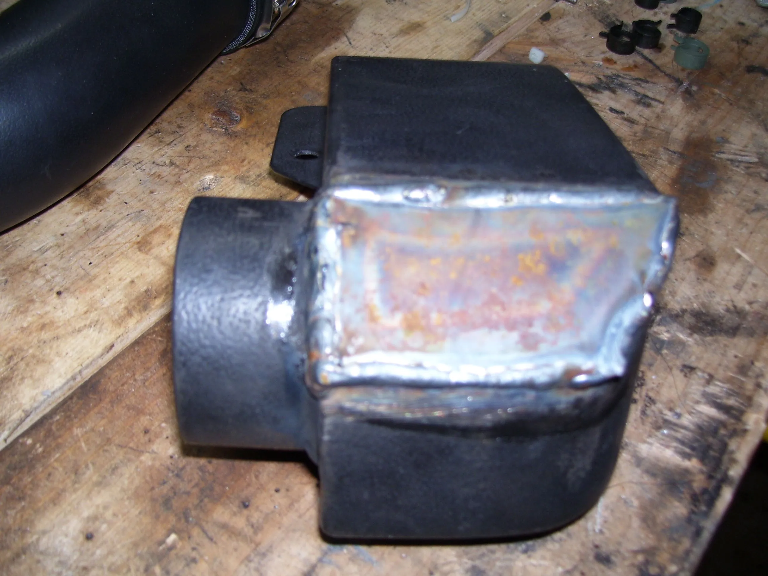

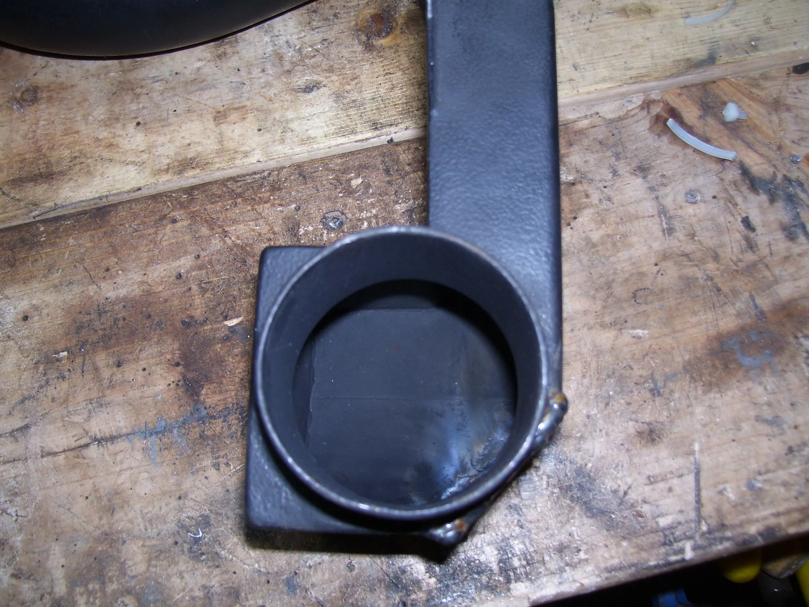

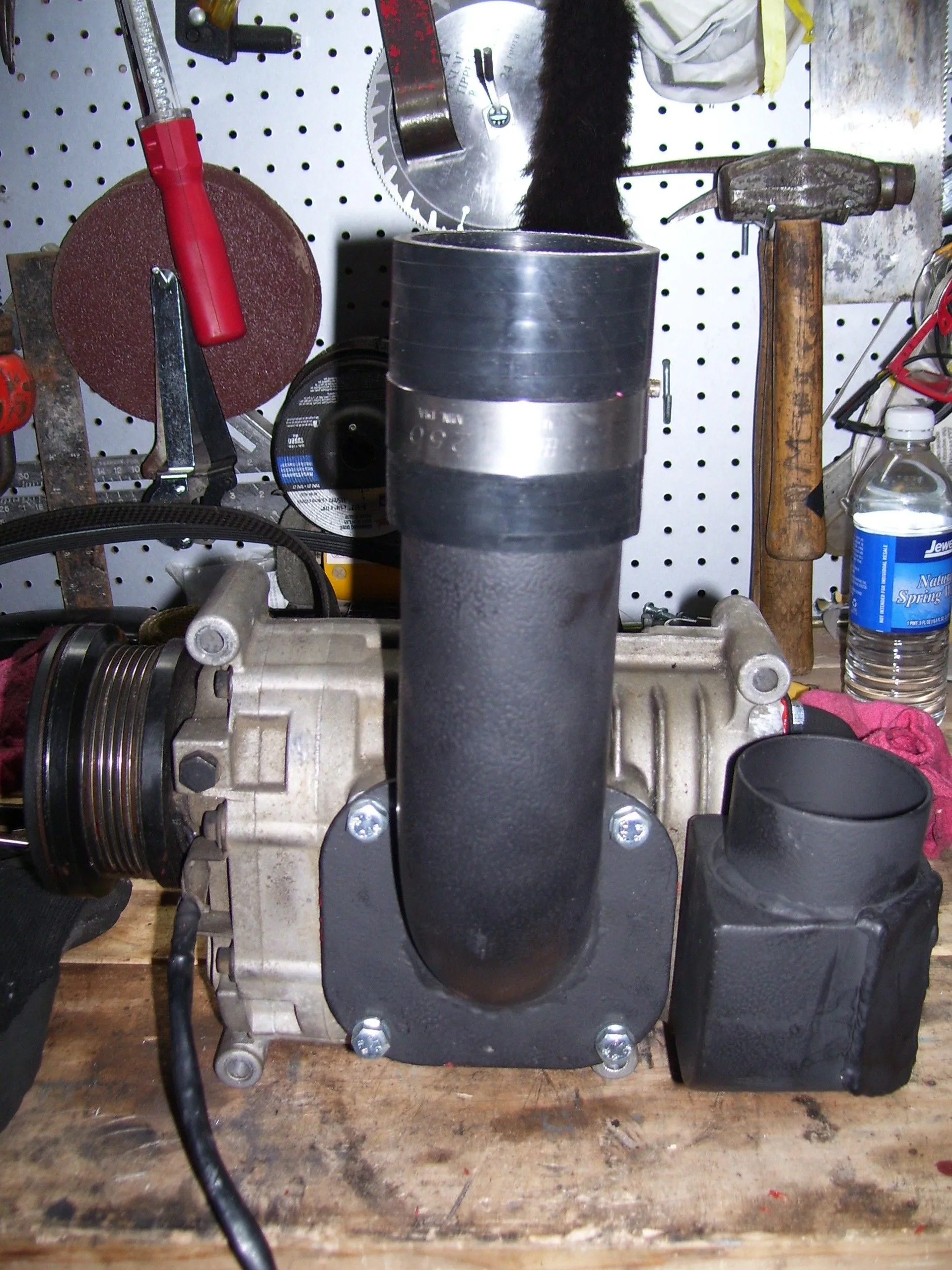

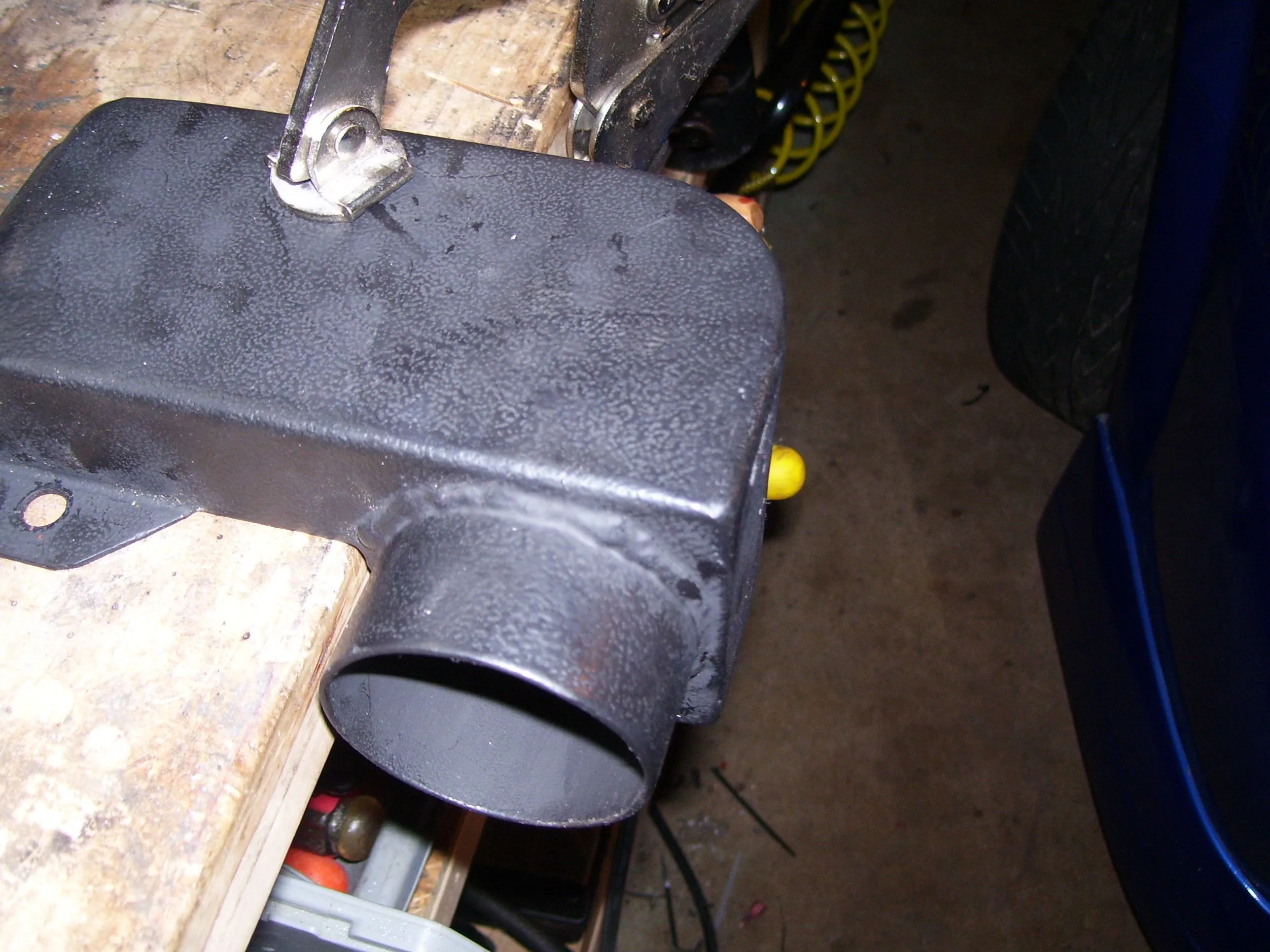

Also, here are some pics of the modification I had to make to the intake side of the adapter peice. That corner piece was hitting the lower radiator hose so I had to "adjust" it to make it work.
