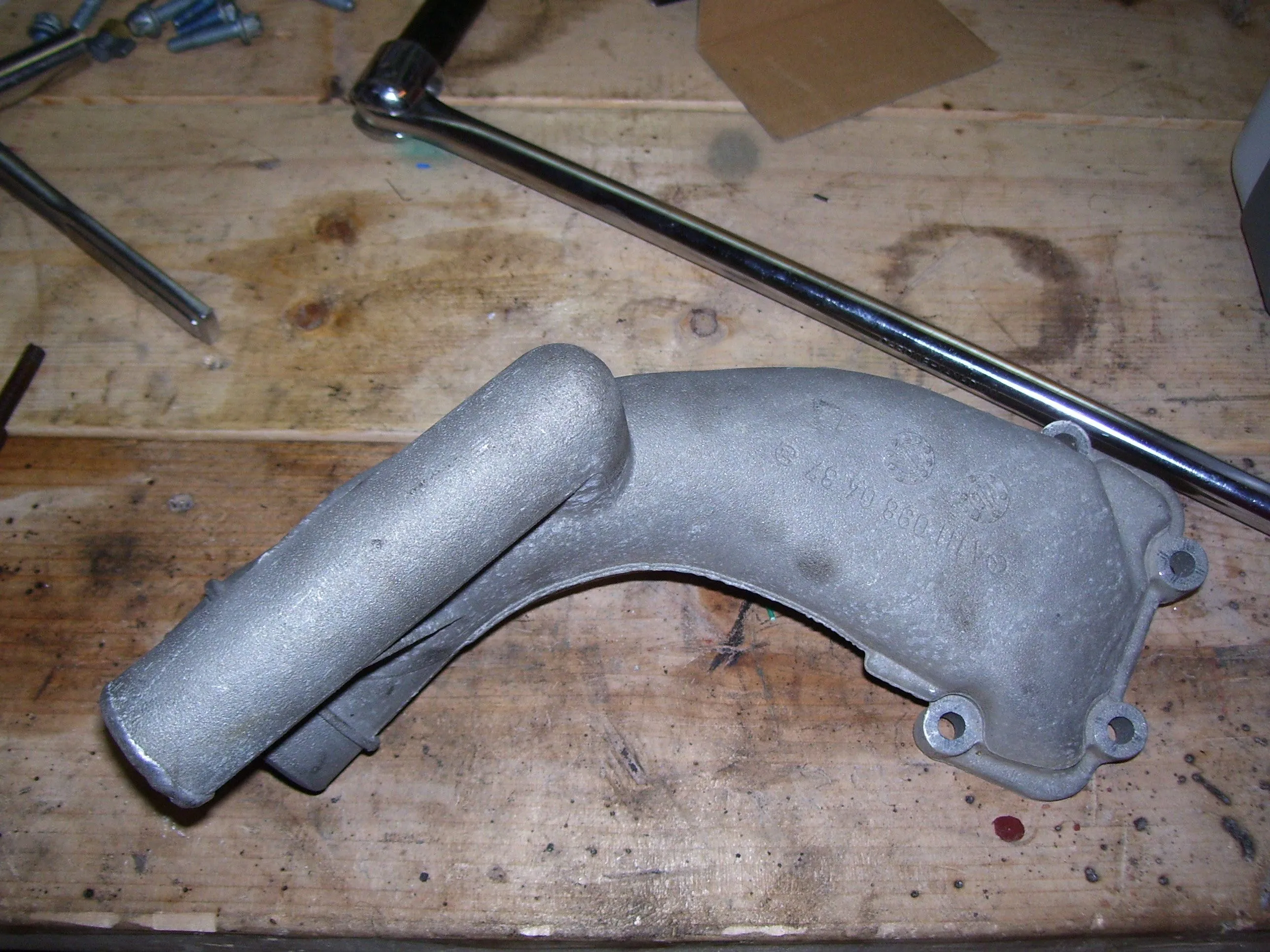

Here is a pic from someone else which shows the coolant pieces (I think its technically called the thermostat housing?)
It is a top view, but you can see how the housing is pointed straight down, but on the probe the housing goes almost straight left.
I will try and get some pics of the coolant housings side by side later on as well as some better pics of the OEM pieces that came off the supercharger (possibly later today). I looked to see if I could make the pieces work, but it doesn't seem likely due to the different directions of the housings.

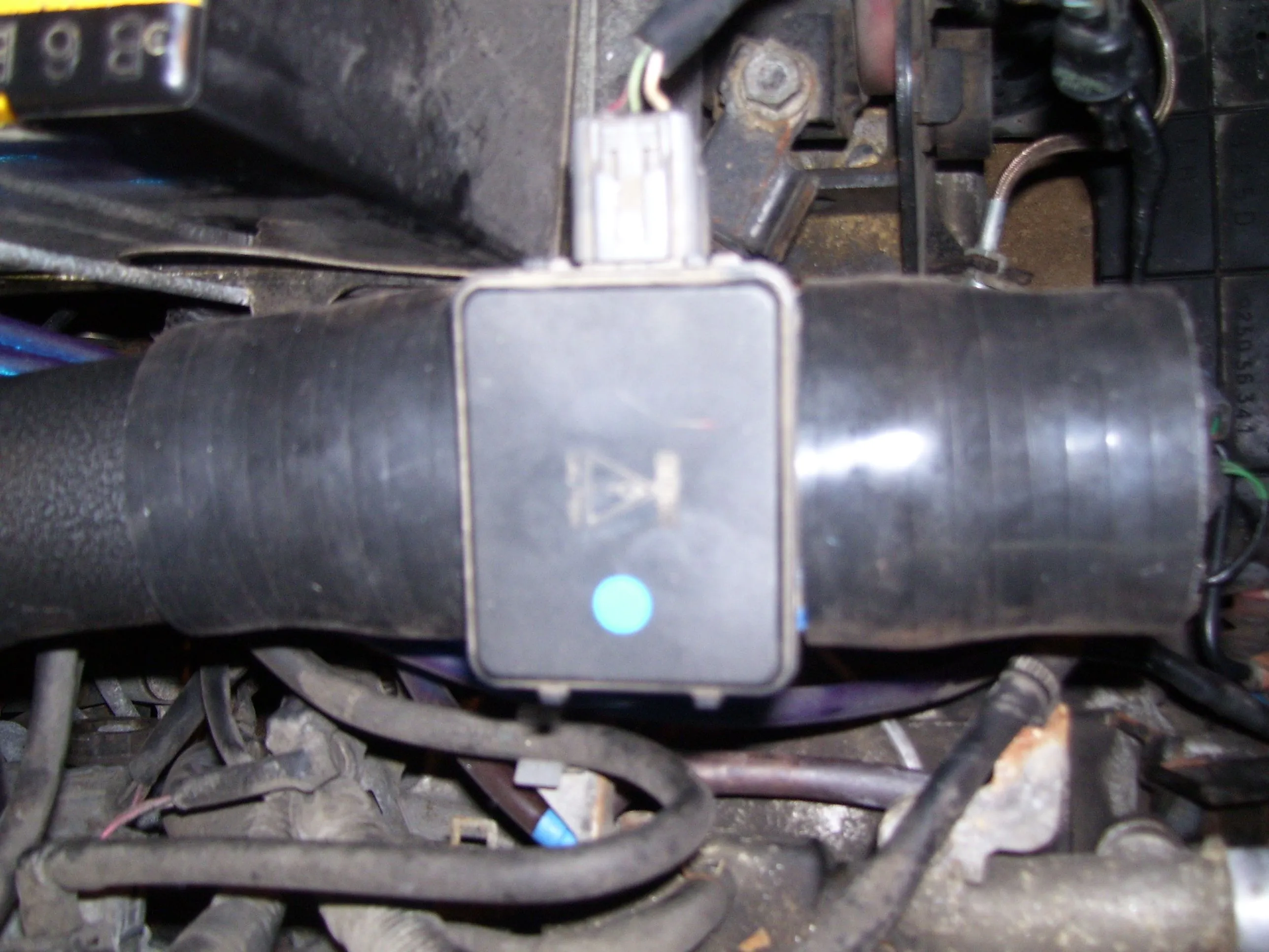

As far as the MAF goes the inlet on mine is 2.75in, and the piping seems to be 2.5in (outer diameter). So I got 2 reducers with one side 2.5in and the other 2.75. Hopefully the 3 in. length or so in the coupler will allow the air to expand without causing turbulence (im not too concerned about that). For now I will just keep the MAF after the bov so that it doesn't stall, like it does for msp's that have a bov and the stock MAF location.

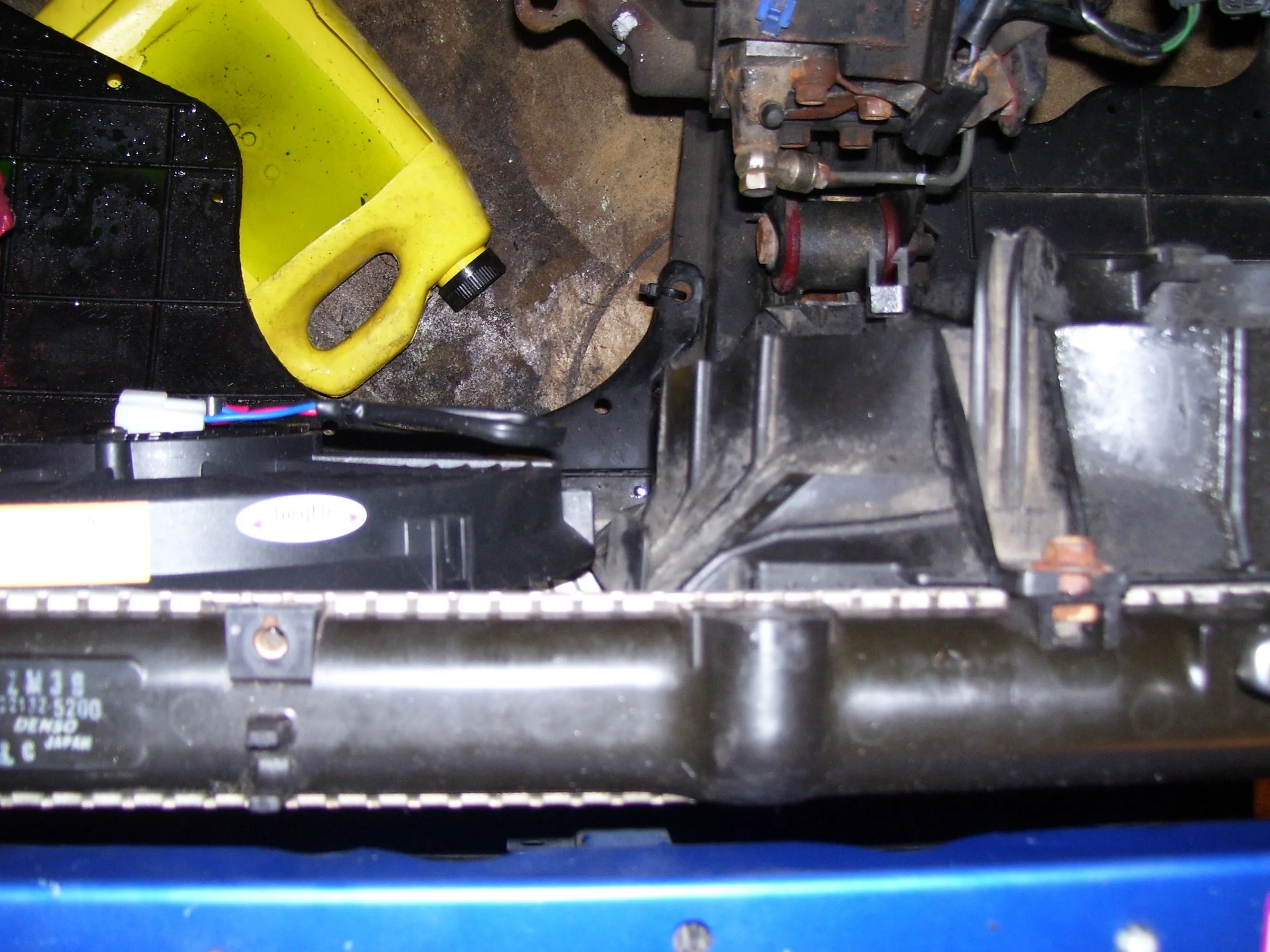

So I wasn't able to do too much over the weekend, decided to go snowboarding instead. But I did spend an hour or two and got to install everything to see how it all lines up. I had to do some cutting but everything is good now. It seems that the probes front clip is farther out then the proteges because the piping seems to be closer to the radiator then in bedwards pics. I've decided to install slim fans in order to get the pipes farther away from the header.
As far as the fans go I will have a one 12in and another 12 or 10in, depending on how things line up. I also have a temp sensor kit that I can set for the fans to activate. Both fans will be set up to activate automatically when they reach a specific temp. But for the 2nd fan I will have a switch so that I can turn it on or off. This is so that both fans dont always run when its not necessary, but if it is a hot day or I am at auto-x I can flip a switch and have both fans work.
I plan to reinforce some welds this week and repainting the rest of the kit. Hopefully I'll have some installed pics by the weekend.

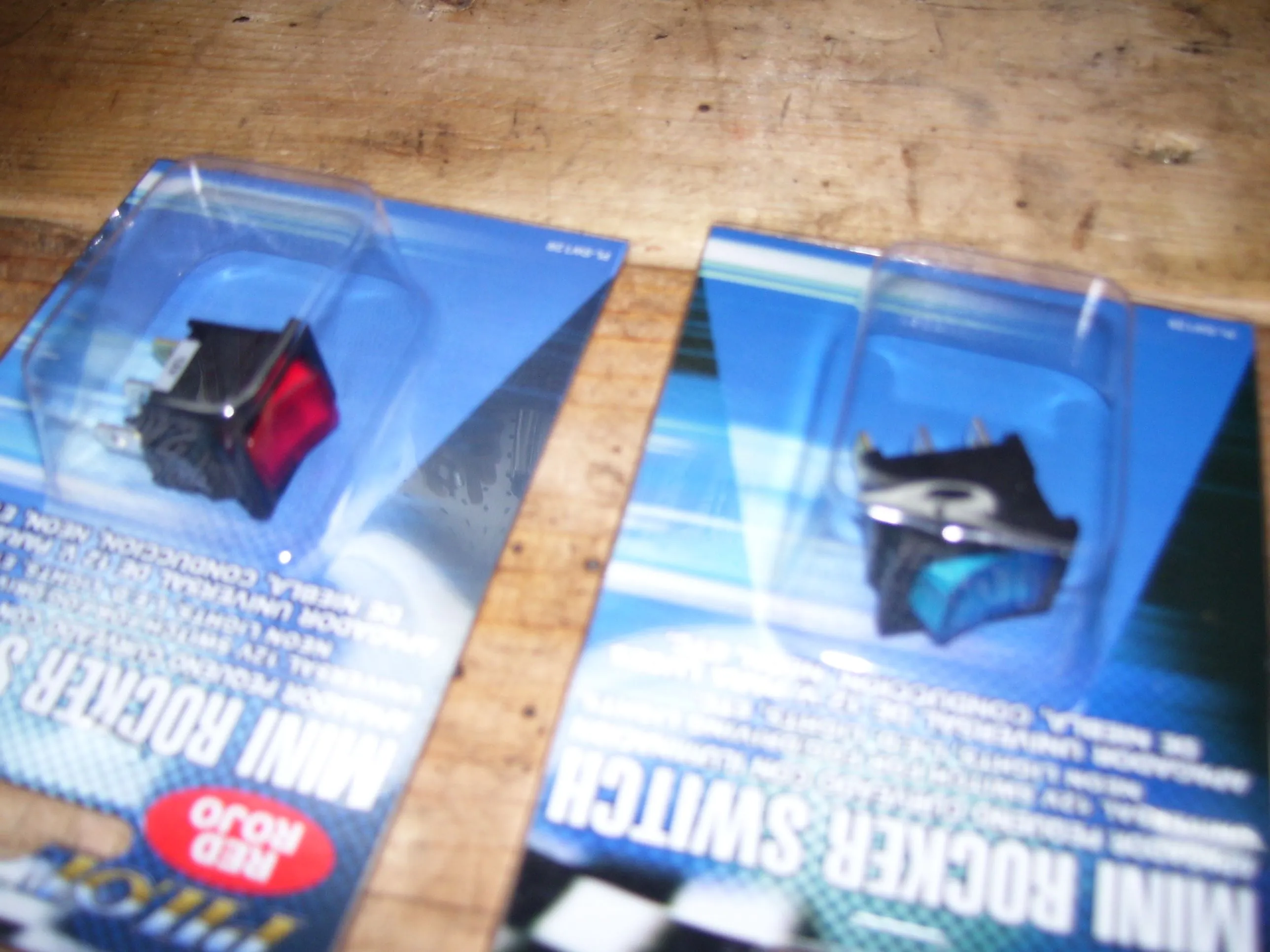

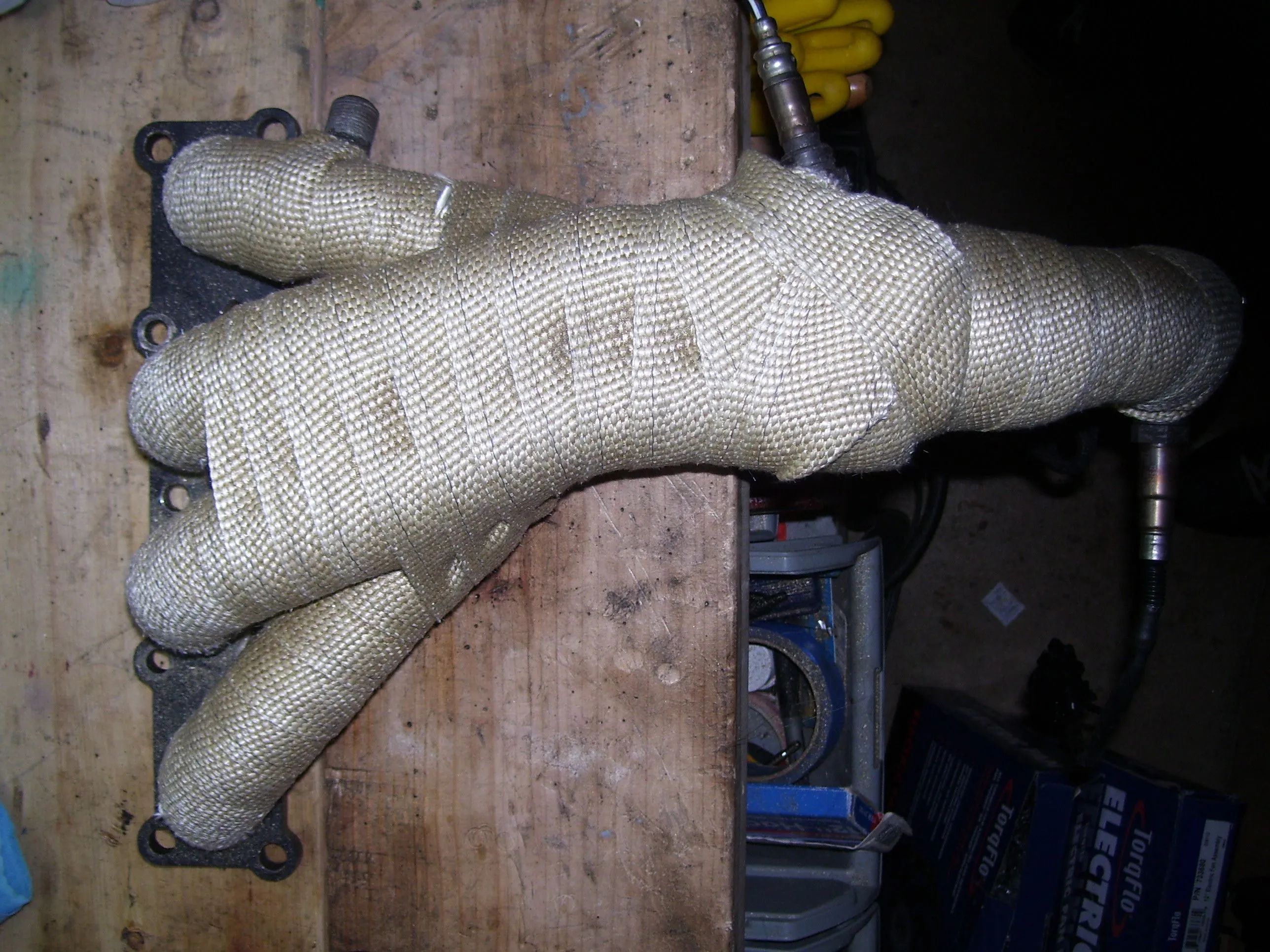

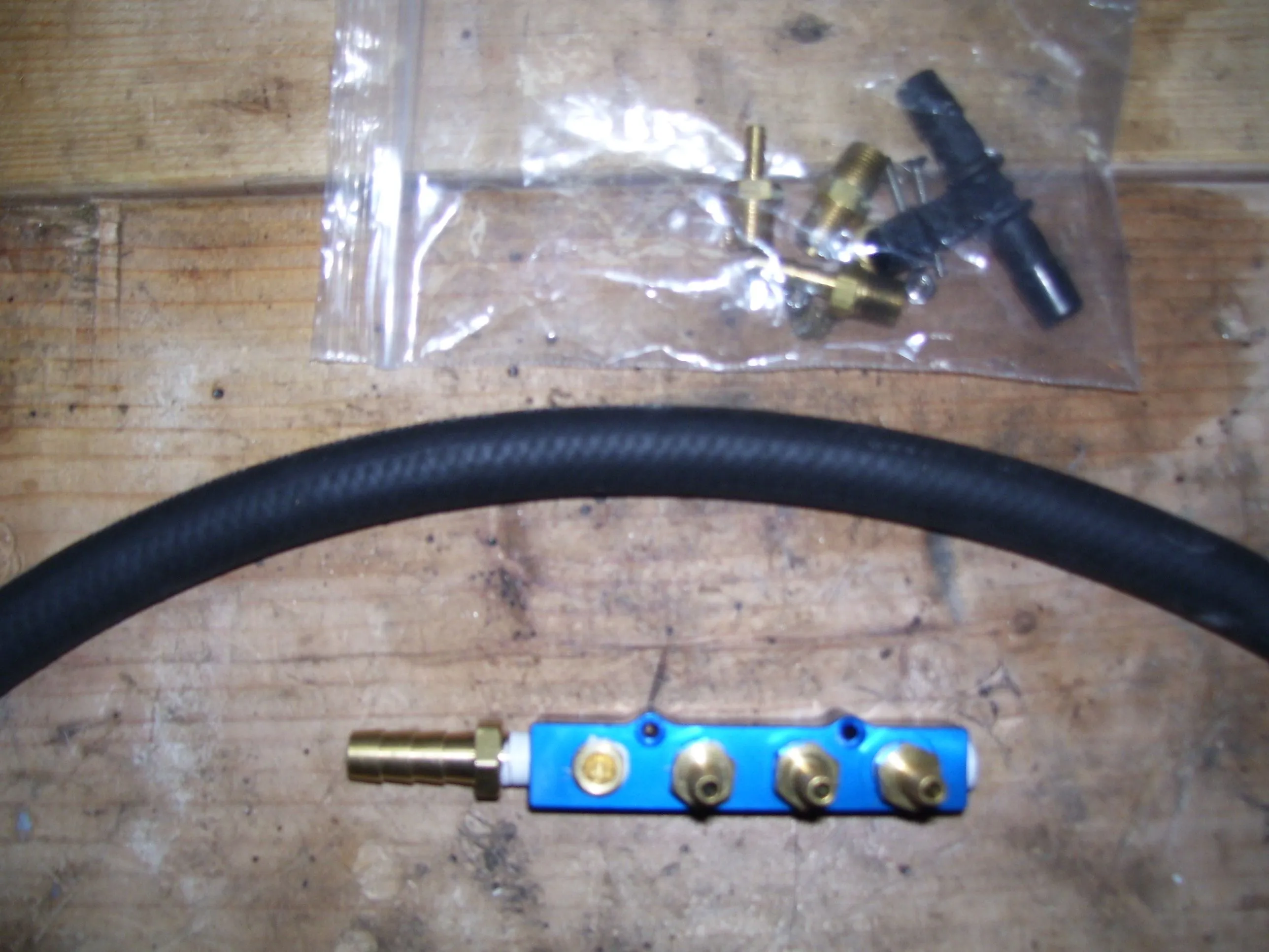

Pics:
1. 2.75-2.5in reducer couplers for the MAF sensor.
2. Vacuum block.
3. Wrapped header.
4. 12in slim fan (left), stock fan (right)
5. Red switch (for SC), blue (for 2nd fan)

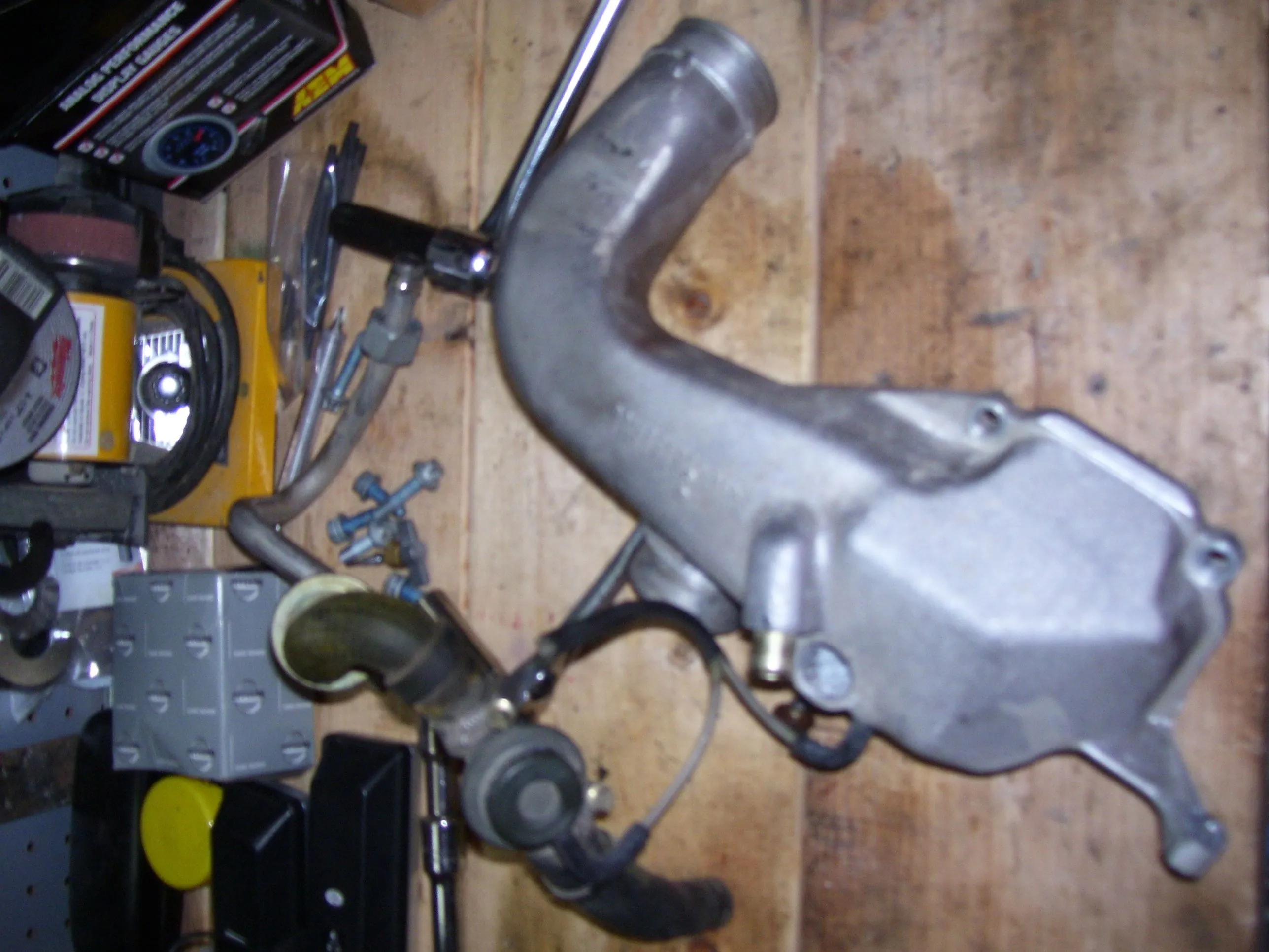

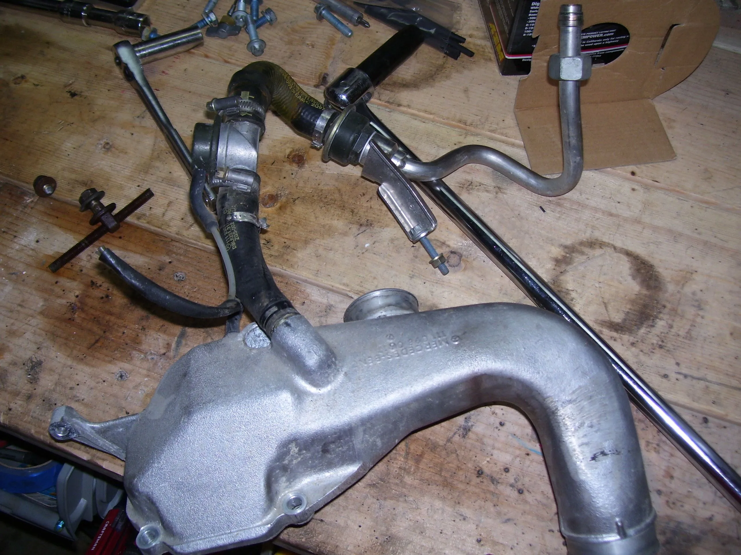

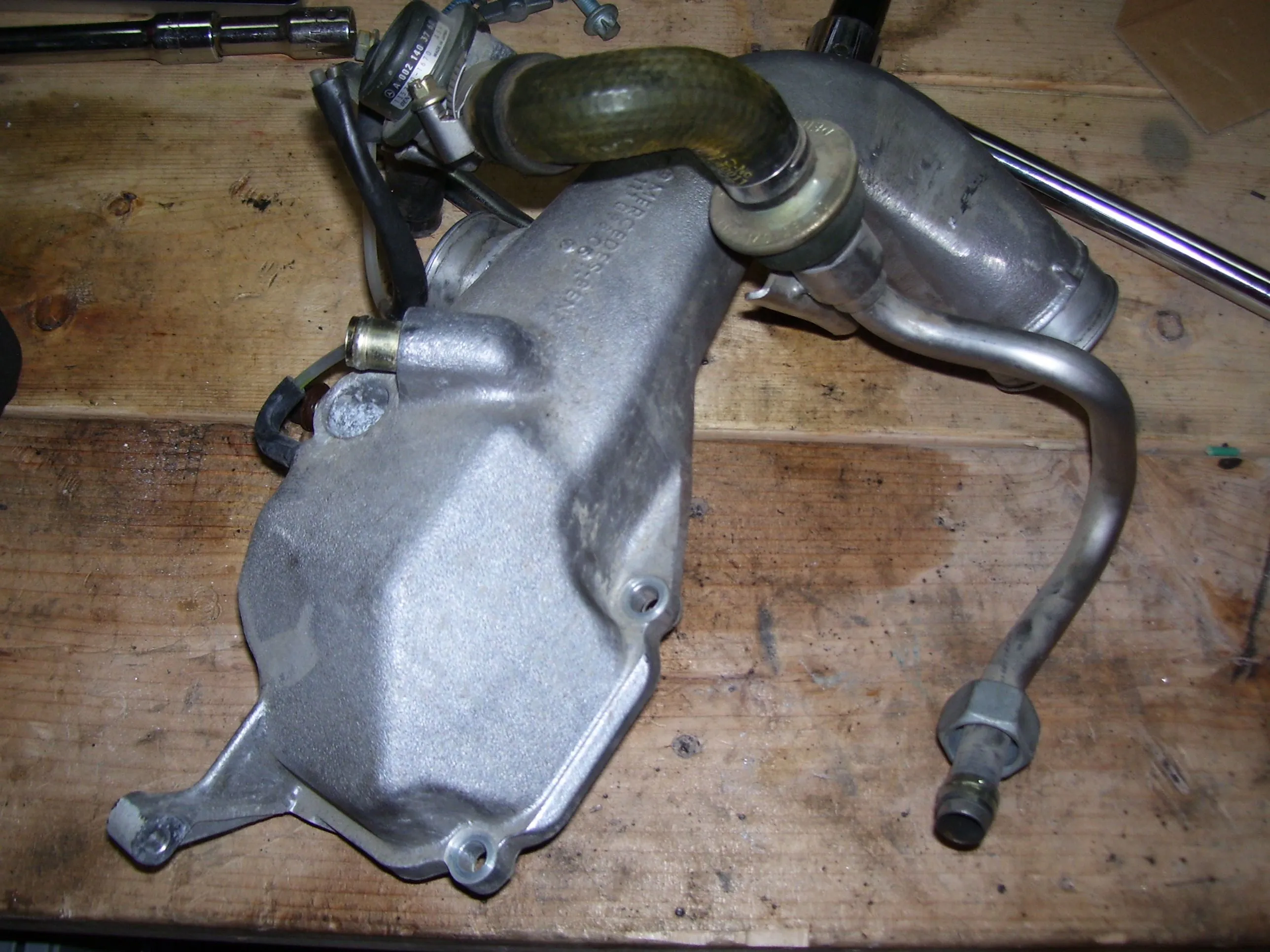

Some pics of the parts off the supercharger.
Left- off intake site of SC
Rest- pressure side of SC
you only attach one of the vacuum lines, its to the bigger of the two nipples

So I tried to start car over the weekend, and lucky it did start. I got everything hooked up, replaced crankshaft pulley, installed belts, installed fans and wiring....etc. Everything lined up good other then the bottom of the radiator. The bottom hose off the radiator is hitting the SC, but all I need is a couple more inches of hose and I can make it work.
