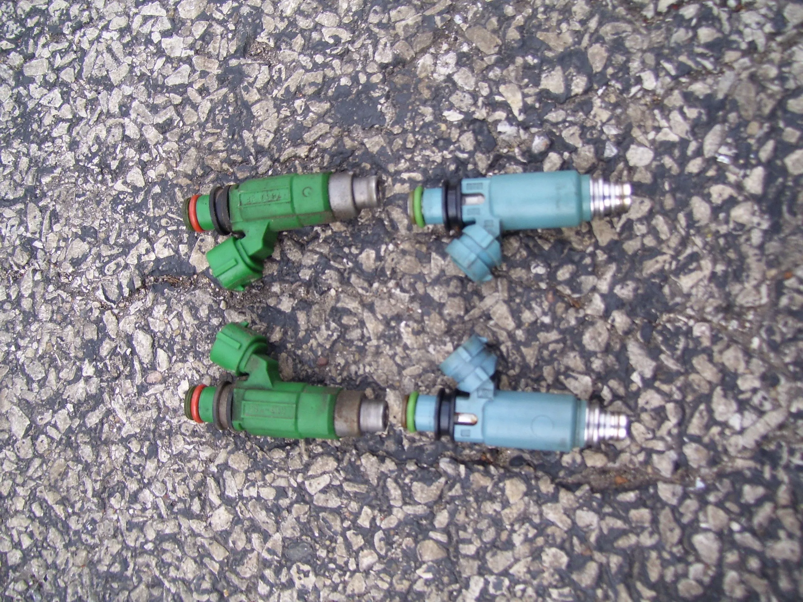

I installed wrx 440 injectors in place of the stock ones in order to address maxing out the MAF. Everything works great now. I can finally floor the car all the way to redline without maxing out the MAF, and best of all no CEL. I still need to work on the tune a bit at partial throttle because even at low rpm I sometimes end up getting full boost which I haven't had time to tune correctly.

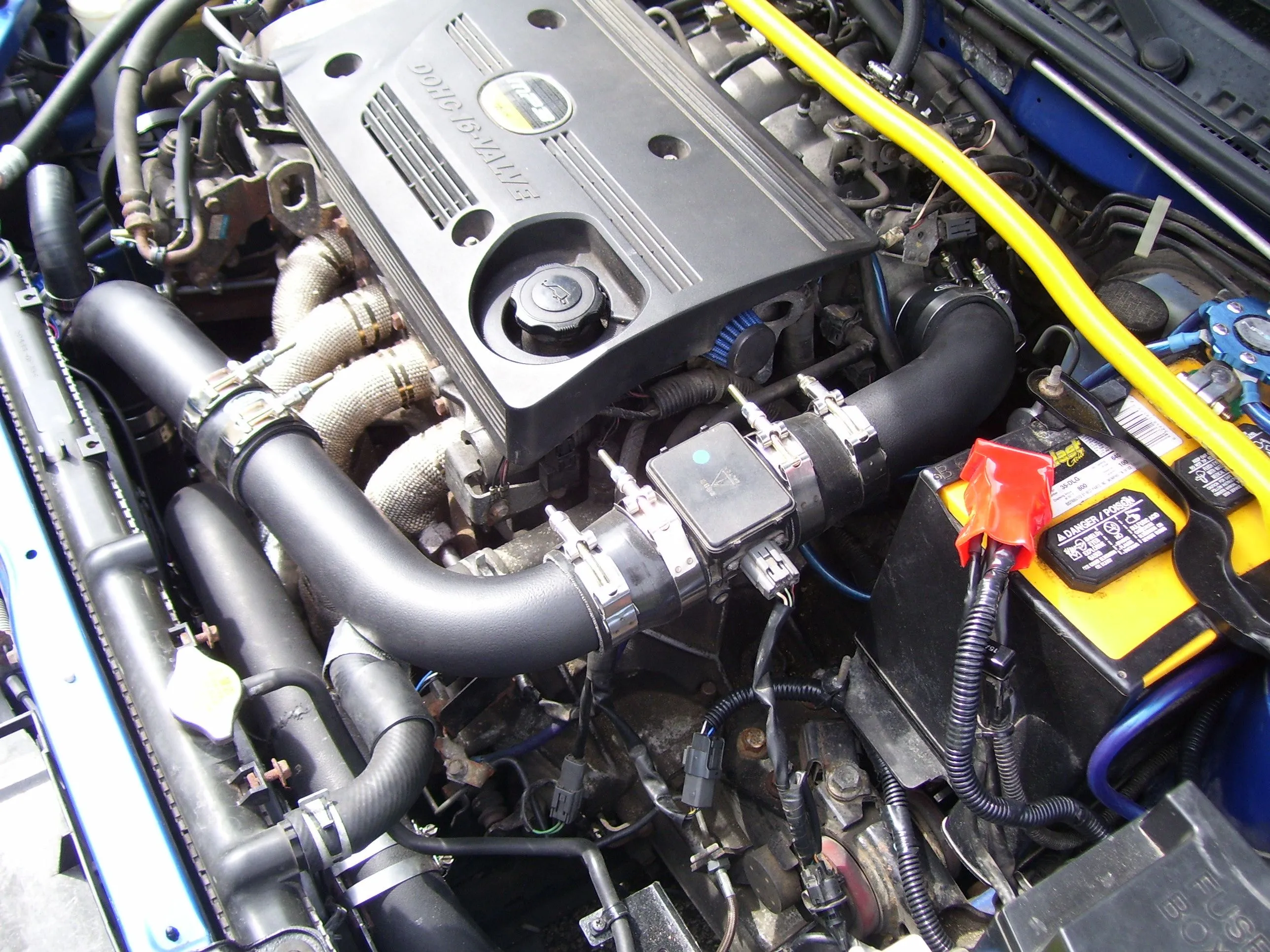

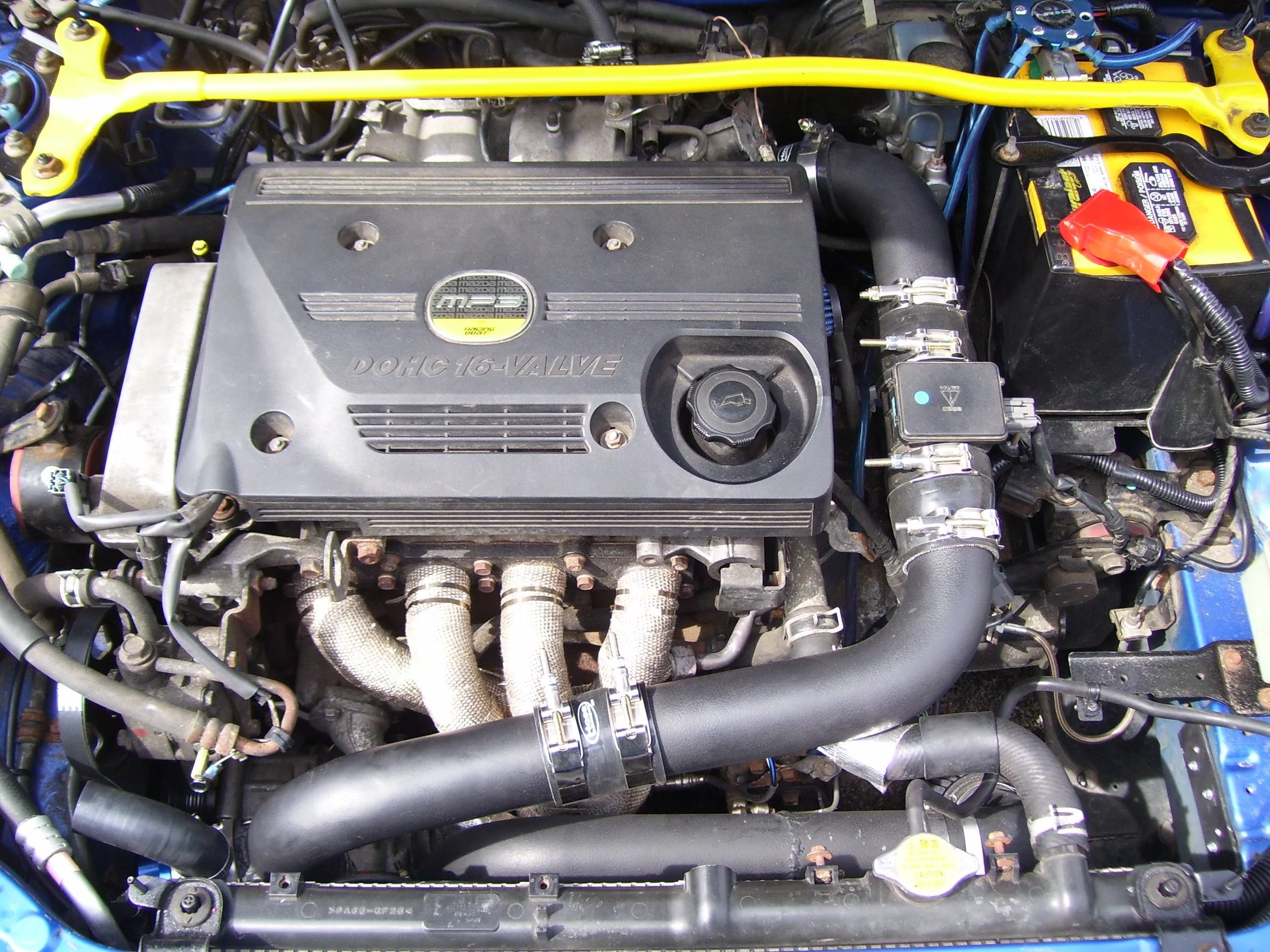

Below are a couple pics of the engine bay. I haven't had time to clean the engine bay, but I will eventually (poke). I will also get some video once the tune is all set and done. If I can I might get a dyno next week since there is a good deal at a shop around here for another week.
Here are some pics to keep some interest if anyone still cares. No nice snail or intercooler, just a NA header and some piping.(wiggle)
pic 1-Stock green injectors, wrx blue injectors
pic 2-You can see how tight of a fit it is for the lower radiator hose. It barely fits, but since it is so close to the header I used some heat wrap to help against the heat just in case.

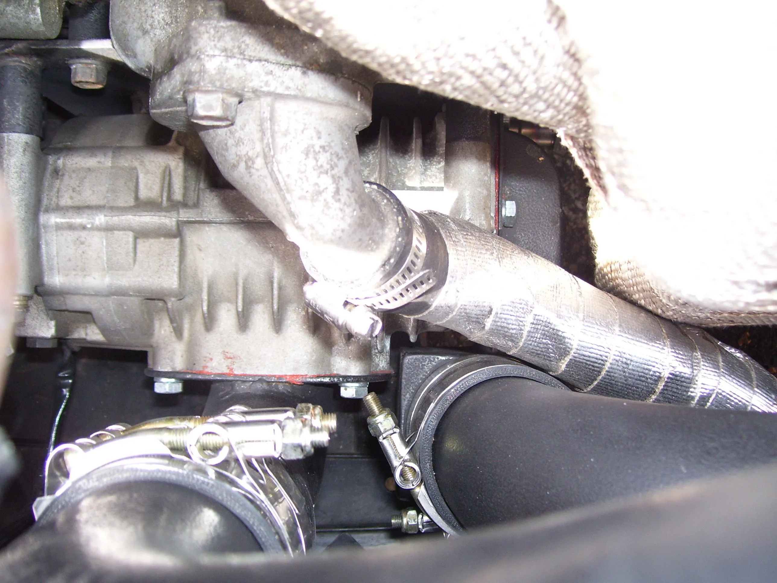

pic 3-The intake is very tight between the header and radiator. Slim fans are a must.
pic 4-If you look close enough you can see the SC in lower left. The uper radiator hose also comes close to touching the intake. I added some more heat tape to prevent rubing wear. Might eventually change to a different shape upper hose.* Bonus points for whoever sees the 2 different things about the bov.
