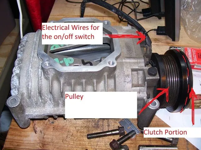

See I don't understand how the off/on switch works, I've never seen/heard of a forced induction setup with an on/off mechanism.
I also never heard of an on/off SC until I started researching the project, and yes it is almost the same as how the AC compressor clutch works. The reason the SC needs to be an Eaton M62 "clutched" is because only the mercedes ones used the clutch. There are other M62's, like for the pontiac bonnevilles or chevey cobalts and others, but all of the other ones dont have the special "clutch" feature, meaning they always stay on. The reason the mercedes one has a clutch switch is because the SC only engaged when the person would be going full throttle to help accelerate. There are two wires coming off the SC itself, and you simply wire a switch in between the power supply and the SC. If the switch is off, no power goes through, which lets the pulley portion of the SC freely rotate but does not transfer the rotation into the SC blades. When the switch is on, current goes through the clutch causing a magnetic attraction causing the pulley and SC blades to stick together and thereby spin together.

Also, I saw you post earlier before you edited it,lol, here is a little more explanation about the SC on/off thing.
attachment.php
The wires are hooked up to a switch in the cabin of the car, just like fog light I can turn it on/off. When it is off/ the pulley just spins freely with the engine, but the blades in the SC dont spin so it makes no pressure =NA mode. When the switch is on/ the clutch "sticks" with the pulley, which is connected to a shaft which spins the blades in the supercharger which then gives me boost = SC mode.

Just wondering the clutch on/off mode, should you have 2 settings for F/I controller mode?
One for SC off and one for SC on.
