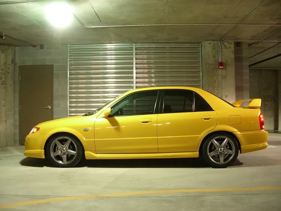

here is my set-up:
Eibach Sportlines with Toyo Proxes4's (215/45/17)
