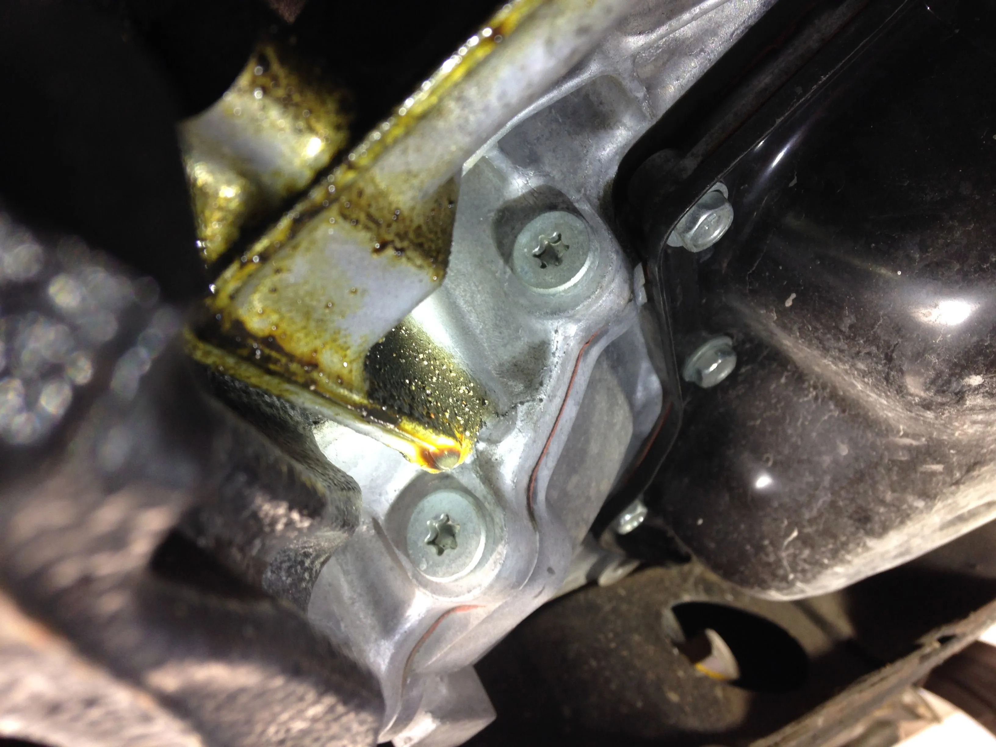

I need to drop my splash shield or endoscope the area again. I got done swapping my snow tires and noticed the oil pan did have what appeared to be new RTV. We'll see... I might look this weekend. Hopefully this is fix but still need to address the upper cam chain cover one. I have some oil there even after cleaning up with brake cleaner.

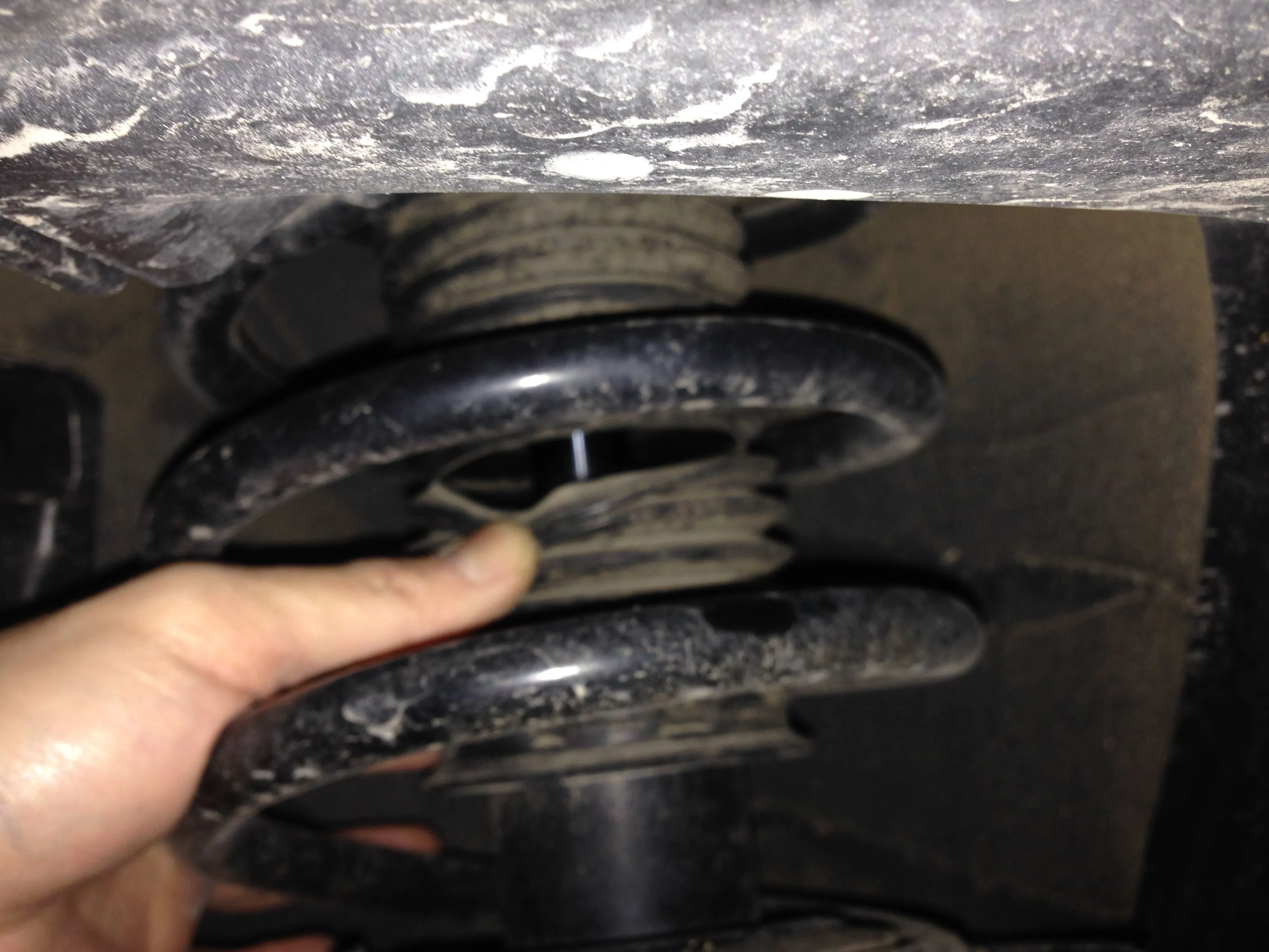

Side note, my front shock boots kept getting torn apart, I don't take the car off roading and it happen twice already. luckily its also cover under warranty. Anyone experience same issue?

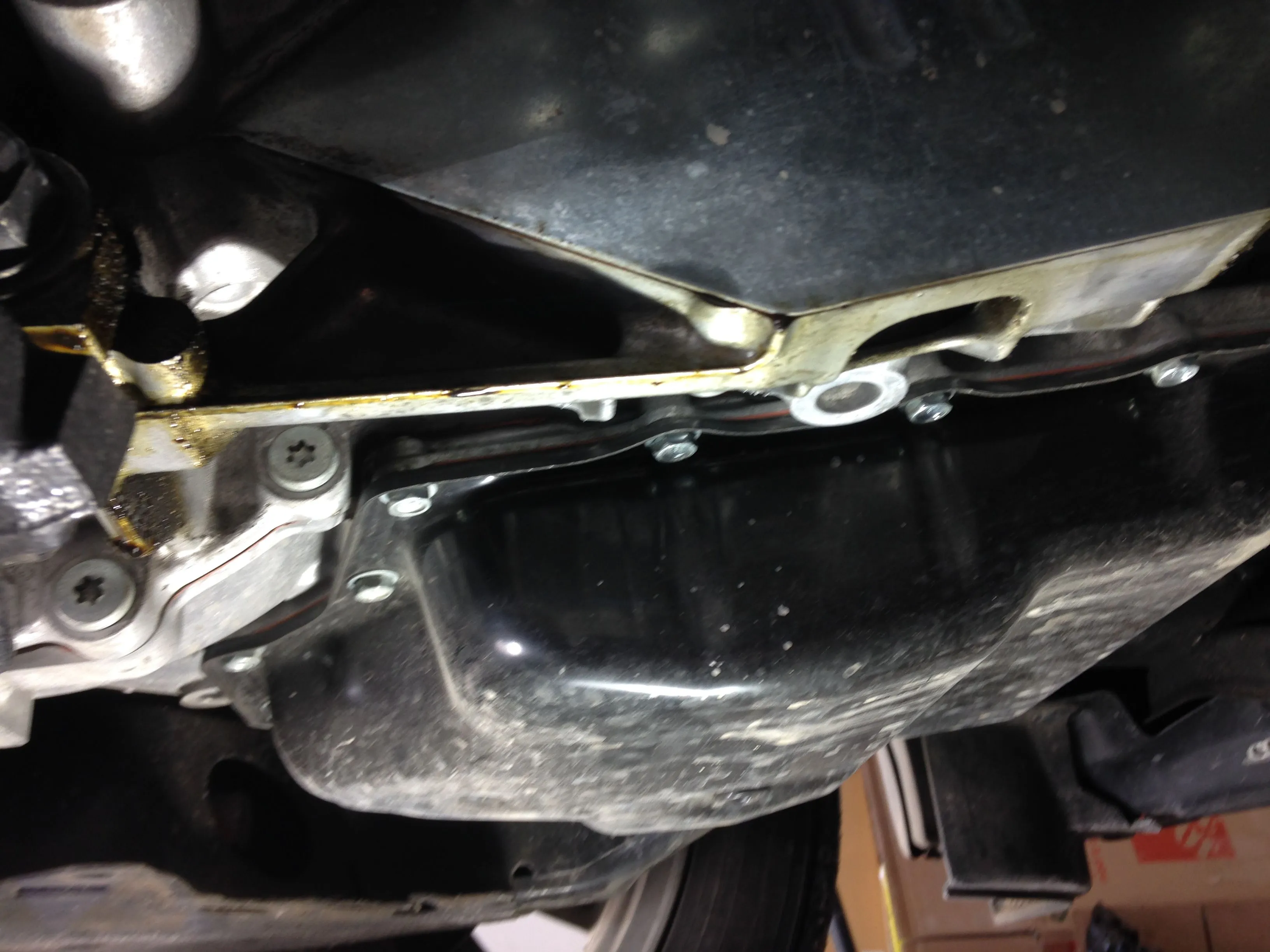

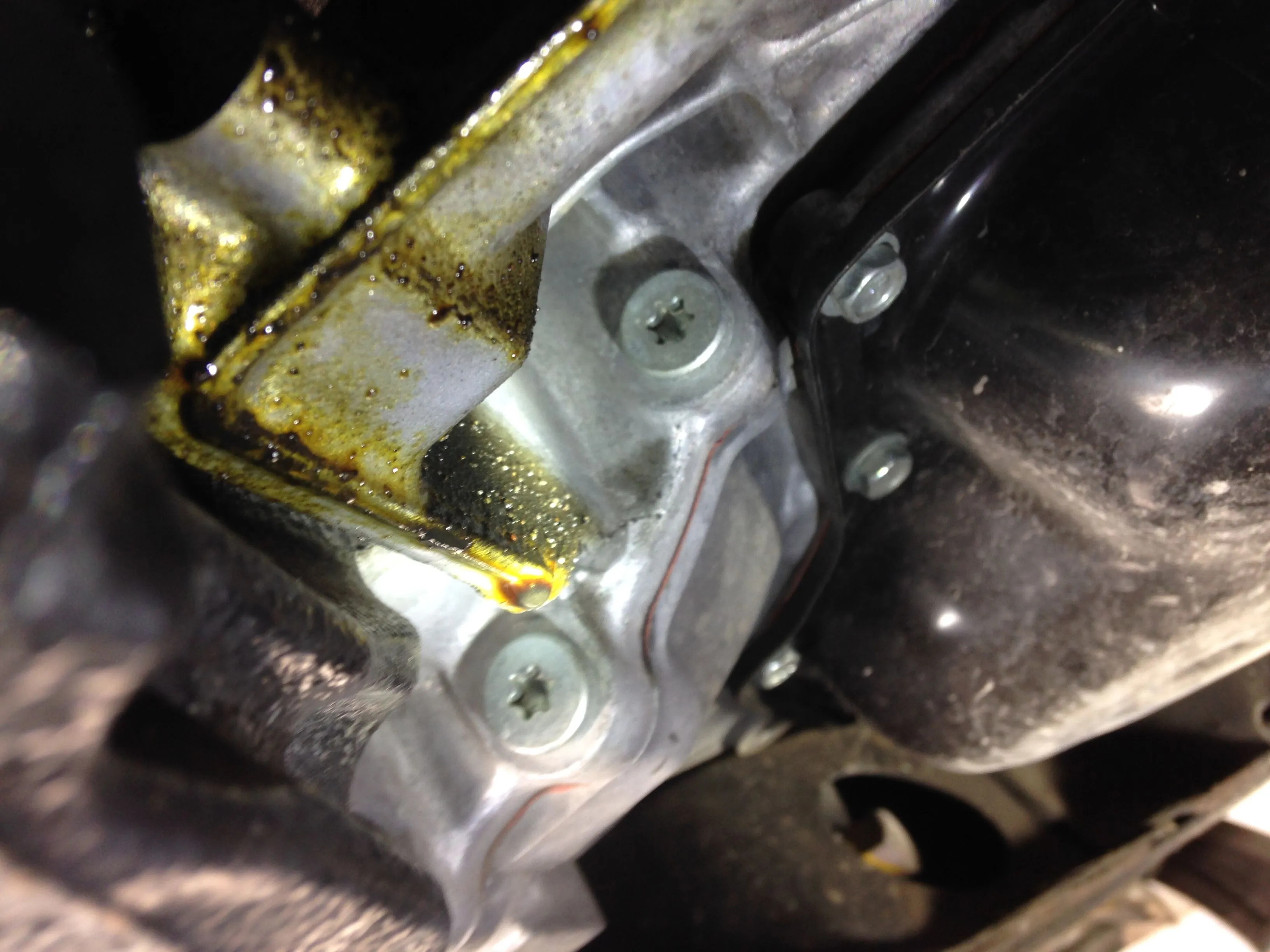

I think I will drop my splash shield tomorrow and look at mine to see if the oil pan work fixed it or not. If I see anything would definitely think transmission as well.
I dropped it this morning and did notice some oil residue. I cleaned off with brake cleaner so I have a baseline and will drop in a month. If there at that time off to the dealer.

i've lost track of your oil-leak fixes as it has been done several times. I feel sorry for you as you should spend time enjoying spring weather, not wast time checking oil leaks on a relative new vehicle. I believe your oil leak is still there, as when your dealer re-sealed the oil pan, they would clean the area. It seems to be the ATF leak after all from beginnng, in addition to the front timing chain cover leak.
I am certain is still there as well. Oh well.. it's a torrential downpour here today so not a biggie in the dry garage :-)
At this point I think they are going to need to need to pull motor and transmission. It obviously wasn't the oil pan or residual assembly grease. I do wonder how many people actually have this same issue occurring. The underbody splash shields can conceal a lot.
Comparing pictures of your leak posted today and those you posted on 5/26/2016 in the post #1, they look exactly the same. I still believe it's coming from input shaft seal of your transmission like I suspected back then.
Thanks! A leaking engine is one thing... a leaking transmission is another as it isn't exactly the easiest area & method to check fluid level since based on temp.
