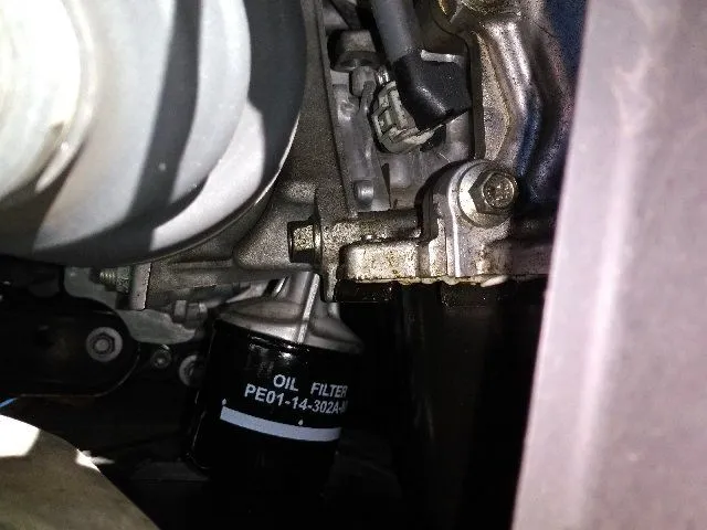

Car is at the dealer now. Apparently there's some kind of TSB regarding the oil pan leaking which requires replacement?? Tech was telling me about it because he said my oil pan was leaking. I didn't agree with him but we'll see what he finds when he takes it apart.

I agree with you that the oil leak doesnt look like caused by oil pan from the picture you posted as we can see oils way above the pan. It seems to be from timing chain cover area again and I believe your dealer didnt do a proper job fixing the original leak based on the TSB. I didnt see any oils in that area last time when I changed my oil, but thats a couple of months ago when the weather was warm.
How did you get that Japanese made OEM oil filter by the way? Or is there the -MV we cant see after the PE01-14-302A on the oil filter? ;)
I agree with you that the oil leak doesn*t look like caused by oil pan from the picture you posted as we can see oils way above the pan. It seems to be from timing chain cover area again and I believe your dealer didn*t do a proper job fixing the original leak based on the TSB. I didn*t see any oils in that area last time when I changed my oil, but that*s a couple of months ago when the weather was warm.
How did you get that Japanese made OEM oil filter by the way? Or is there the *-MV* we can*t see after the *PE01-14-302A* on the oil filter? ;)
It's the MV...just changed the oil and filter a week ago for nothing...
attachment.php
Where'd you get the Japanese oil filter?

Did you get a new oil pan or just a new oil pan gasket?
