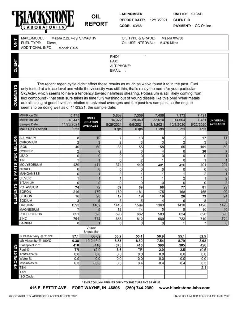

Latest 2019 2.2 diesel (USA) UOA report from 40k mile service. Mazda 0w30 oil again and I am doing three 5k mi intervals. This fill was Mobil1 0w30 ESP so we'll see how that compares to the Mazda branded oil on the next report.

The ESP line is very good. Generally very shear stable and they use a touch of POE in the blend, which lately has been a combination of GTL/PAO. Very good oils.
Interesting that the 7500 mile oil changes are mostly within and close to averages and only slightly worse than the 5000 mile changes. Not showing too much benefit to changing oil earlier than needed. Were all past changes with Mazda oil?
Yes, from New 0 miles to a couple weeks ago 40k mi service has been Mazda branded 0w30 diesel oil.
The blackstone report shows averages for both my specific vehicle and (column on the right) "universal averages". I wanted to try a few 5k mi intervals mainly to see if there was any change in the viscosity, insolubles and fuel dilution between the 5k and 7.5k runs.
I don't see enough benefit from the two 5k interval changes at this point to justify sticking with that.

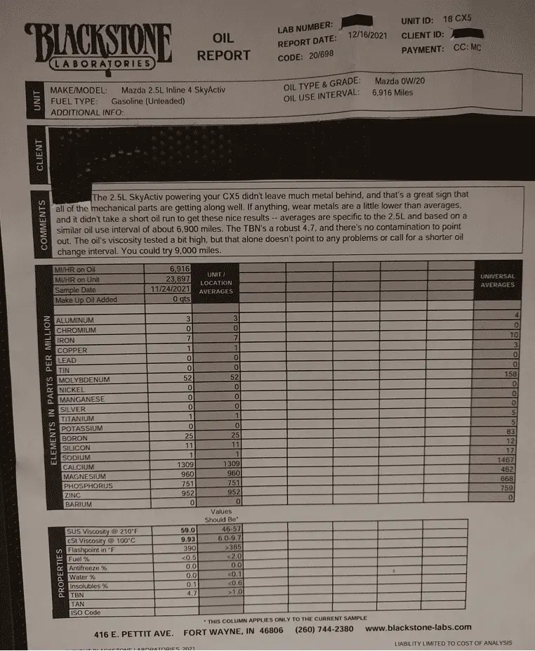

For a 6900 mile oil change, Report says everything is fine except the viscosity is slightly high. Also the dealer supposedly had used Mazda oil(per the invoice) in prepping the vehicle for cpo sale.
But the report only had 59 moly in it..so wondering what they really put in my engine...couldn't have been Mazda oil. Reports on here of Mazda moly oil show 200 to 500 moly in the crankcase. So they had to have used some cheap barrel oil but invoiced it as expensive Mazda oil.
Is 59 moly enough for these engines?
Between the high viscosity and low moly, am wondering what they put in there.

⋯ But the report only had 59 moly in it..so wondering what they really put in my engine...couldn't have been Mazda oil. Reports on here of Mazda moly oil show 200 to 500 moly in the crankcase. So they had to have used some cheap barrel oil but invoiced it as expensive Mazda oil.
Yes, if the Mazda dealer used Mazda 0W-20 moly oil, the molybdenum content should be 600+. The UOA on factory-fill from the 2.5L also shows 600+ on molybdenum.
On the other hand, after the engine break-in, I believe the high molybdenum content is not necessary for any types of engine. So no, 59 on molybdenum content is definitely fine for these SkyActiv-G engines.
Here's the report showing the low Moly / high viscosity so the dealer definitely didn't use Mazda oil despite that showing on the invoice. Who knows what they put in there ? and they wonder why some people won't go back to the dealer for service? The Blackstone report identifies the oil as Mazda oil only because I provided that information as per the dealer invoicing.
Thanks Yrwei. I used castrol edge this time so it will be interesting to see how much moly is in the castrol.
For most 0W-20 UOAs I’ve seen, other name brand oils usually have much less molybdenum content. Castrol Edge has 60 ~ 90; Mobil 1 EP has 50 ~ 60; Valvoline SynPower has only single digit.

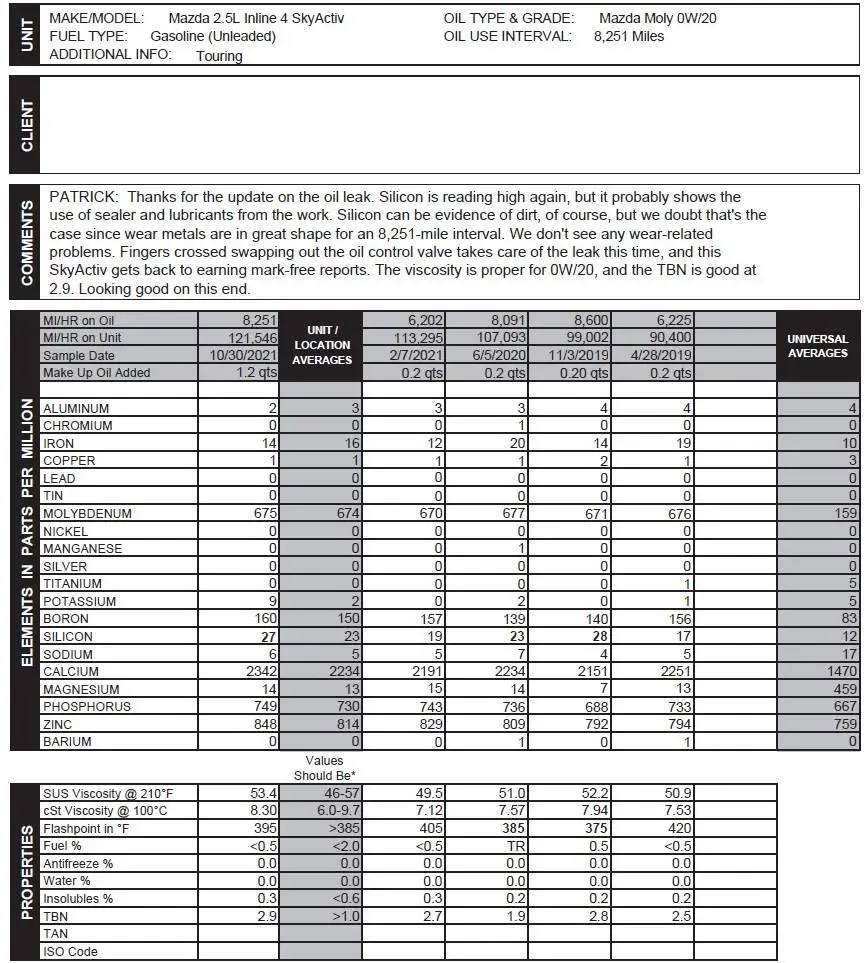

could have sworn I posted my latest the other day but I guess I didn't. This is from the oil that was in the engine during all my valve cover, oil seals and OCV replacement work a few months ago. I did not keep good records of how much oil was added during the previous OCI's, which is why this time it looks like I added more. I don't think it was anything out of the ordinary.

675, ha, Mazda Moly 0W-20!

This isn't related to the hairline crack in the head that I've been reading about? Maybe it's showing up now after warranty period and a ton of miles?
May do next oil change with the Mazda moly oil since my thins it out and would get through any crack easier hopefully making diagnose possible.
No, we haven’t heard anything major on cylinder head from the 2.5L NA as PatrickGSR94 has a 2014 CX-5. 2.5L NA with cylinder deactivation was introduced since MY 2018 CX-5, and 2.5T was introduced since 2019 CX-5. Both cylinder heads are re-designed based on the original 2.5L NA without CD, and are different from the one on the 2.5L NA without CD. Using the moly oil won’t help anything to prevent cylinder head crack. It’s a design issue.
Oil leak on valve cover gasket、oil control valve and its seal happened on PatrickGSR94’s 2.5L is a very common problem on all SkyActiv-G engines with higher mileage.
