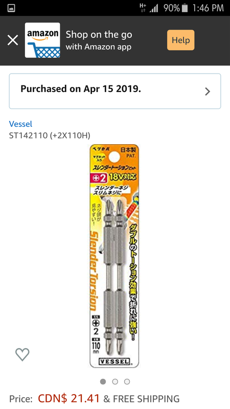

They're still available.
I bought these. They came right from Japan.
I can't read the directions. lol

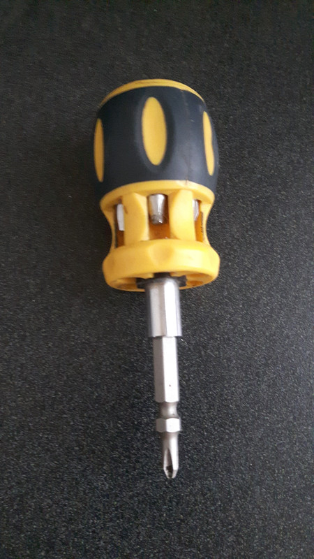

I cut one in half to use in my stubby...

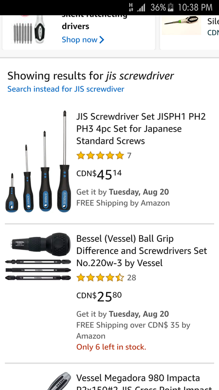

that's the problem is NO ONE makes an official JIS driver or bit, not even Vessel does anymore even though some advertise it as a JIS bit/driver, it's really a JIS/Phillips bit/driver.

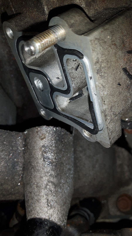

I took a picture of my parts engine where the IAC attaches to the intake.
You can see where a piece of the gasket broke off when I removed it.
There's a groove that holds the gasket and the gasket looks like a critical part.
You might be able to use RTV silicone but it really needs a good seal.
