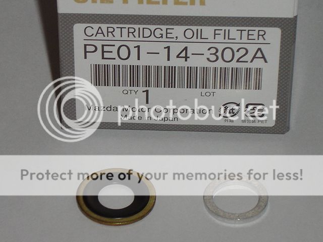

Here's the 2 gaskets the dealer gave me. The rubber one is a tight fit around the plug. I used the metal crush ring, cause that's what was on the car.

Yeah, the metal/rubber washer definitely is not the right one, especially it's made of steel, not aluminum. I haven't done the first oil change yet to our CX-5, but from what I saw and heard, it's the easiest oil change you can find.

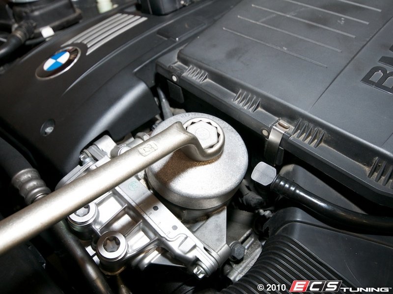

I ask as I've never seen the oil drain plug for Mazdas. I'm recently coming from BMWs and VWs which have the oil filter in the engine bay for easy access. I would extract the oil from the dip stick opening. The oil filter canister cap required a specific torque spec. I gave my oil extractor away but kept my torque wrench which I purchased specifically for my old BMW that I no longer own. Should I start doing my own oil changes again I think I'd use a torque wrench at least for the first couple of attempts. Haven't done my own oil change (traditional under the car) way in about 10 years when I owned a CRX.

You're right the oil filter on BMW is so easy to access from the top. The use of the paper cartridge oil filter is for environmental concerns (easier to recycle without the metal canister) and I was surprised Mazda haven't adapted it as Toyota has followed the suit.
