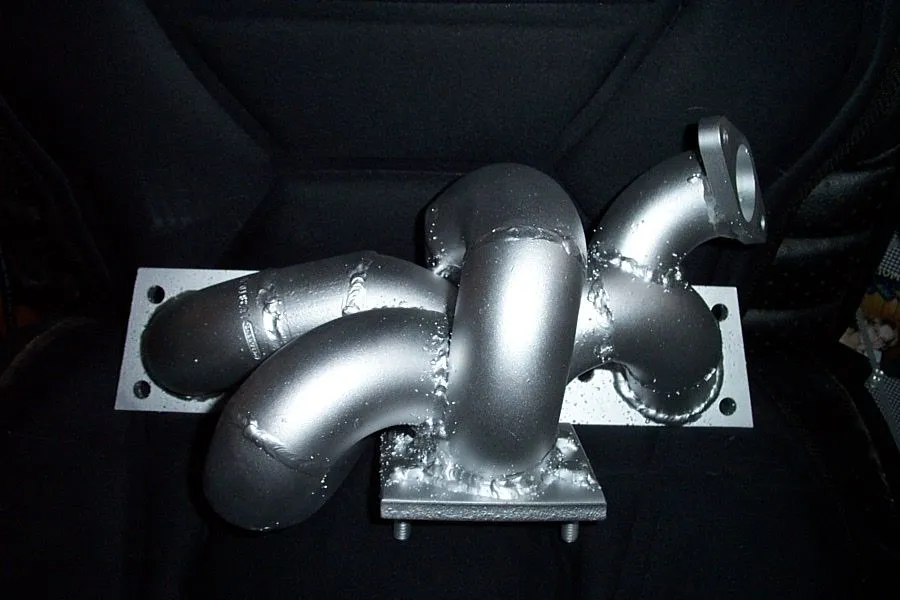

OK boys and girls its done here it is with the coating....I still need to do some porting so not quite done but for the most part yes it is.
