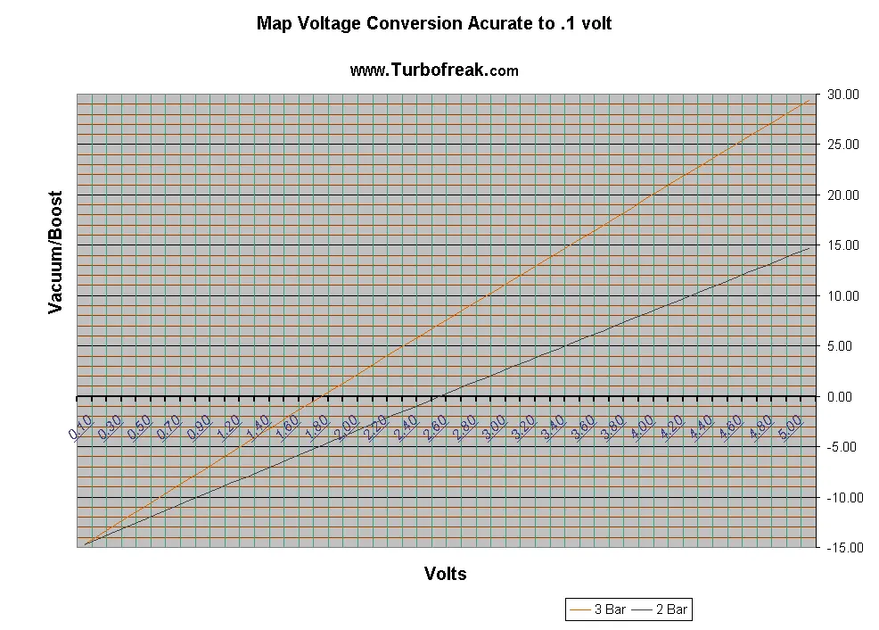

i wanted to add this
MAP SENSOR BAR vs VOLTAGE
