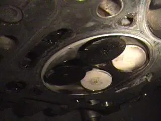

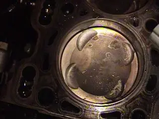

i know this is an old thread but as my experience...the FSDE is an interference engine (for me). I have bent a few valves before.
This could be in fact a different case...but...there you have it. It does have valve reliefs so its not supposed to bent valves.
For now, I would say its a non-Interference.

You say you have bent valves, yet you say it's a non-interference engine?
With valve reliefs in the pistons valves should not bend when the engine running normally. Both valves will be slightly open at TDC on the exhaust stroke. That is valve over-lap and normal for most all engines. However, some engines do not require valve reliefs, it depends on the type piston and combustion chamber shape. Higher compression ratios can make a difference on what is required.
The relief's are in the pistons to provide additional clearance between the the valves and pistons during the valve over-lap period of normal operation. They are not there to make it a non-interference engine in the event of a broken timing belt.
Assume your timing belt breaks. The cams will stop turning but the crank will continue to turn until the inertia is used or until you get the transmission in neutral.
When the cams stop turning some valves may be fully open. Guess what will happen if the piston moves past TDC in the cylinders that have some valves open. BANG.
That makes it an interference engine. The Gates manual also calls it an interference engine.

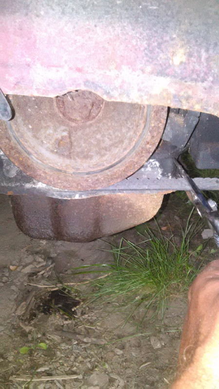

Countless ?? Really ?? Have you Ever seen an FS-DE engine survive a T-belt snap or skipping of teeth ??
(I just did in my backyard!!)
Your statement is quite misleading... You're suggesting that if your T-belt snaps, you need a new car or at least a new engine or rebuild and that simply is not always the case.
If anyone here on the forum snaps a T-belt on their P5 it is certainly worth the $35 and effort to throw on a new T-belt and give it a try.

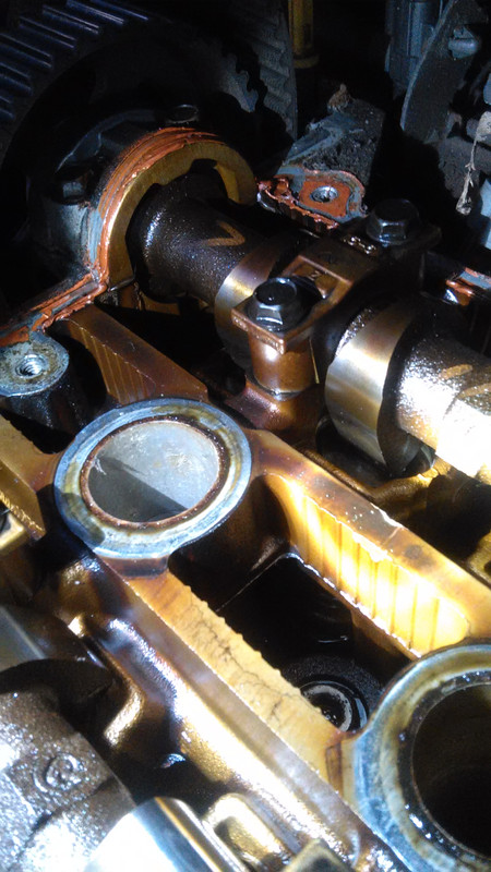

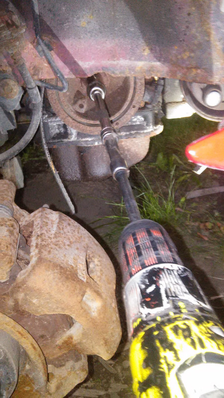

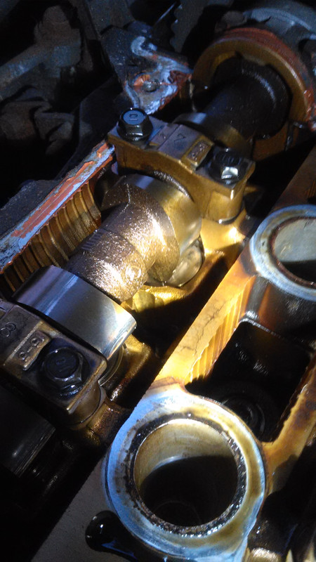

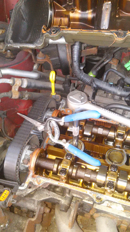

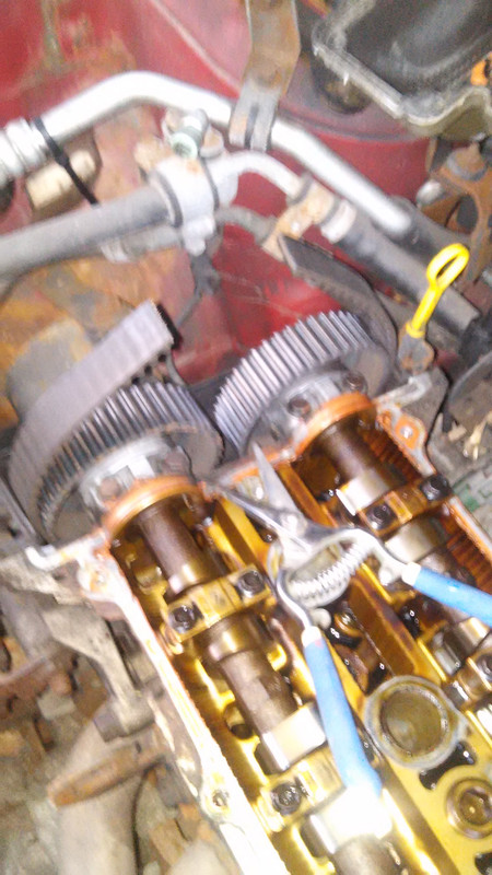

PS... I'm gonna give the interference another go...
I'm gonna put a drill on the two camshafts as well as the crank and spin them all up at different rpms, forward and reverse...
Any suggestions on how to get things to hit ??
It's been suggested that the interference is valve to valve not piston to valve... I'll try that too.
I want a big crash... The engine is shot anyway.. It burns more oil than gas...
It's getting pretty good mileage at about 30 mpg... (that's per gallon of oil).
Someone get a video clip posted - settle this once and for all ;)
I'm working in it dude but Photobucket wants $300 out of me and Postimage doesn't do videos and Tapatalk I can't figure out but !! Maybe I can release a few images from this site (which does have a limit) and try to post a video here on thus forum (which must be less than 'x' number of megabytes) then you can all watch my parts car spun up wildly with three drills on the crank, and both cams...
Wish me luck!! I'm hoping for all kinds of ungodly interference!!;
Youtube is free. If you flag it as unlisted when you post it, it won't show up in general search results but you can post the link here and it will take you to the video if you click the link.
