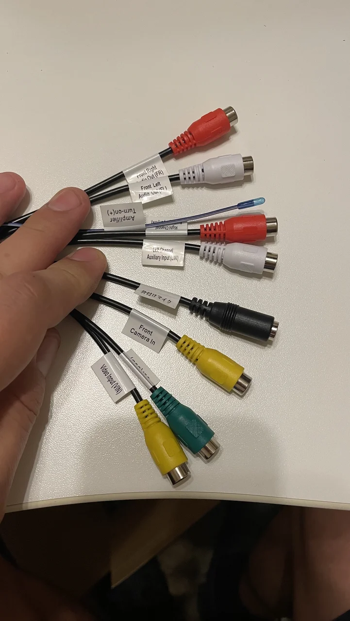

In my case, my atoto unit had a harness that also included the Front and left audio out preamp RCA outputs. So I could plug the RP4-MZ11 grey and white RCAs to them and didn't had to use any line out converters. Those two RCA outputs are not available on all atoto harnesses for some reason:

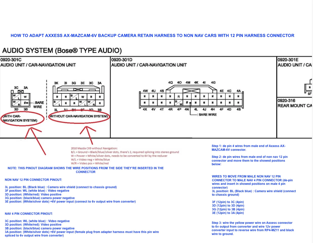

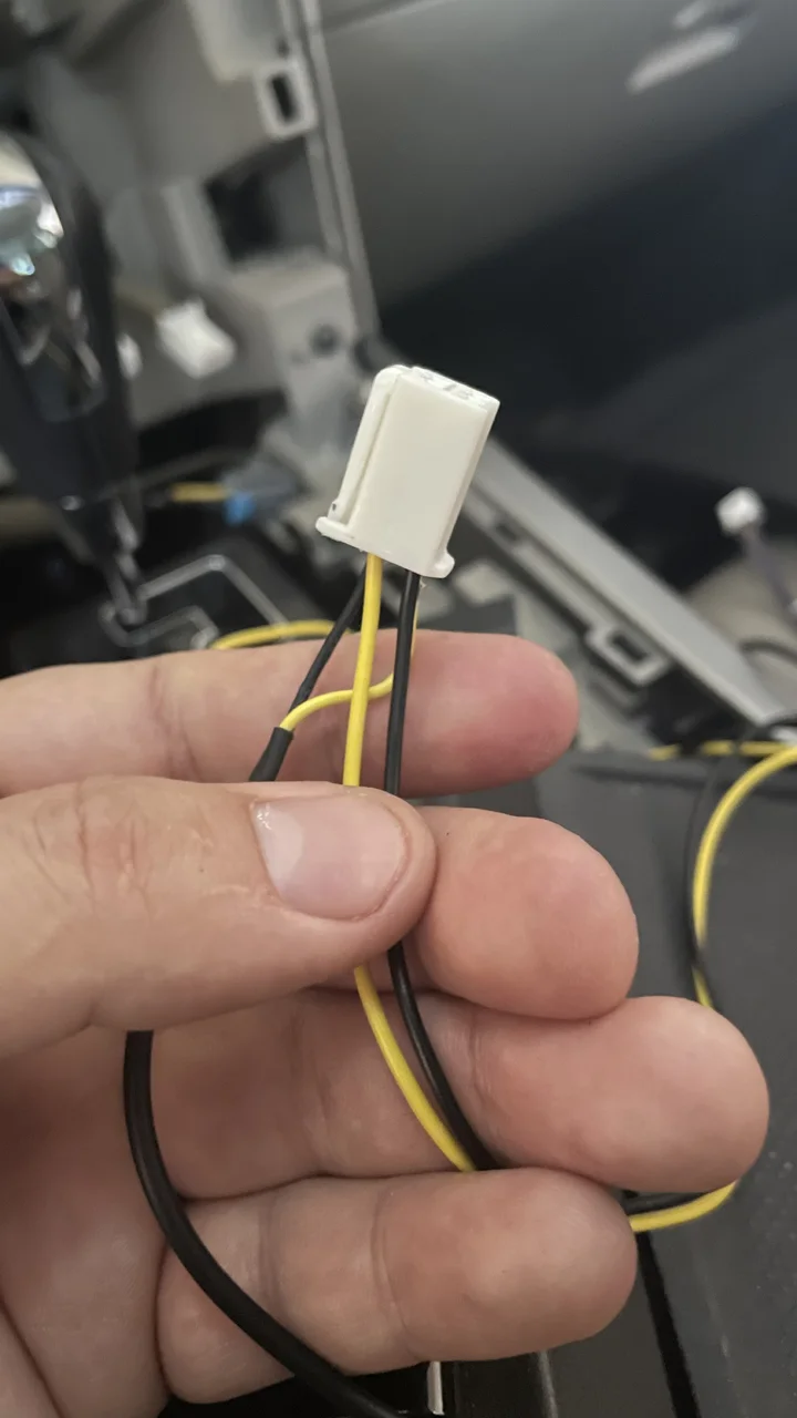

I wanted to keep the stock camera, so I got this camera retain adapter but I found that it was not plug and play in my case. The rear camera retain harness has 4 pin rectangular connectors that works for navigation units but didnt match my non nav camera wiring connector, So I had to research and find how to make it work. Fortunately, someone found the pinout for this connector and how to de pin the wires and insert them in the 4 pin male connector from the adapter: For this, you have to repourpose the male plug on the harness adapter so it ends like this: Original camera wiring from car -> male 4 pin connector -> female 4 pin connector -> yellow video out plug -> corresponding video in jack on atoto harness.
Original rear view camera connector for non nav radios:
De pining the wires to insert them in the 4 pin male connector:
This is how the wires have to be transferred from the original 12pin connector to the 4 pin male connector:
Important: The rear view camera works with a 6v input. So a step down voltage converter is included with the Maxxis adapter. The converter has 3 wires:
12v input (must be spliced to the green/pink reverse output wire so the camera gets power every time the car is in reverse.
6v ouput - This wire must be connected to the yellow power input wire on the adapter.
Ground - this wire has to be spliced to the ground black wire.
