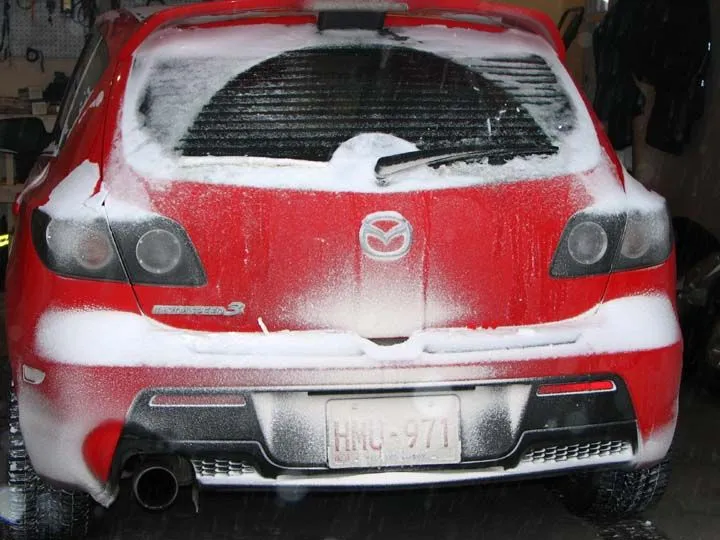

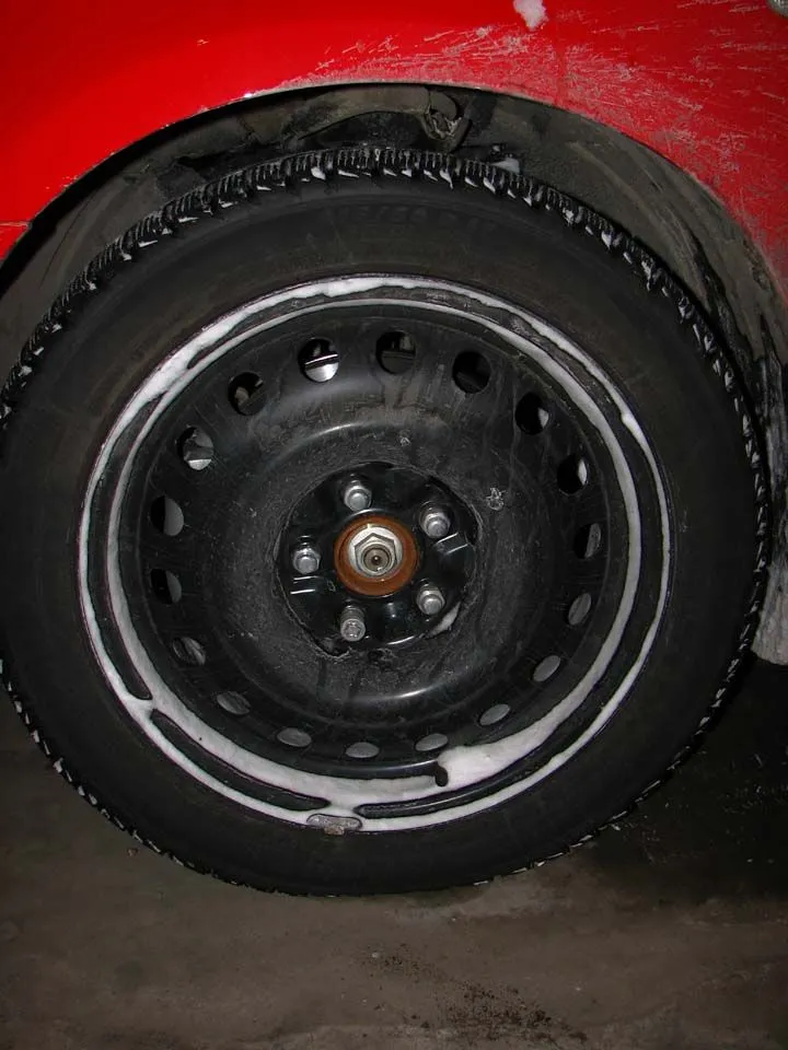

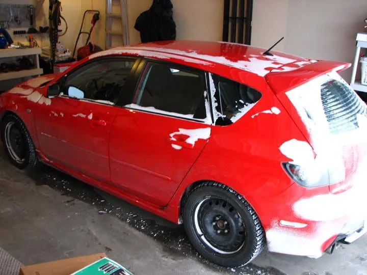

Yeah i have no light coming on.. Here are those pics
P5 barely moves anymore...
When you were at Costco did they have the fumagalli (?) 17" whells? On their fitment guide it shows that they will fit a regular mazda 3 which I believe is the same offset?
How much were the steel wheels at fountain tire? From the pic it looks as though they are 17", am I corect?
I am also in Calgary and with this recent bit of winter I am unable to drive my Speed3!!! :-(
Thanks
They had no wheels left at costco. Had to phone around.
Yes they are 17". Had to pay $95/wheel. Only ones i could find that would fit. Went to fountain on Northland. Pretty helpful in there. Tried to sell me on a high performance tire but i won't be going that fast in snow anyway. If it happens to dry up i'll switch out my tires myself. Only takes 20 minutes.
