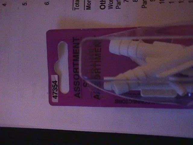

this pic was posted a while ago in a thread, whose ever pic it is thanks for letting me borrow it.
this is supposedly (i say that b/c i havent tried them yet) the box you need
Yup, that is the one.:)
