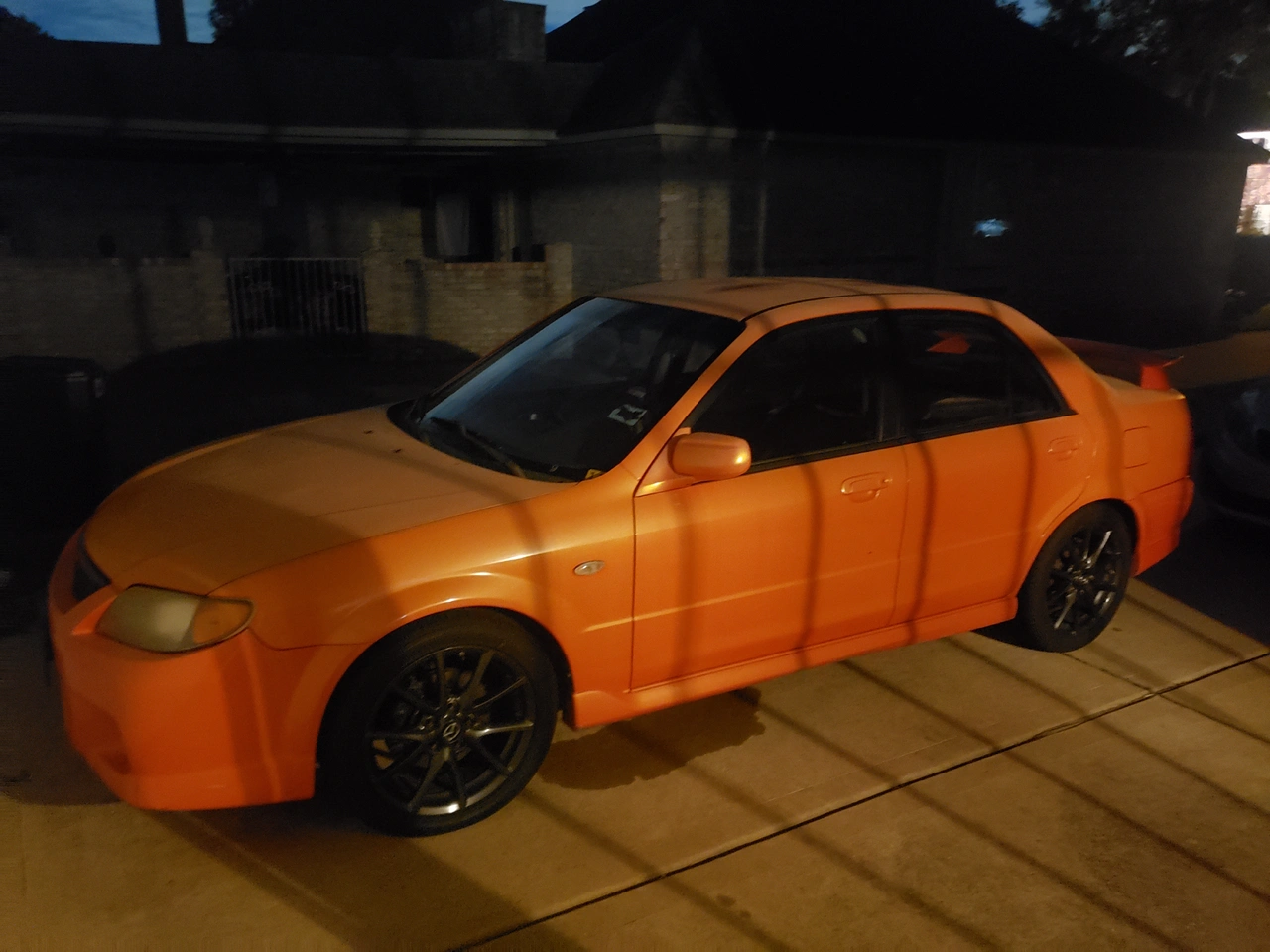

Welp, picked her up today. Feels like I just stepped in a time machine. I can't express how excited I am to have bought another msp. Well the MP3 was pretty much the same animal.
This is going to be fun. I'm going to document here, it dosen't seem as active as I remember but I know the greats will enjoy.
So glad I saved this relic. Operation revival 🙌

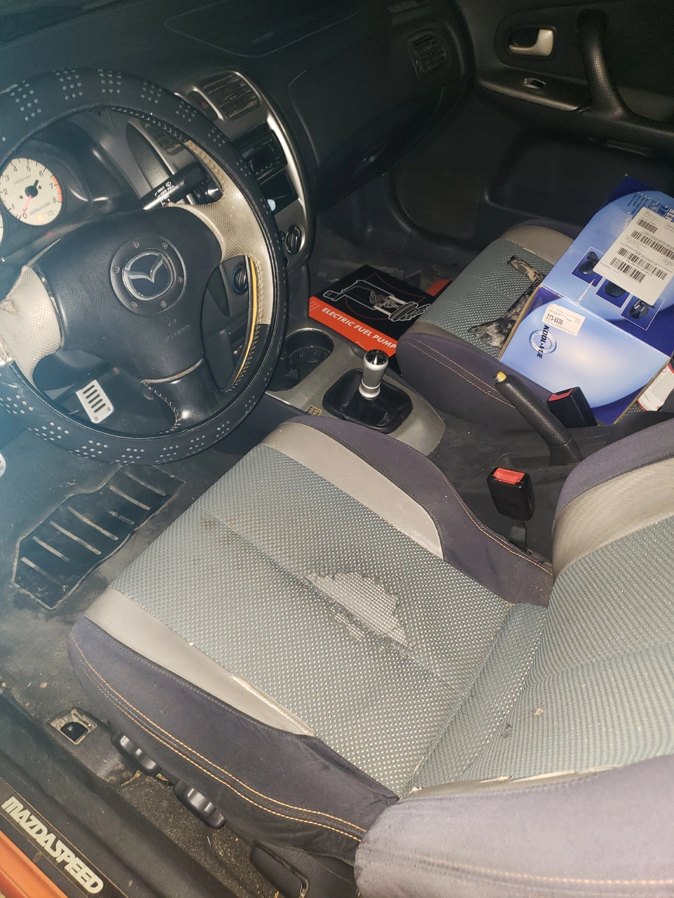

Yeah, she's a little crusty. The guy I bought it from said he would always see it parked behind this guys fence off a country rd. After 6 months passed, he noticed the guy sold the MSP stock wheels and saw it on blocks. He walked up to the dudes house and made an offer. He said an old guy owned it as a daily for work and the second it had an issue he parked it in his backyard. Sitting outside (Sad) he bought another car to replace it and parked the speed.
I'm really trying to find the MSP/MP3 OEM seat covers but have only find one with a little rip.
I really don't want to buy MS3 seats or racing seats. But I might be against the wall on this one.

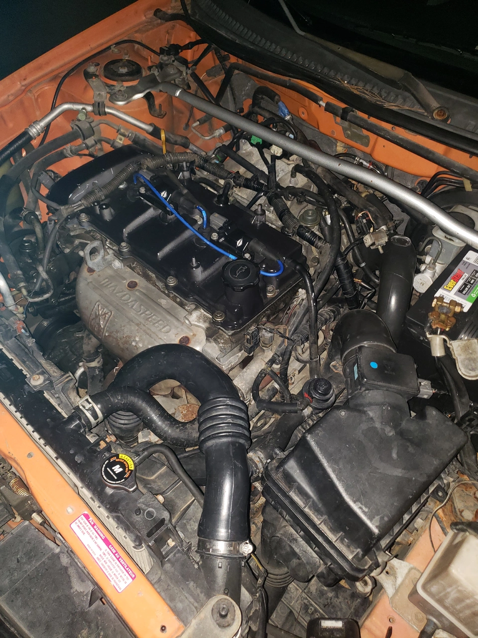

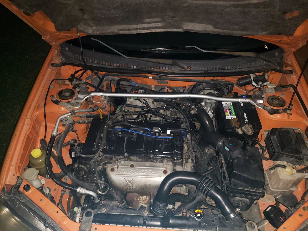

Blank Slate: Engine bay shots.
Buddy also had some oem paint. I'm going to need a lot more haha.
I plan on doing a compression test this weekend. Hopefully the motor is in good health and I can comence building.

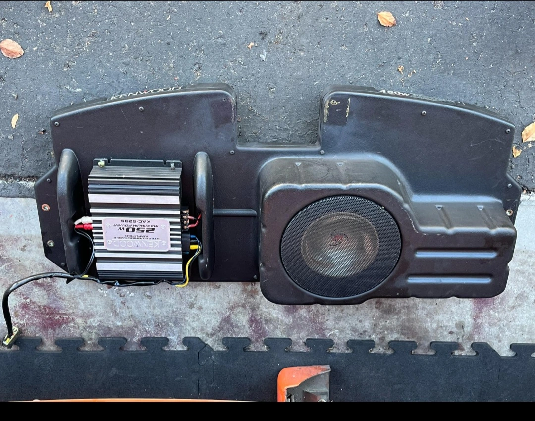

Since you offered. Do you by any chance have the Kenwood deck for the trunk?
Also, do you have the hard deck lid that covers the spare tire in the trunk?
I made a thread on the speeduino, you can get units that are 95% or more pre-assembled Guide: - Run your Mazdaspeed Protege on a Speeduino
I unfortunately only have 1 Kenwood rear deck unit that I am still using, I have a spare tire cover but it's definitely not in great condition, very warped from 20 years of heat/mositure.

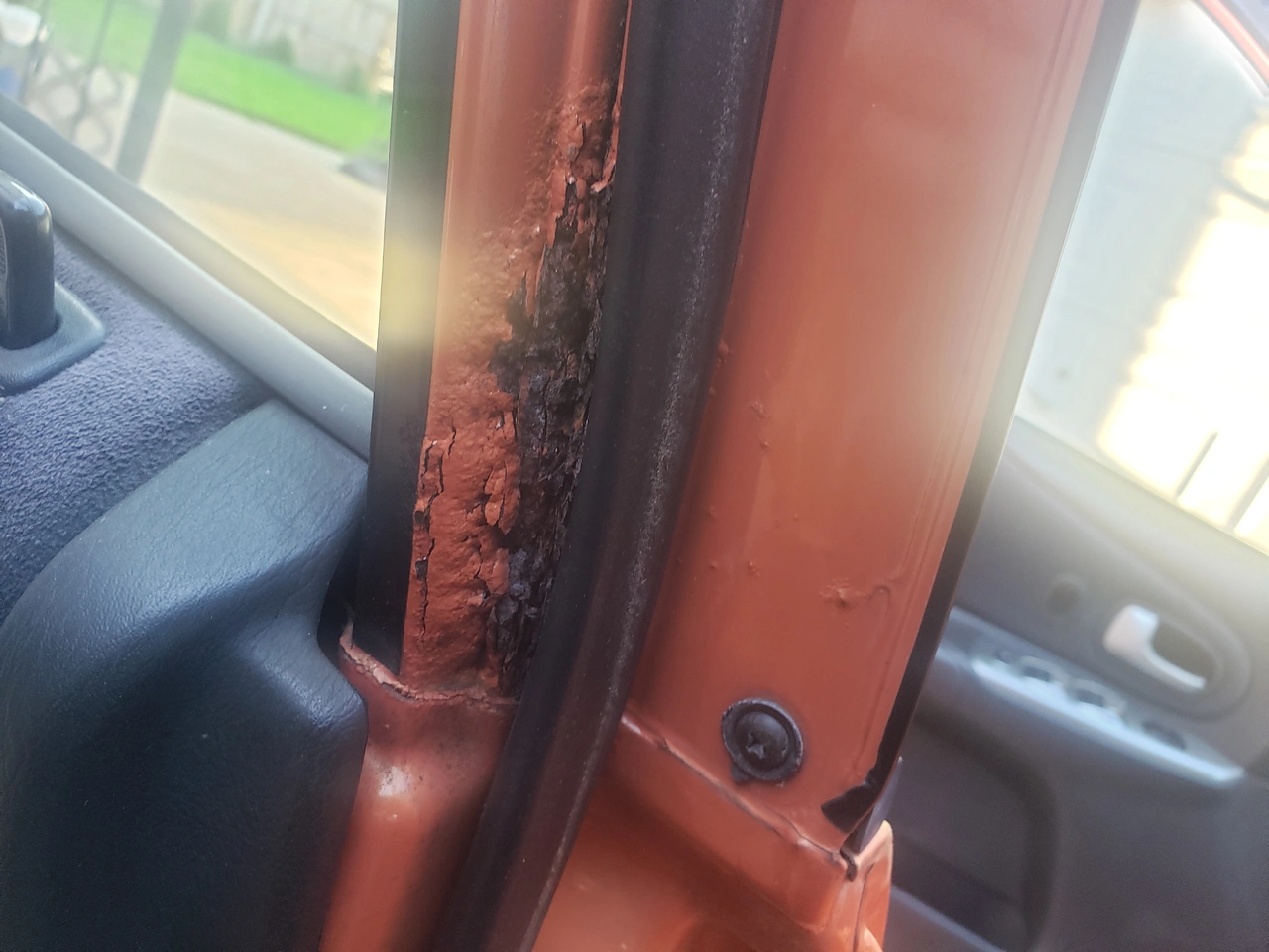

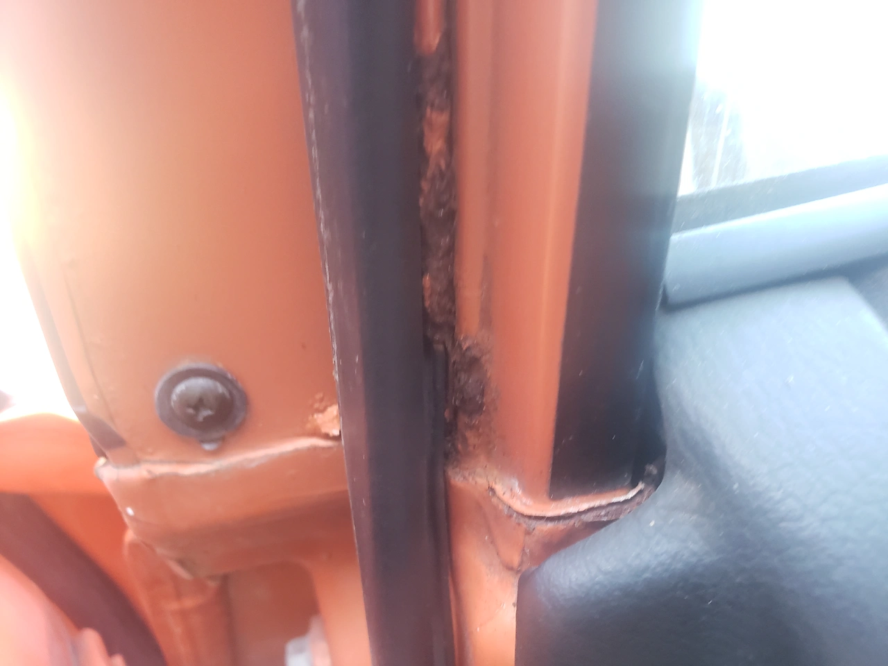

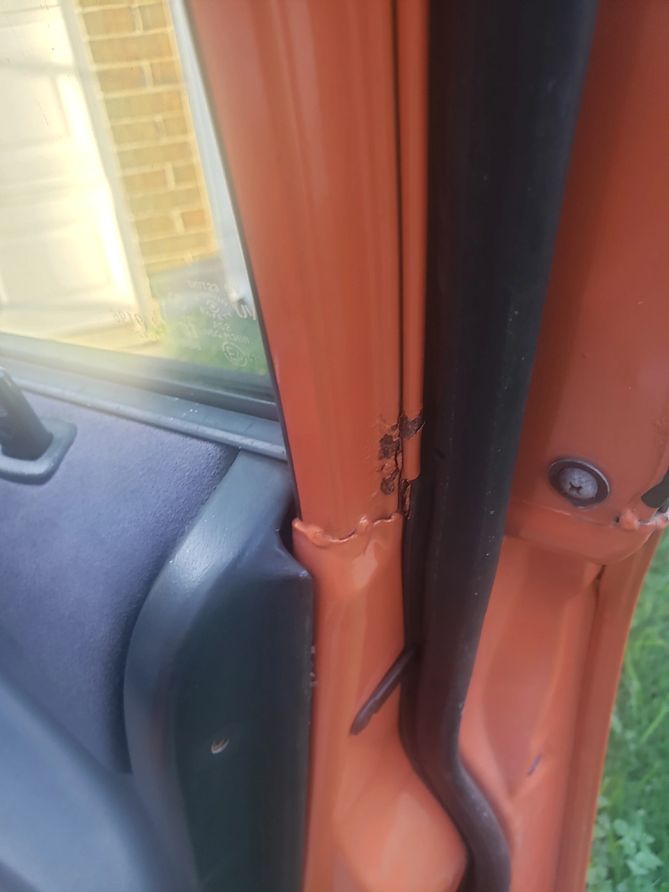

Welp, these are the only spots I found rust. I guess it could be worse. I'm going to need to take care of this nasty rust.
The car began it's life in California unfortunately.
Should I just grind out the rust and TIG weld new metal on it or try to source another door?
Just for the passenger rear door on the driver side. I feel like the other 2 doors shouldn't be too bad.
If you have the ability to weld, that's definitely your better option, less paint work and you don't have to worry about matching paint since it's not on the outside of the door. Black paint would even suffice.
Okay, yeah I'll just go that route. It will definitely be cheaper than having to ship a whole door from cali. I'm just slightly intimidated on the repair because where the rust is located but I'll be fine...I'm being lazy
Plus I have that little bit of oem paint so I could still try to match it. Throw some 2k clear on it and call it a day.

I did manage to scoop the whole Kenwood deck for the trunk! Didn't think I would find one so fast.

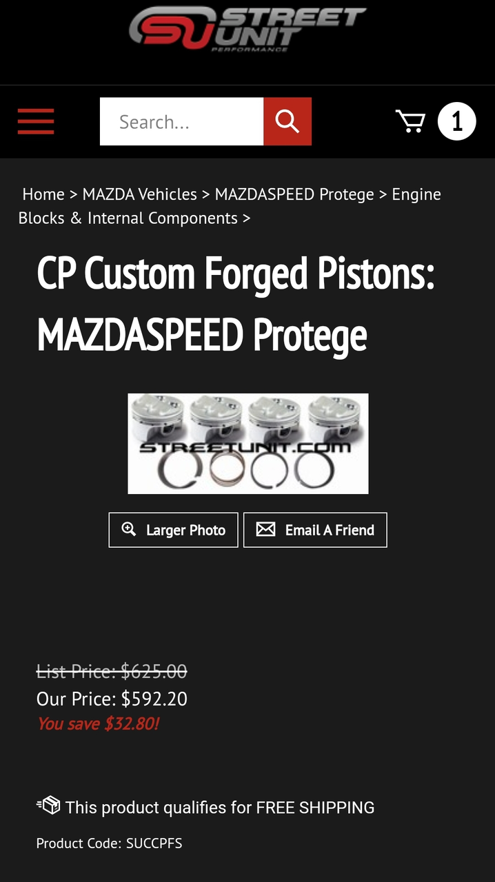

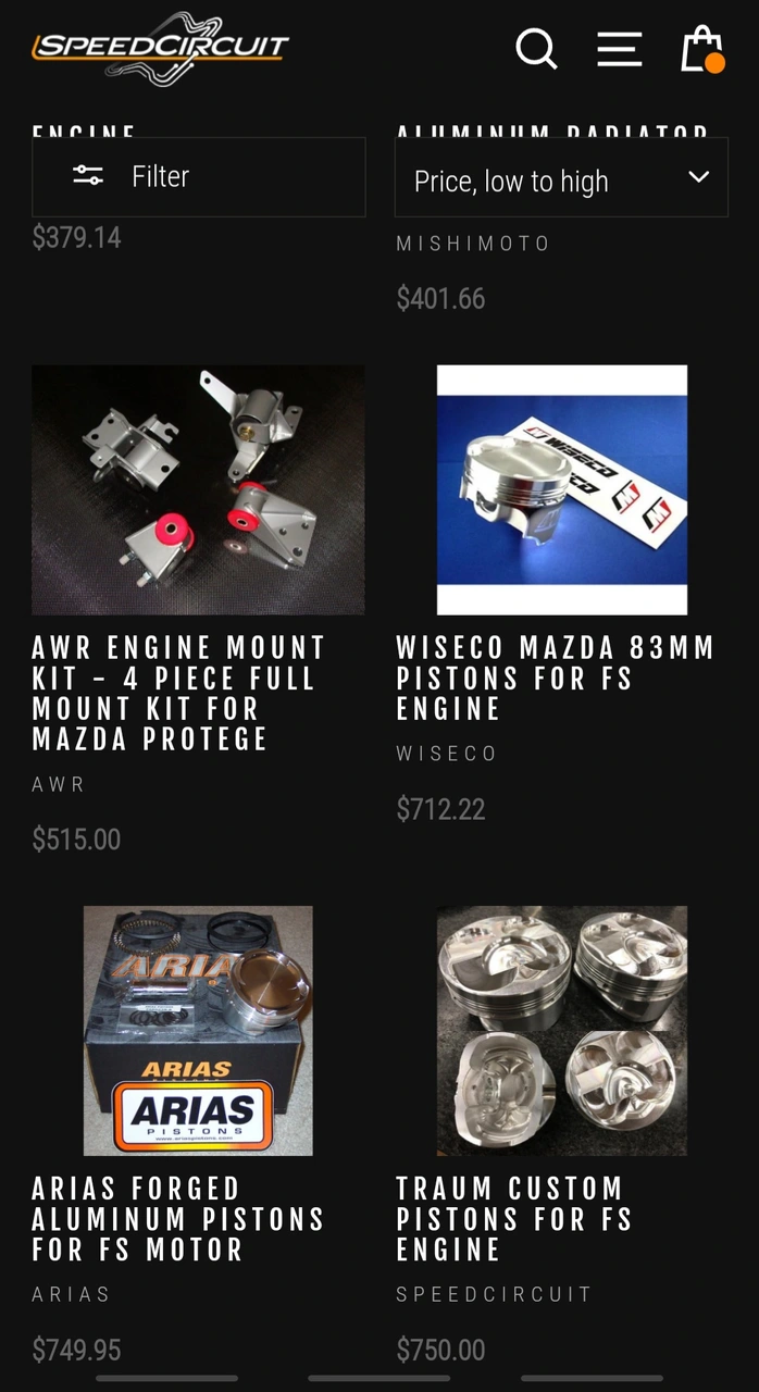

So I'm going with K1 Rods. I'm trying to decide on pistons. Does it really matter when it comes to these 3 brands Arias, CP, and Wiseco.
All seem to be pretty positive reviews and most fails look to be due to user error.
Any input on this would be greatly appreciated.
