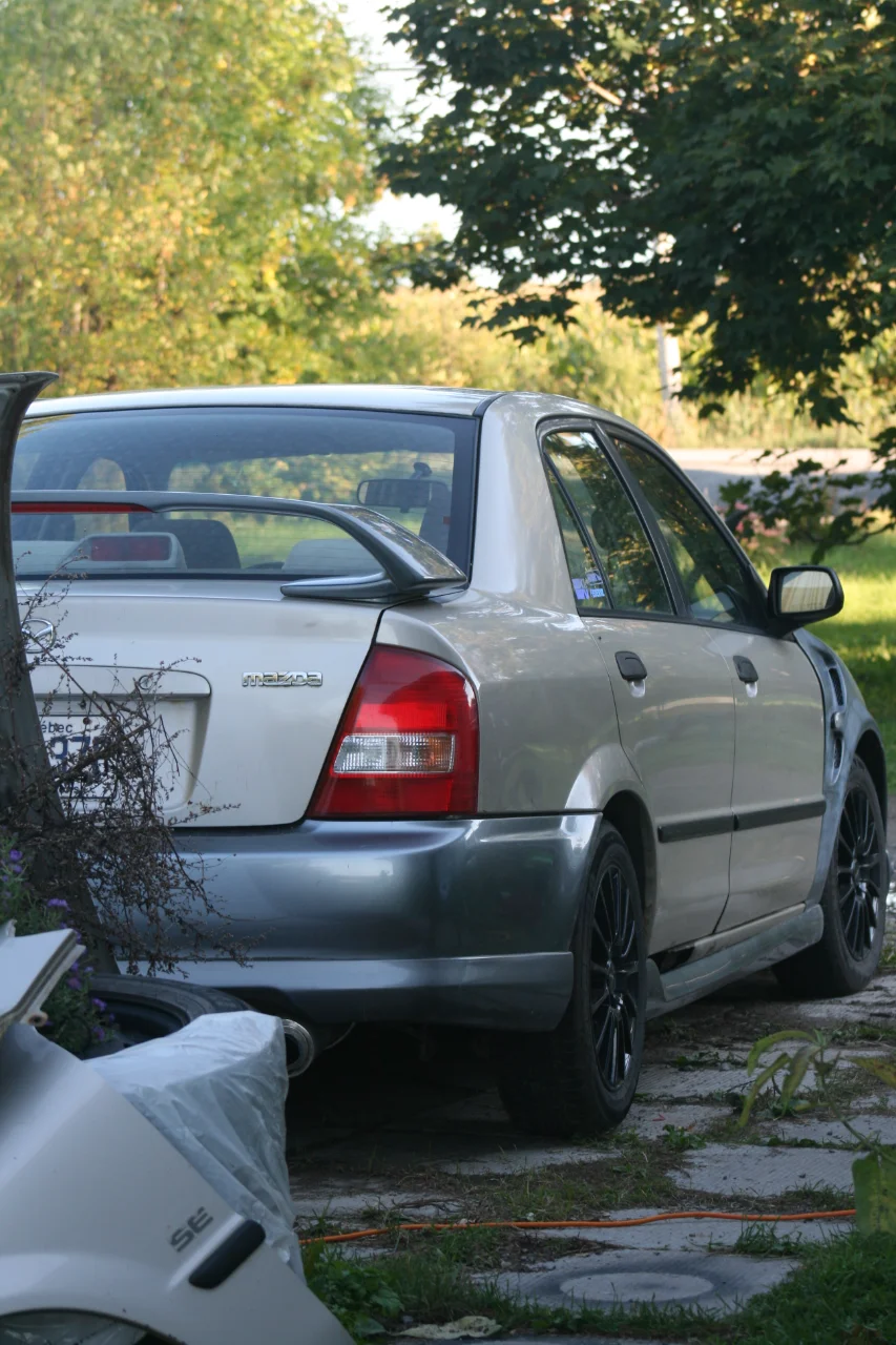

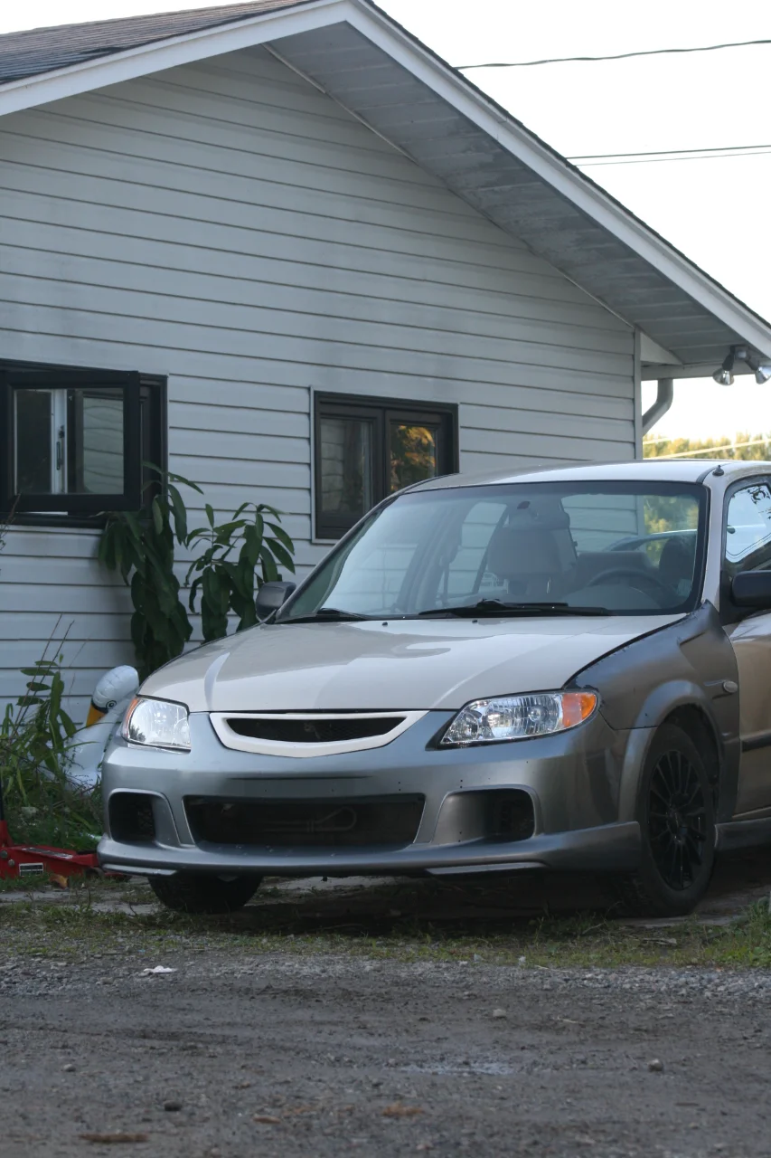

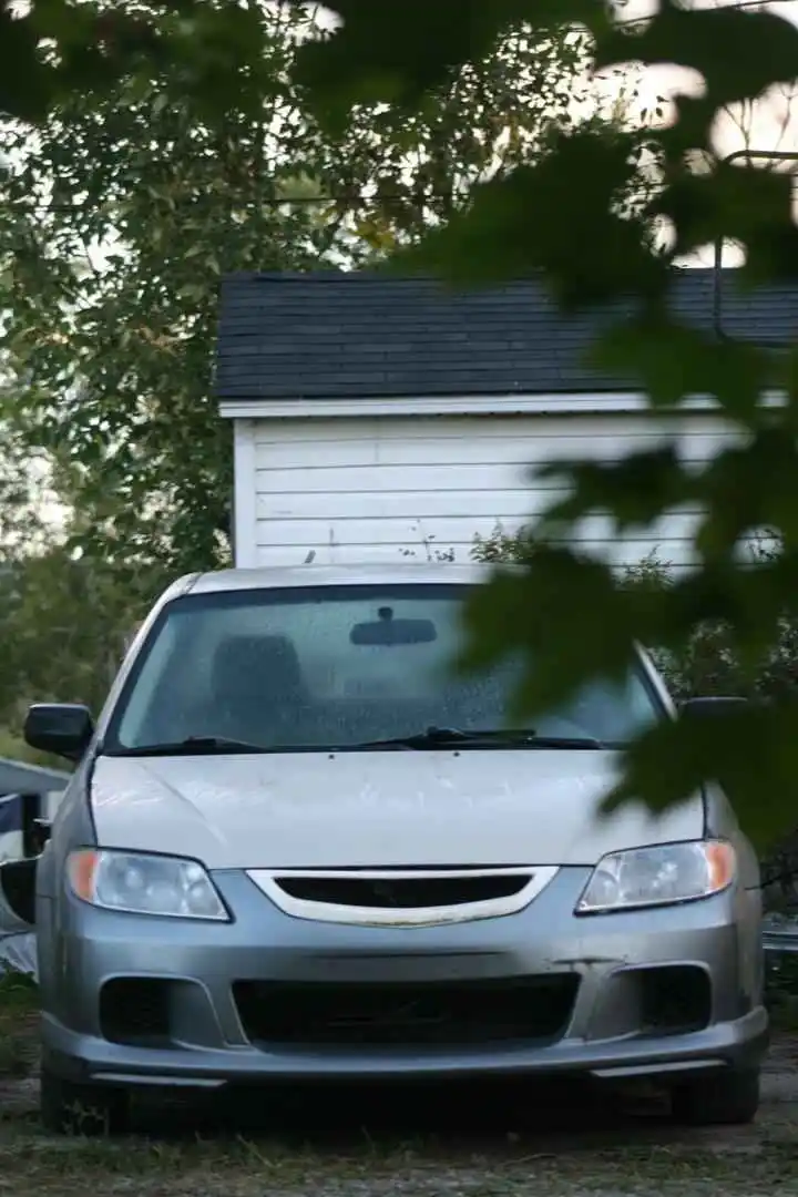

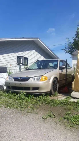

Got this car as my first car and as i was planning out the turbo build for the 1.6, i realised that the bumper didnt allow for much intercooler, my next step was to try to track down an part out mazdaspeed protege to rip parts off and frankeistein into mine.
the process of taking stuff off is pretty simple and only took me about an hour with minimal tools.
What is needed for the frontend swap is :
  • Hood
  • Both Fenders
  • Both headlights
  • Front Bumper
What i highly recommend getting too is :
  • Side Skirts
  • Rear Bumper
  • WANGG
Everything is basicly bolt in exept for side skirts and spoiler which those needs to be drilled in. Had some issue with fenders fitting but their old aftermarket fiberglass fenders so you could most probably avoid the hassle with oem fenders. I am HORRIBLE at wiring so i went with boring out the blinker hole to fit the bulb instead of the small light as an temporary fix until it causes an problem :whistle:.
If your looking to do this or similar on an budget but cant find an mazdaspeed, i recommend getting everything exept the front bumper from an protege 2001+ and/or an bumper from an p5 which in my opinion also looks great and is way more "accesible" than an msp bumper.
Im still in the process of slowly adjusting the gaps with time to get an better fitment and am painting it right now.
but to anyone looking to give their protege an lil update, i recommend the swap if you can source the parts. I love this car to death and the new look is making me love it even more, cant wait for it to be finally all painted.
Wasnt able to find much info other than in lil facebook groups and dming some people so hopefully this makes an easier to access rescource for this swap.

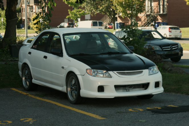

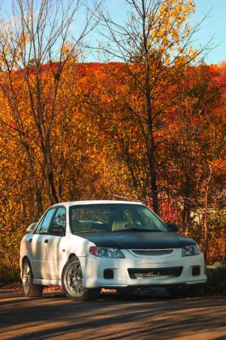

This is what the car looks like now. Its getting an full repaint in Red at some point but for now its been an whole lot of fun !
