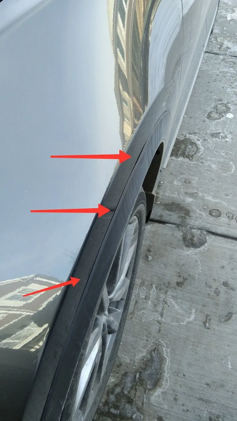

Here are pics of the gaps (same on both sides). The rears do not have this issue.
attachment.php

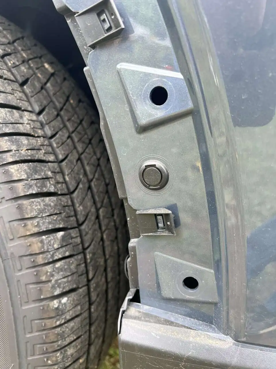

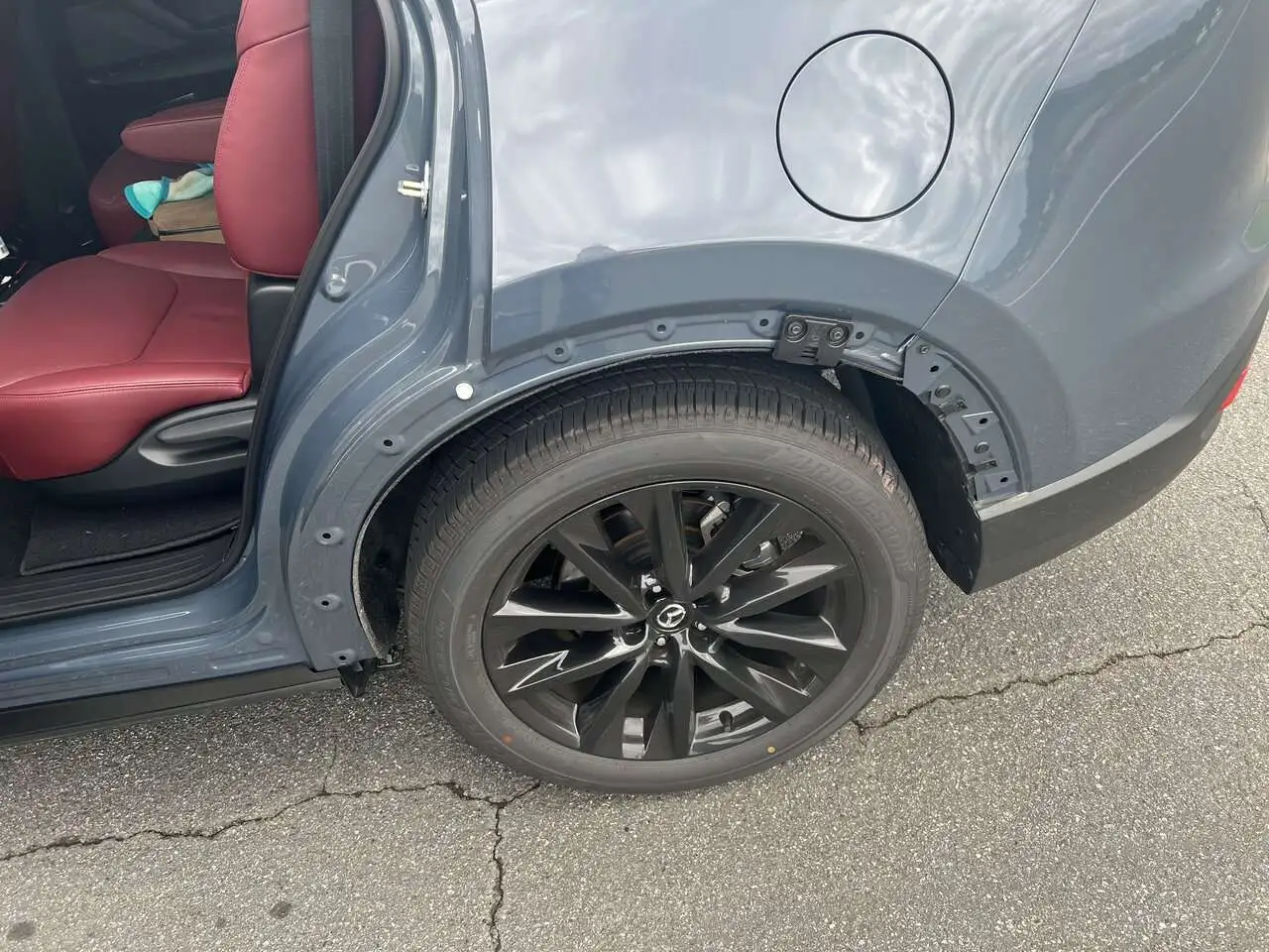

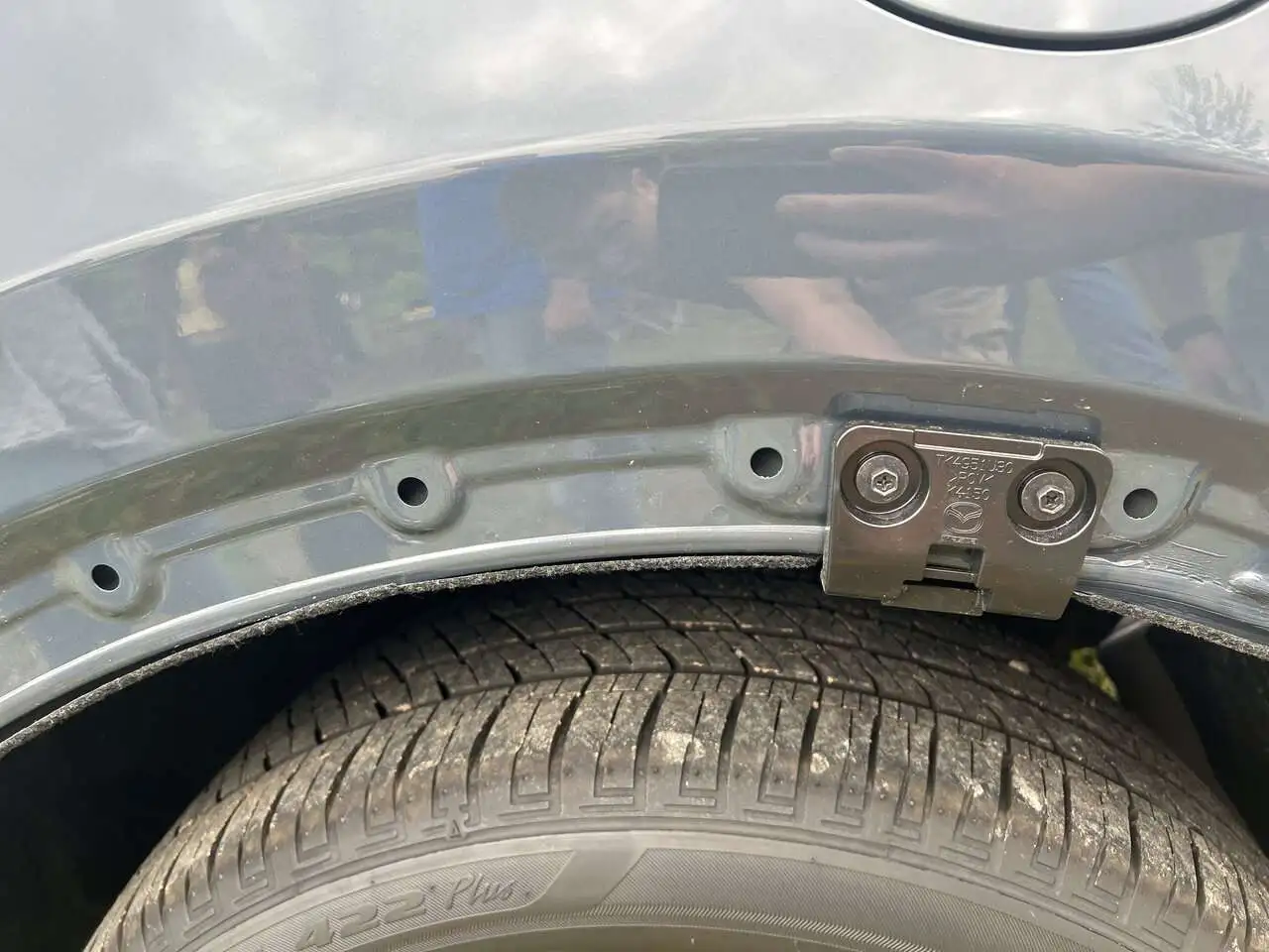

Wife just purchased a 2022 CX-9 Carbon edition. Only a week of driving and while on the highway, 90mph, out of nowhere the driver rear fender flew off. Nothing in the road, didn’t hit anything, just bam. Wasn’t sure what happened at first until I pulled over to find the fender missing. Here is the thing. See the photos. It looks like only three fasteners we’re holding it in place. One fastener staid and only two of the holes have circle markings where fasteners were.
Stealership said they will take care of it but blamed me for hitting something. Say they see it all the time and it’s always someone hit something. That tells me this is a common issue but they don’t want to accept responsibility.
Yeah. Amazing they use that line. Looks pretty clean to me. If hitting something at highway speed, as it slid along the car as it was a being pressed against the car, it would have left some damage to the paint. That thing plumb just fell off.
Trust me, I know I didn’t hit anything. I drive slammed modified cars so it’s habit to watch the road ahead of me. Waze had tire debris in the other lane I passed miles prior. Service guy said, without even looking, you hit something, I see this all the time in my 20 years of working. I got so heated. You can see most of the holes never had retainers.
Check this video out from the dealership service department. https://tvidnow.com/73v5dqw This is crazy as you can clearly see the holes that have markings that had retainers which is only 3 out of the 12 holes! Yes, it would have held in place just fine had it NOT been missing the majority of its retainer clips.
