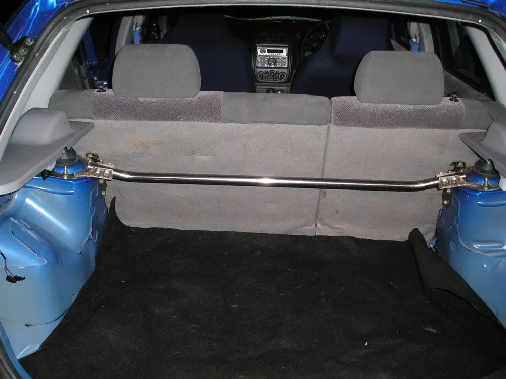

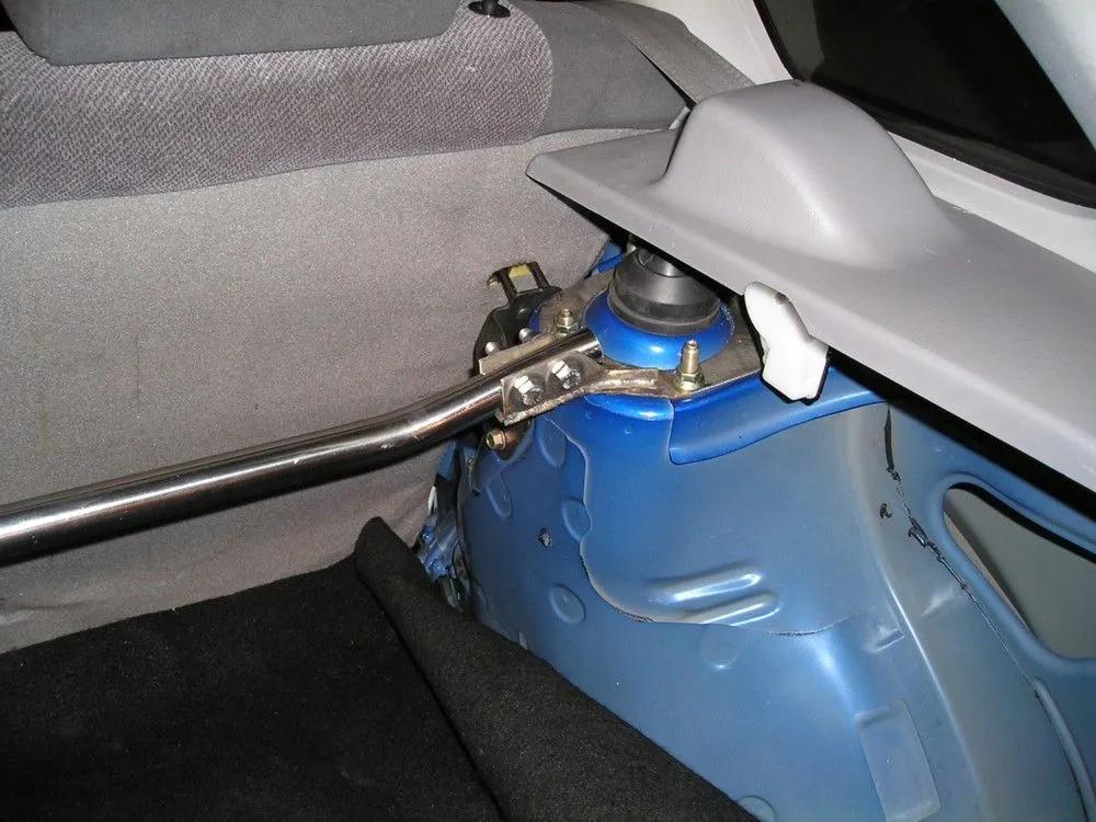

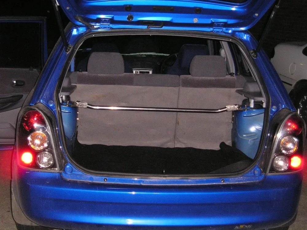

Finished
Well I've finally finished my rear strut brace, came up pretty good, check it out in the pics.
Thanks guys.
Susamafone: I'm not going to leave it like that, I will eventually get around to cutting a hole in the plastic panels and put them back on, at the moment I'll just have to stick with the race look, cause I can't be stuffed dealing with the panels!

tengoestetempo said:
that bar looks alot more steardier than the ebay ones
The bar itself is a piece of stainless steel tube, 25mm in diameter, with 1.5mm wall thickness, you should be able to buy it from your local steel merchant. Cost me $15 australian for it. Bargain I thought!
then where did you get the circle things that tie to the rear struts?
I made them myself out of a high grade stainless called incoloy. Through work I have access to a plasma cutter and a TIG welder, and a mate got me the material for free.
