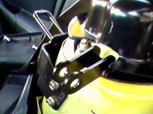

FinalResort said:
I wouldn't get that one if I were you. It looks a bit berlier but you would have to do way more modding than you would like. You would have to cut a way bigger hole in the plastic side panels to make room for that rise and you would have to cut a bigger chunk out of the seat belt possitioner. here is a pic of what I had to cut out of that piece.
That black dome looking thing possitions the rear seat belts at the right angle so they won't snap your neck or anything in an a crash. And here is the hole I had to cut in the side plastic
You don't have to cut the belt tensioner, just bend the lip up with a big crescent wrench then knock it back down to the bracket after installed. Measuring the side panels would allow you to cut a little square hole in the panel so no big open hole around the brackets. And the ebay bar allows for you to rotate the bar & tighten itself up in the mounting brackets pushing against the strut towers before tightening the lock nuts down. All issues now non-issues.
Well you can bang the crap out of it but IMO it is way easier just to cut it. That way you don't have to worrie about if the belt tensioner is at the right angle or not, if its not the plastic cover will not fit over it right. Plus you could damage the strut bar bracket banging on it like that. It was pretty easy to cut too. I just took a jig saw with metal cutting blade on it and it cut through it like a hot knife through butter.
i dont have anybody that rides in a booster seat or anything like that so do i still need to cut that black peace out?? and its okay if i have a bigger hole in the back idc its not a show car and its gonna be just me driveing it in a few months
Yah I would cut it if I were you. It doesn't really have to do anything with a booster seat but puting the shoulder strap at the right angle it needs to be so it sits on the right spot on your chest so the seat belt doesn't injure you in a crash. Its really easy to cut if thats your hessitation. Just barrow a jig saw if you don't have one, clamp down the piece, and cut it. It only takes a couple minutes and its well worth it for the safety and for the fitment.

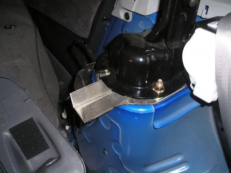

Me personally, I don't like the idea of modifying the seatbelt dome/holder, whatever it is, so I fabricated my own strut brace that fits under the belt dome thing.
This pic is obviously before it has been welded together, but it gives you an idea. For safety reasons you shouldn't be modifying something like that.
Nice idea, will you be buying the corksport bar? I'm guessing this because you're bracket is pretty wide.
As far as the cutting/bending of the seat belt bracket, I don't see this as a problem...The bracket is pretty thick (I remember standing on it and it held my weight), I cut it pretty easy with a cut off wheel (using a hack saw would take forever) and it's pretty thick, also the bracket is held by 2 of the bolts, not all 3...I think the most important part of the bracket is where the seat belt slides through.
I guess if it's important for that bracket to stay intact, why not grind down the STB bracket (so the seat belt bracket fits above it) and reweld it for strength? There are 2 small tack welds on each side, grind down the tabs, and reweld it for support? Like my sig says..."the cheaper the mod the better"

I won't be buying a bar, I'm using a piece of 316 polished stainless tube, 25mm (1") in diameter, 1.6mm wall thickness. It's what i've always used when i've made my own strut braces.
Your idea about modifying the strut brace tops is a good idea, I'd rather modify them, than the seat belt holder thingy.
