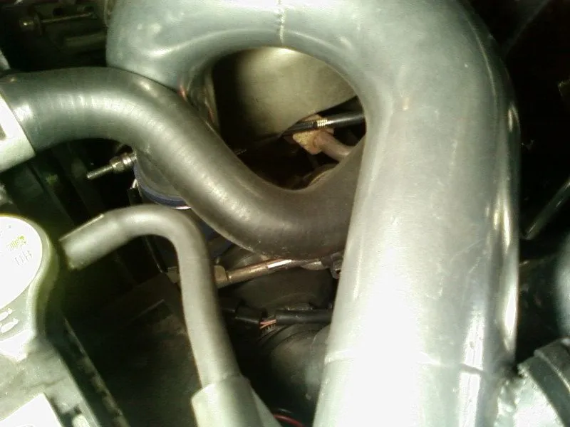

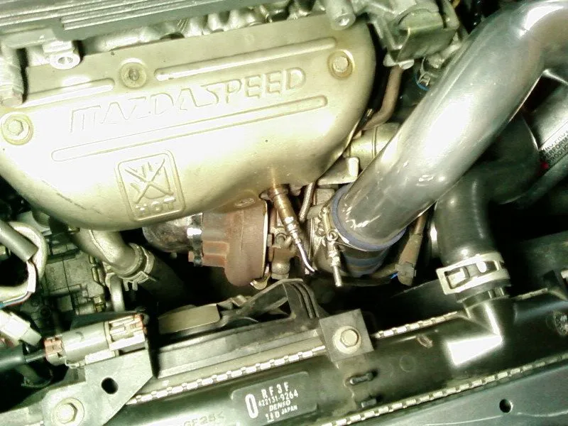

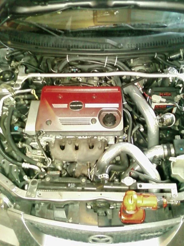

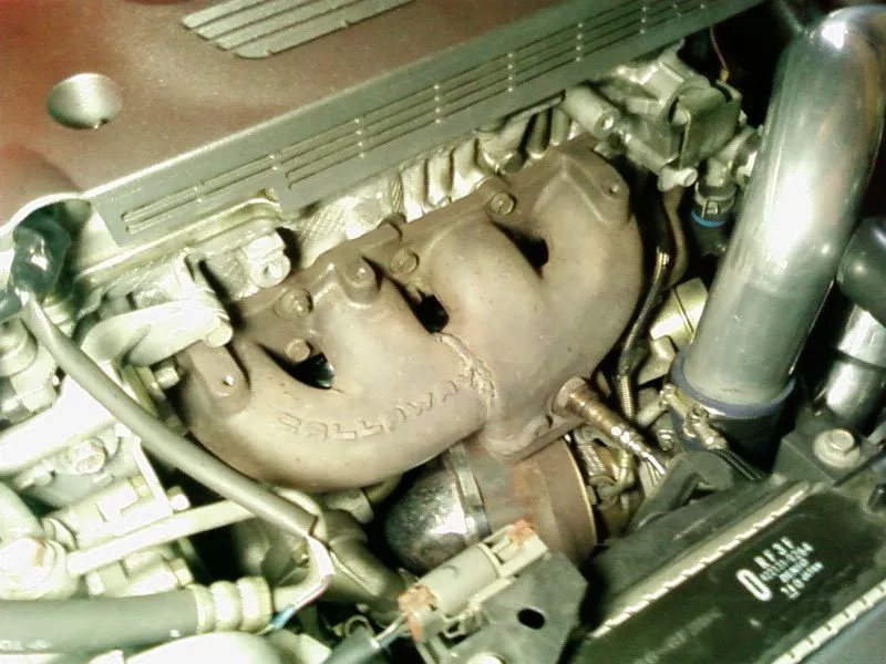

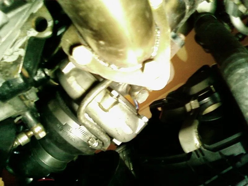

Mazdaspeed2oo35 said:
do you have a picture of your GT28RS on the stock callaway mani ? i would love to see how it looks
Awesome that the GT28RS its Bolt on the stock manny, why did you manny cracked ? are you using EMS ? how mani psi are you boosting ?
yes its the GT28RS bolted on the stock many. I'm not sure how the mani cracked. when we went to installed the GT28RS we noticed it when we took the heat shield off.
