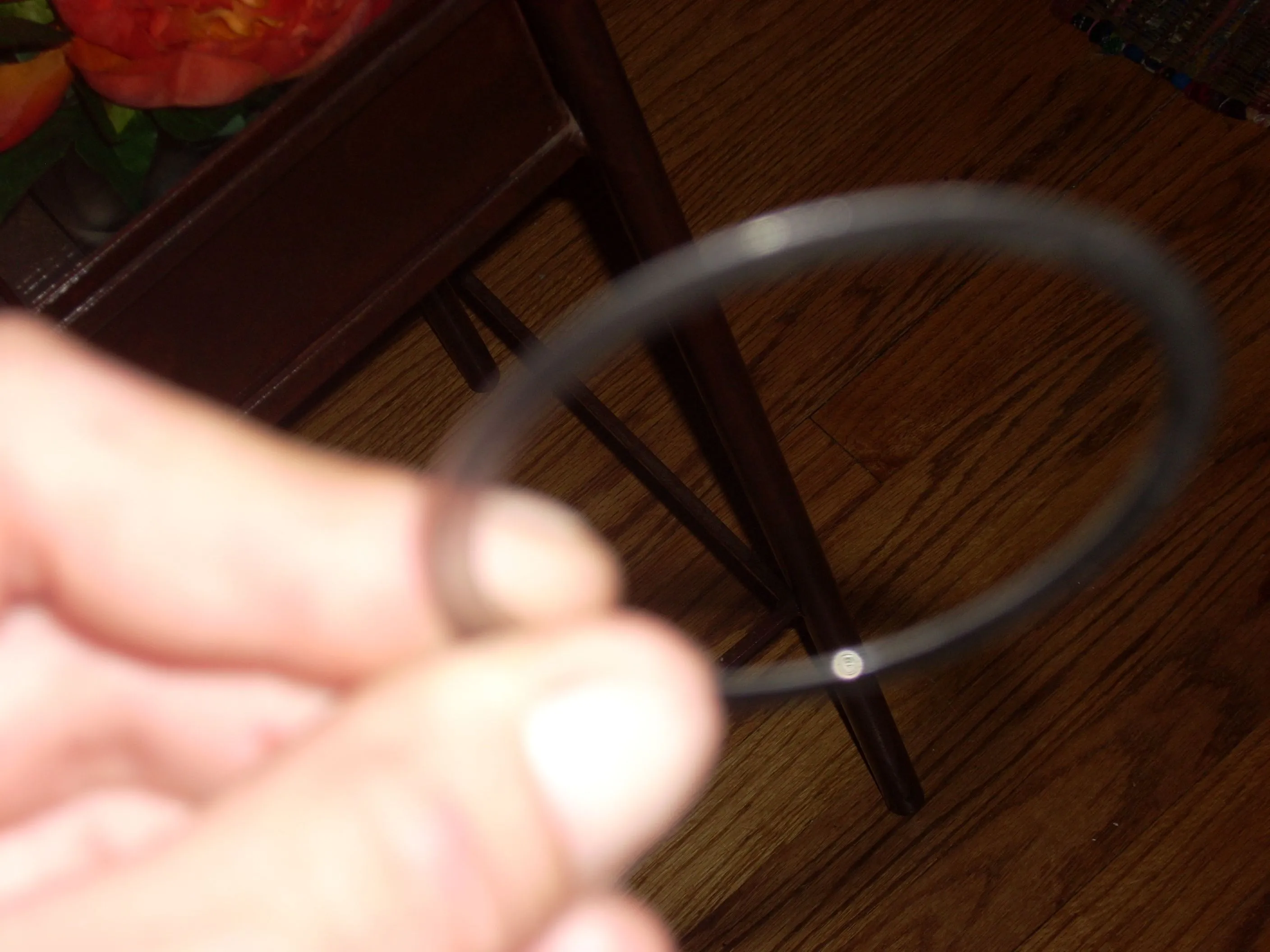

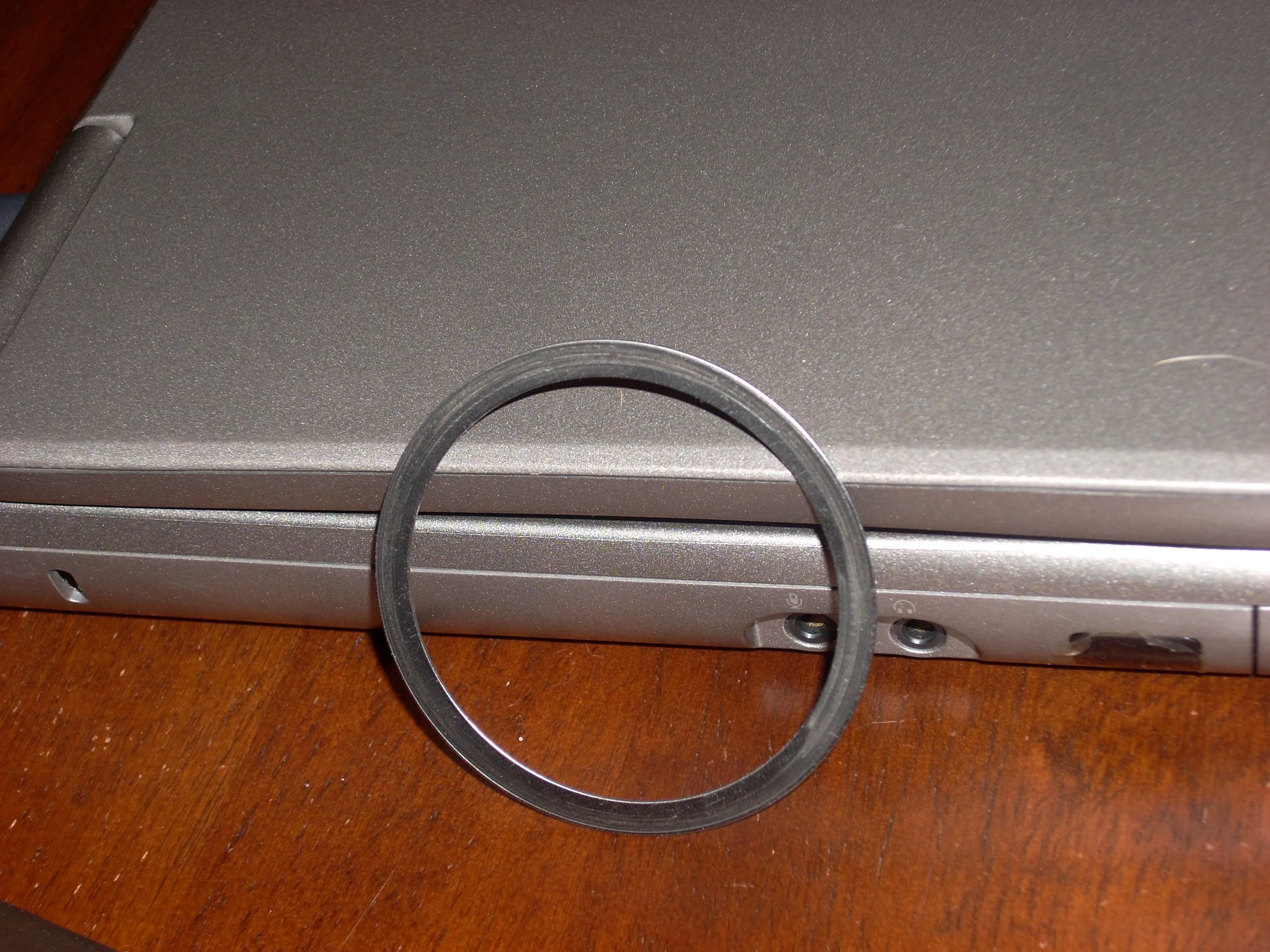

This ring fell out of the case, i think, when i pulled it apart, do you know where it goes? Also, looking at the differential i pulled out (non LSD, original) the speedo gear does not appear to be modified and the carrier bearing has a gap between it and the speedo gear. Looking at the LSD that I will be installing, the shaft where the speedo gear and carrier bearing mount seems to be the same length and there are the same two recesses as the one mentioned in the last sentence, So why should the speedo gear be filed?

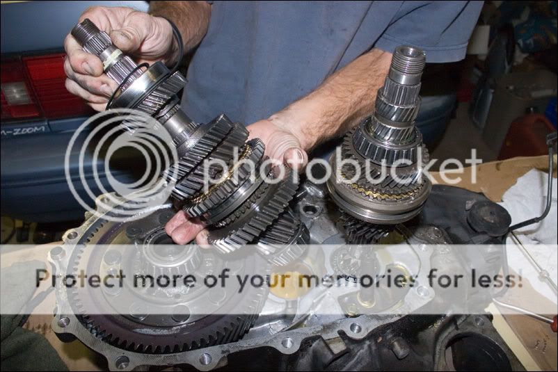

im not positive where that ring goes but a quick look though the pictures i saw this. at the top of the shaft the guy is holding there is a ring so check to see if you still have that ring
Now we can remove the secondary shaft. Lift and tilt the differential, then tilt and pull up on the secondary shaft to remove it. Pay close attention to any washers or rings and keep them in the proper order.
