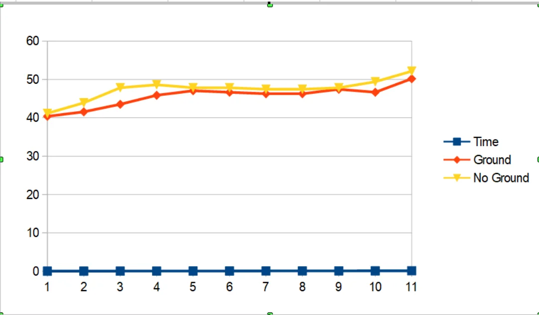

I have found measuring engine load over a set course on CC, same speed, same day. I use Torque Pro app and email a CVS file to my computer. I pick the same point on the list for each test and graph them on a spreadsheet. Engine load vs. time.
I found with grounds the engine ran the course at a lower engine load than without grounds. Thus the engine was making more power or running more efferently.
One could pick fuel other PIDs. I found engine load a good overall test method.
I used this test method to modify my 5.9 Cummins for better FE. I tested each modification this way. Some mods were duds and others surprised me that the factory design was better than mine! LOL After doing this test method to prove mods we move FE from 18 to 30 MPG over a controlled test route TWO times. Note that it was a stunt to get the best FE. Driving, speed and geography were picked to optimize results. Real world is around 26 MPG over 1200 mile trip.

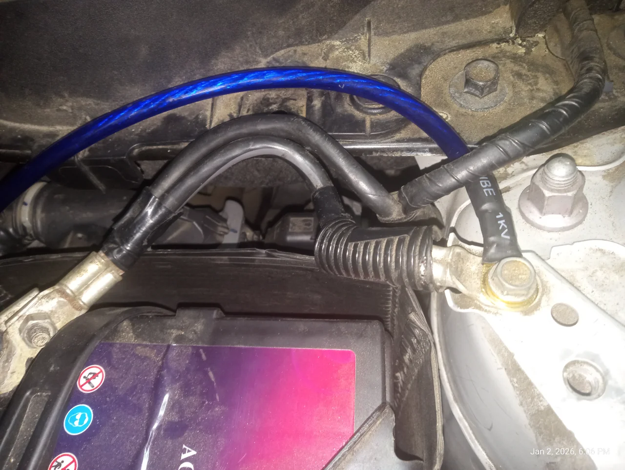

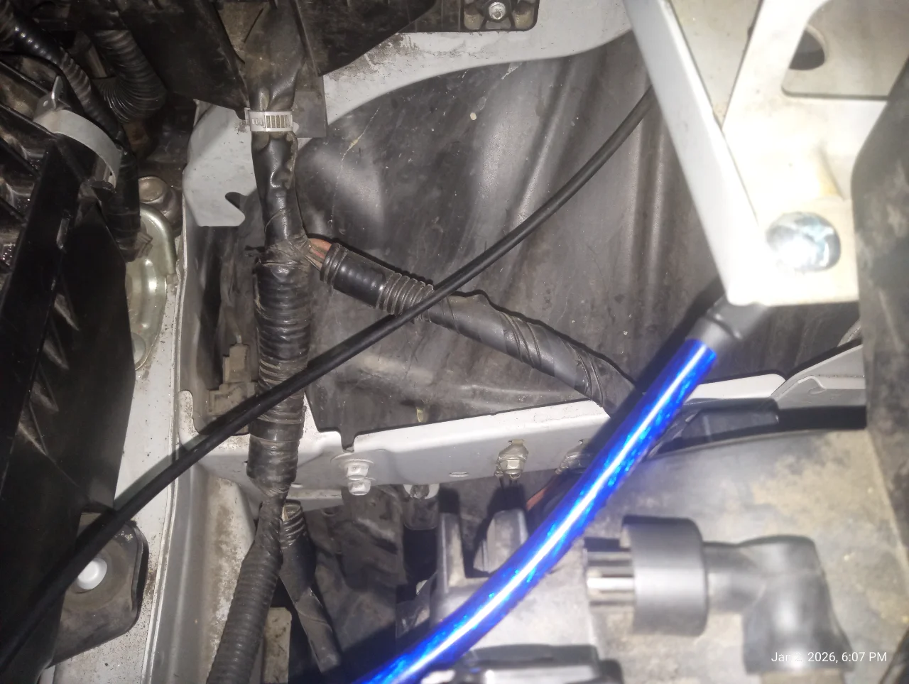

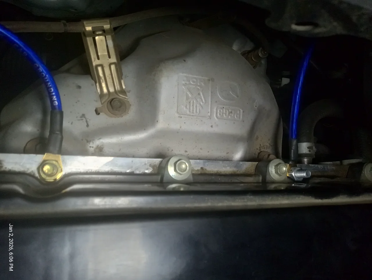

Got three wires now, two from the cylinder head (using existing holes) and one from the 5th bolt on the throttle body. Read somewhere else about folks grounding from the coil packs, but the bolts on my coil packs seem to be fasteners only... Further reading indicates that there are different cables (one spade end) for coil pack connectors.
Would like to get two more in there. 😄
I understand that bare metal offers the best conductivity. I wonder if the factory grounding brackets are "less" painted than the chassis/exterior. It could be just a layer of primer. I painted some NA rims before and the metallic primer is like this greyish white.
Had no idea what the two holes on the back of the engine are for. Hooks and chains to remove the engine? 😬
Nice install!

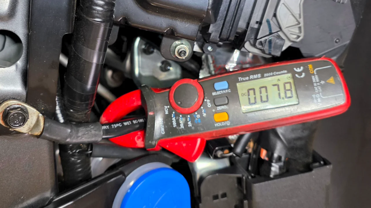

Those should be good ground connections. If you own or have access to a clamp on amp meter it will confirm your install. This is a handy item to have around the house...

I clamp the meter around an installed ground, start the car, turn on the headlights, HVAC fan on high and read the meter. If it's around 1 amp, then that's not the right connection point.

Here is an example of a steady state test using % engine load. Less engine load to move the car over the same stretch of road at the same speed = better efficiency or more power.
At point 3, this is when the car has to pull hard to go up a steep hill at 50 MPH. You can see how the grounded car, red line, engine load didn't increase nearly as much as without grounds.
In hind sight, it would have been more dramatic if I had run my tests from 750 RPM to 2000 RPM at partial throttle. To do this is more difficult. Looking at the WOT dyno graph of a Gen 3 Hemi, it make most of power at low RPM. So in stop and go traffic, a grounded car will either be more peppy or more FE. It ALL depends on the operator.
This is NOT a home run modification. More like a single. It has a payback in 1 to 2 tanks of fuel and keep saving mile after mile, year after year. I put these on and forget about them. If it save the owner about $200 per year, that's almost a nice dinner for two.

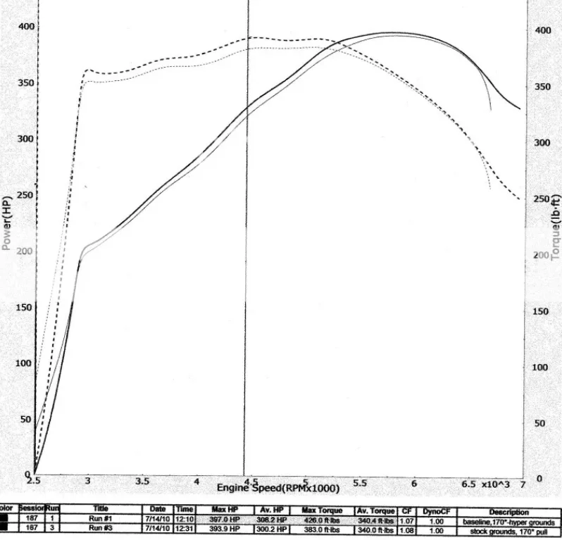

On below dyno graph the top line is the grounded engine at WOT. I made most of the gains at a low and mid range RPM. We ran this test many times and got the same results. We rented different chassis dynos to see if it was how this make and model calculated HP. Same results on other dynos. Interesting, HP or FE gains is about the same across the board on all makes and models, 8 to 9 HP.
Average HP needs to be ignored because the dyno operator didn't go to WOT the same on each test nor end the test at the same rpm. He could have only shown from 3000 to 5,500 RPM.
From 3,000 to 5,500 RPM shows how a nice increase from just from some cables! It would have been interesting if the test had started a 2000 RPM. Problem with going to WOT on a dyno at low RPM it puts a tremendous strain on the engine. My guess, at 2000 RPM the gain is more than 9 HP.
Top two "flat" graphs are torque, the other graphs are HP.
Thank you! With the clamp on meter, is 1 amp too low? A better connection point would read higher? Can I use this one with probes? Got it when I had electrical problems in May.
When I monitored engine load in the past, the value was constantly changing. I recall that between the options of actual and calculated engine loads, only the latter returns a value. Are there any other values that I can check via OBD/app?

Yes, above 1 amp with the mentioned items turned on. I'll measure our CX 5 today and post. It's been 22 months since I checked it.
Yes engine load is constantly changing. My method:
Driving and logging on CC, same speed, same road, then load the data in a spreadsheet. Graph each run and compare. Tedious but I found this to provide reliable results.

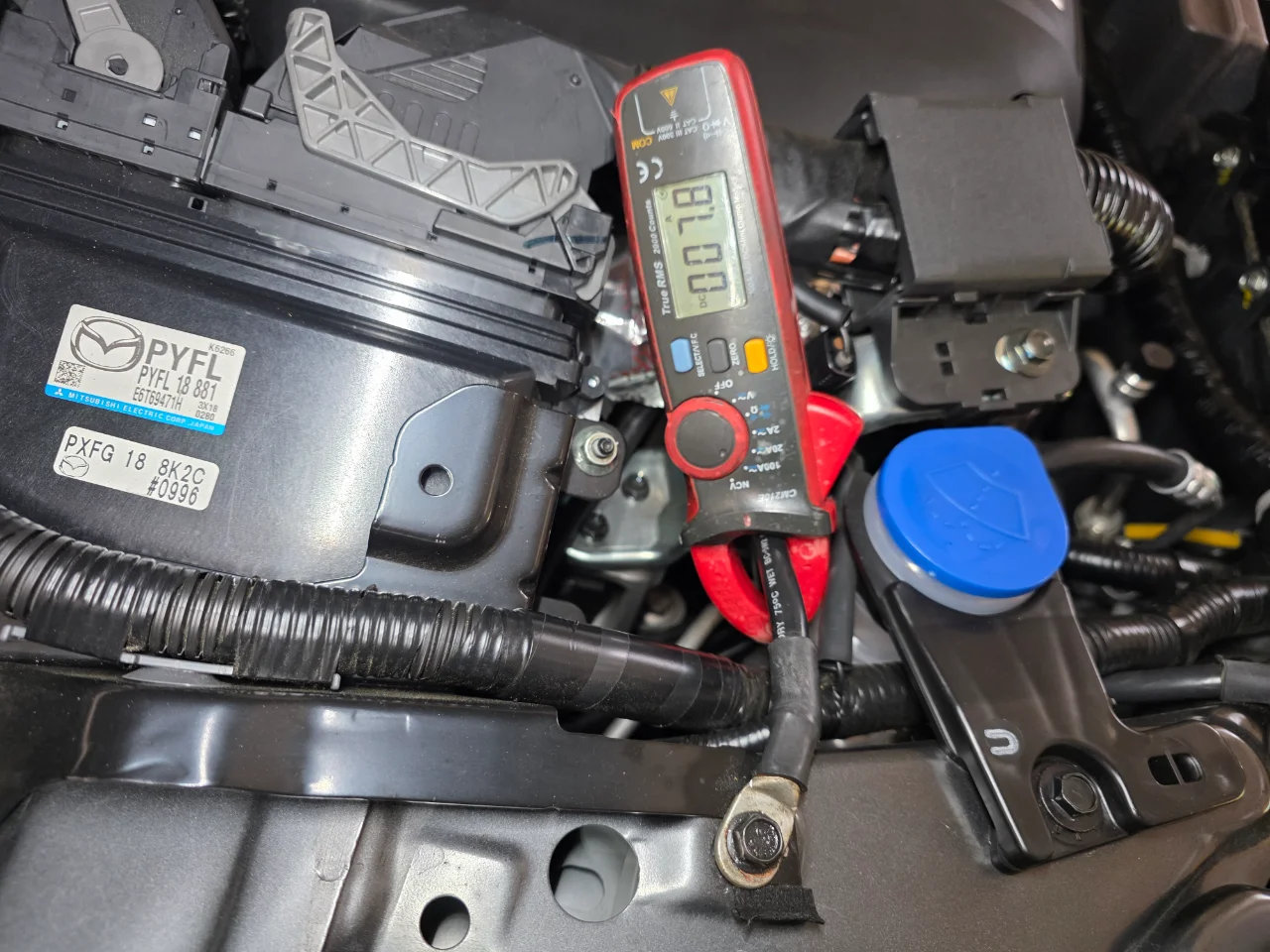

Well my amp meter results were interesting to say the least!
Right head 5 to 6 amps
Left head 7 to 8 amps
Throttle body ZERO
I didn't remove the air intake to measure the transmission. I will check it sometime in the future.

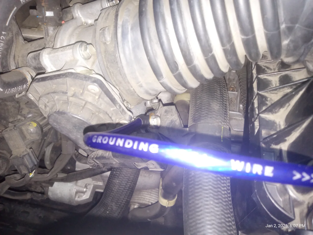

So Mazda did a fine job grounding the TB. Good for them!! I'll do a few more tests on theTB ground in the next few days. For now, let's skip the TB ground.

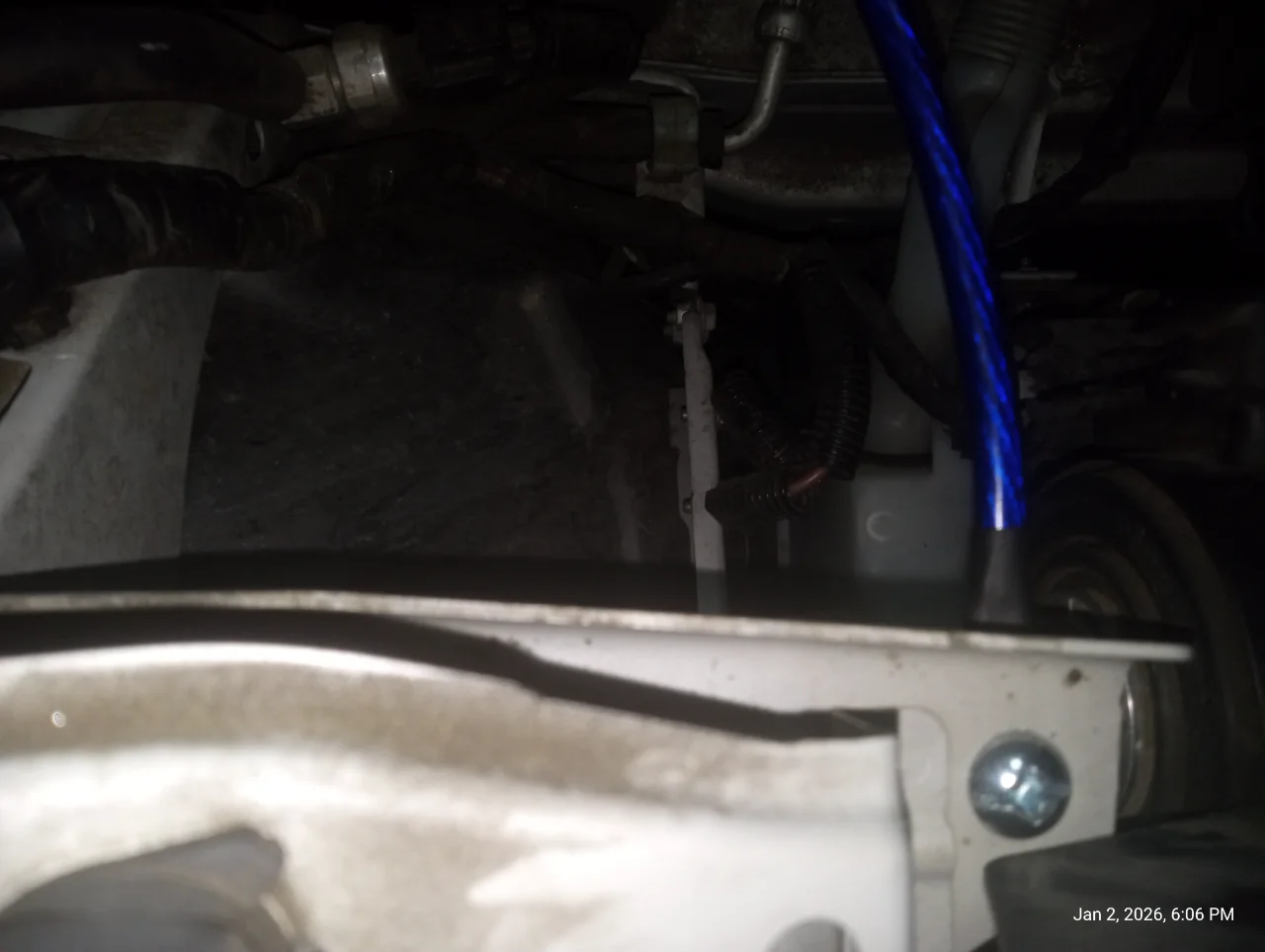

This is the left side ground.
and the throttle body ground.
Something must be wrong here. After all the engine block *IS* already grounded (even if not perfectly). I cannot believe there are 5+amps flowing through these grounds.

More like 8 amps! My meter was jumping from 7 to 8 amps.
Nothing wrong over here. This typical. I've seen from 5 to 10 amps for 15 years.

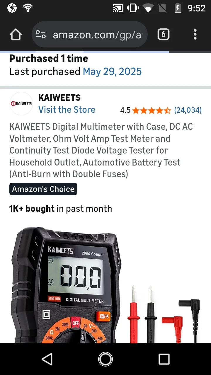

Here is a kit for a Honda. They made it out of high priced parts. My first ground cables were made from audio wire and had the same results. When I made and sold kits, I upgraded the quality to tined marine grade materials. These will last longer than the cars...
Aren't you supposed to check for resistance? Ohms?
I have not put an ohm meter on say the block and body, before and after grounding. I think we would see a difference.
Once I found this quick and simple way of checking, I stayed with it. I'm looking for connection to respond or not. Then I know the ground is working or not.
To my disappointment my throttle body didn't respond. This is good info for the community.
