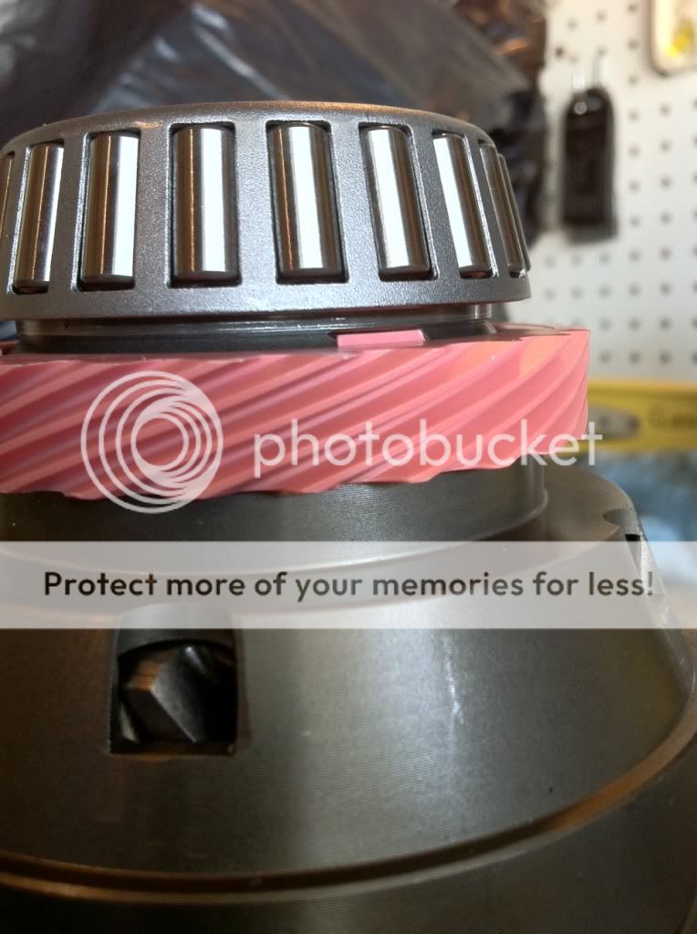

I was using this thread as a reference to install an mfactory LSD (MF-TRS-05G28) in my G35MR (2005 Mazda 3). I know others have as well, so I though I'd share this tidbit of info I found during my install. You don't need to modify the speed gear. Even if you needed to I'd suggest installing the speed gear unmodified, then cutting it down with an exacto knife (the material the gear is made of is quite soft and easy to cut).
Here's a pic of the gear modified and installed on the MFactory unit (there is about 1.5mm of space between where the bearing will seat and the top of the modified speed gear):
Here is a pic of the unmodified speed gear (apologies for the fuzziness):
With the bearing installed:
BTW, if anyones needs a brand new, modified speed gear shoot me a PM (boom01)
That's a different spacing setup than what we have on the 03/03.5 MSP LSD. The MFactory LSD might be okay though...
There's no harm in modifying the speedo ring... it's just going to be turning w/ the diff... a little slop won't matter... though, it is nice to have the piece of mind knowing that it is nice and tight I suppose.
yeah the original lsd from the msp has to have the speedo gear modified in order to sit right.. otherwise it won't be flush.. so the mfactory doesn't need speedogear modified.. and all you need is a file to file down the tab.. takes like 2 mins
