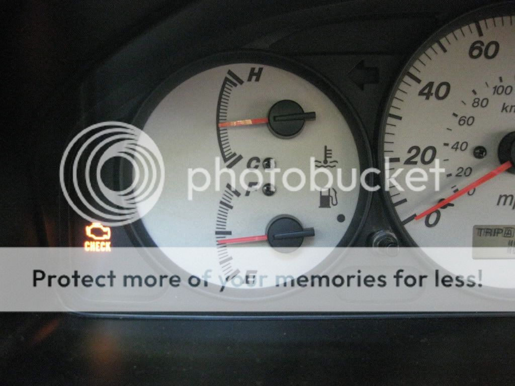

I noticed after the coolant flush on a drive that my engine temp gauge was a tad bit lower, which got me thinking, is my temp gauge too high? These are pics after the coolant flush:
Closer up:
I would say it was 1 or 2 hashes higher before the coolant flush, slightly below middle (I thought that was normal reading for our cars). Bad thermostat? Coolant leaks from hoses? What do you guys think. I might end up getting a compression test just to check that it's not a failing head gasket (Heaven forbid).
Cylinders shouldn't get hot enough to ping unless it's runing lean. Do you have a wide band?
Also that is normal operating temps. If you wana get crazy with it get a 160 fail safe tstat.
Also why is your cel on?

Thanks for reply. Would 160 be "too cold?" I had never thought of it running lean. Someone told me that the MP3 ECU should produce adequate air fuel ratios... Also, I don't know what you mean by "wide band." The CEL is on because I gutted the primary cat and don't have none-foulers on.

For emissions it is. For performance 160-170 is almost perfect the cooler the better. Not to mention this is water temp not oil.
