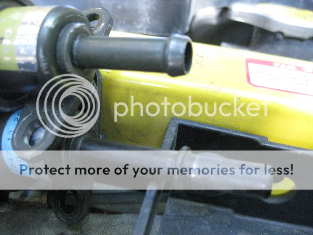

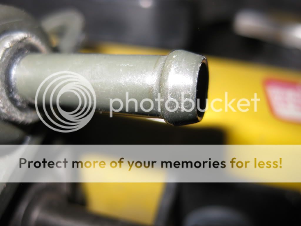

I then checked the FPR I have on FS ZE Intake manifold (I haven't installed it yet), and noticed it had different coloring and part numbers than the FSDE regulator I have on. The ZE regulator neck was shorter and ever-so-slightly larger in diameter than the DE regulator, so when I tried to swap it with the FS DE regulator it wouldn't fit into the attachment-bracket-thing connected to the fuel hoseAnother stopping point. Anyone know How I can make it fit? Can I get a JDM attachment from the dealership? If I get desperate enough I'll Dremel it in...
FS ZE regulator on top:
FS ZE:
FS DE:

Install Protege blue label regulator, yellow regulator from capella FS or familia FS 4WD almost less pressure. I use FS-ZE mani with FS-ZE fuel rail and pro5 regulator in my setup!

Good info Ivan. So does that mean that less pressure would RICHEN my a/f ratio? If so, then I want to use the yellow.
The injectors on my DE and ZE look exactly the same...
Just for clarity, go to this page and scroll down to the FS ZE. My engine looks exactly that (notice the yellow FPR). According to this site it's from a Mazda Familia. There is an FS ZE for sale in the marketplace that has the coils on the valve cover, like the DE. So I'm guessing there were more than one versions of the FS ZE...
