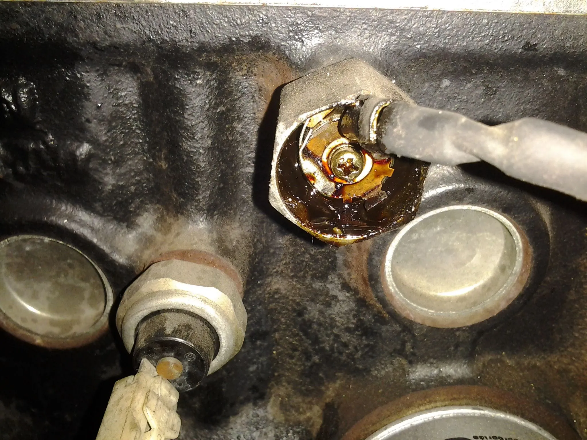

Hey guys,
still trying to narrow this things down. Sort of learned to live with it (avoiding driving behavior that causes pinging as much as possible). But I put on my ZE manifold today finally and found this...
[/URL][/IMG]
I've read that this can be a sign of a failing/failed knock sensor. Is it time for a new knock sensor?
