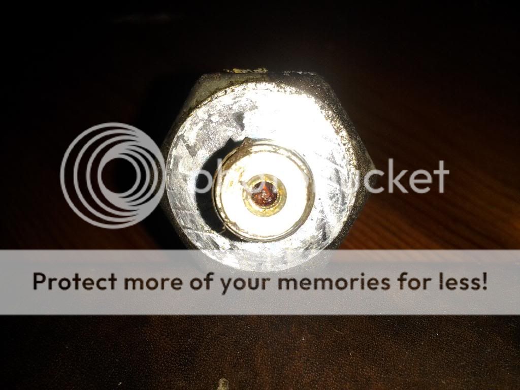

Yeah I know looks bad. I really don't know how the lack of the polymer stuff behind the knock sensor would cause it to malfunction, but then again I don't know too much about knock sensor mechanics...

OK, so I slapped the new knock sensor in. Thought I'd show some pictures of the face of the old knock sensor. As you can see, that brown polymeric material was also on the other side! What could have caused this???
Anyways, the result????
STILL pinging(rlaugh)
It's OK, it seems like I needed to replace that sensor anyways. I think on average it pings less, but to confirm that, I would have to do a "negative control", ie put 100 octane in again and see the difference. Someone in the very beginning of this thread said to check the cam timing. I thought that was kind of absurd, but now it's starting to make more sense. I've actually spun the engine by hand (wrench) with the valve cover off to see if the cam I and E marks line up at some point. They do, but I can't confirm that it's at TDC; I don't have power tools or means to get crank pulley off and mainly back on...

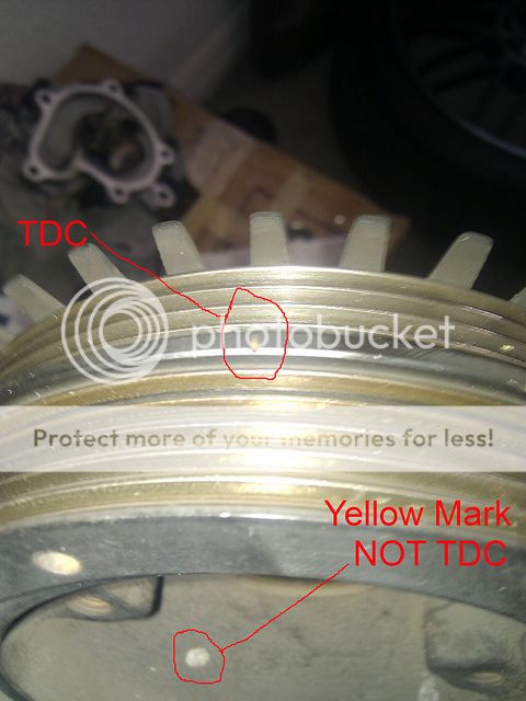

There's timing marks on the plastic cover and crank pulley too. (at least there is on the stock engine)
Yea,.. it's how you check the timing advance with a timing light and the engine running. The plastic cover has the degrees of advance embossed on it near the crank pulley.
