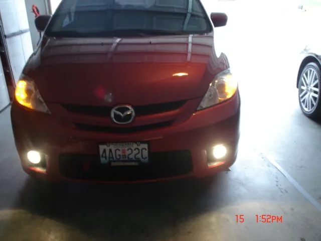

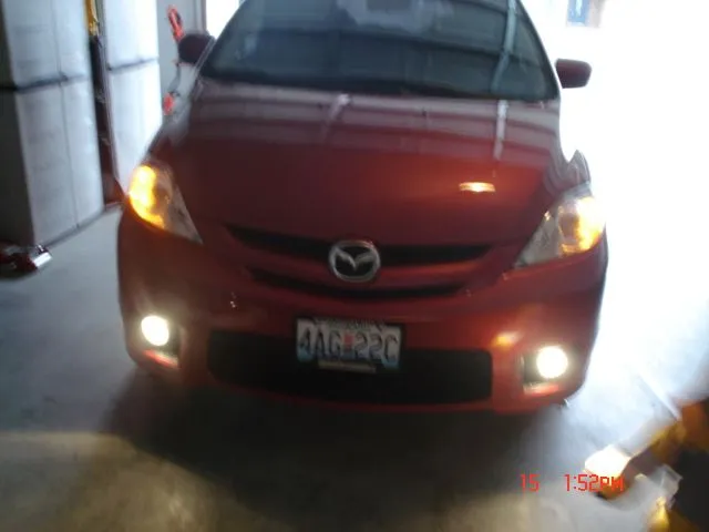

Exactly! The fogs here arent bright at all. Its more a "style" than anything. All of our vehicles are like this with both the Mazdas being the only ones that actually had to get modified. Not that we ride around late evenings with the parking lights and fog lights on.
here is better pics of it where u can tell alot better.
the "HOW TO" is on post #8 all we did was hook the fog light relay up to the tail light relay. so when the tail lights are on u have the option to turn on the fog lights. the switch to the fog lights are still fully functional so u dont have to have the fog lights on at all times if u dont want to.
